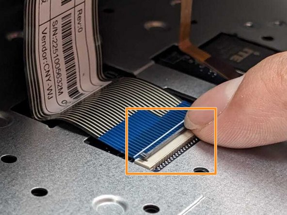

    2. why! NS5xAU Keyboard Replacement, Keyboard 2: step 5, image 1 of 3 why! NS5xAU Keyboard Replacement, Keyboard 2: step 5, image 2 of 3 why! NS5xAU Keyboard Replacement, Keyboard 2: step 5, image 3 of 3
      • Disconnect the cable connectors.
      • Remove the cables and the keyboard.
