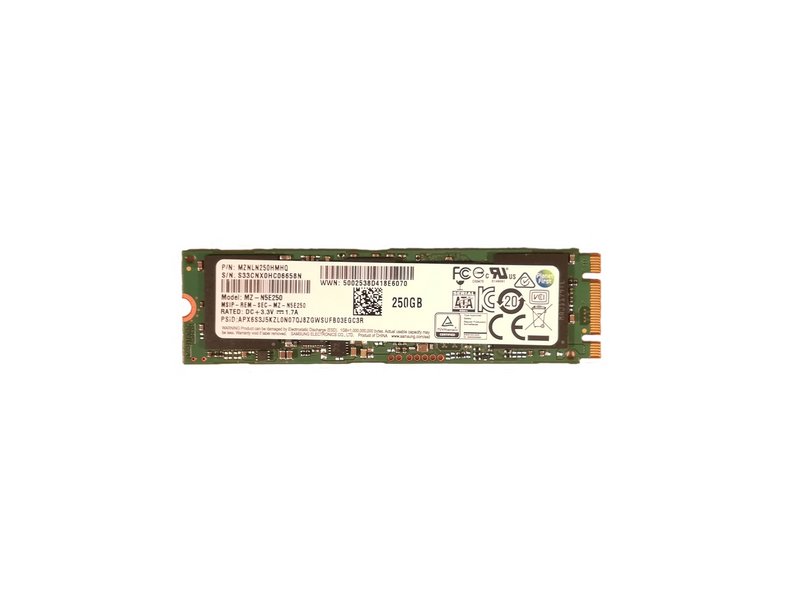

  4. why! N240BU Hard Drive M.2 Replacement, SSD Hard Drive: step 4, image 1 of 3 why! N240BU Hard Drive M.2 Replacement, SSD Hard Drive: step 4, image 2 of 3 why! N240BU Hard Drive M.2 Replacement, SSD Hard Drive: step 4, image 3 of 3
    • Unscrew the screw circled in red
    • Pull out the M.2 SSD in the direction of the red arrows
