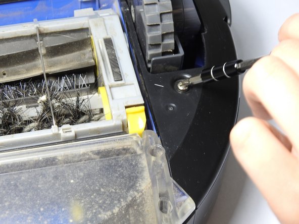

    1. iRobot Roomba 805 Removing Back Cover Replacement, Back Cover (Prerequisite): step 1, image 1 of 2 iRobot Roomba 805 Removing Back Cover Replacement, Back Cover (Prerequisite): step 1, image 2 of 2
      • Unscrew the four 11.7 mm screws with Phillips #1 screwdriver.
      • Remove the top.
