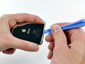

    3. iPod Nano 3rd Generation Logic Board Replacement: step 3, image 1 of 2 iPod Nano 3rd Generation Logic Board Replacement: step 3, image 2 of 2
      Tool used on this step:
      Jimmy
      $7.95
      Buy
      • Opening the iPod can be challenging. Don't get discouraged if it takes you a few tries before the iPod is opened. This may mar the iPod but a tool like the Jimmy will work better if plastic tools do not.
      • Insert the large iPod opening tool into the seam between the front case and rear panel of the iPod, above the dock connector. The tool's edge should point toward the rear panel to prevent any accidental scratching of the anodized aluminum front case.

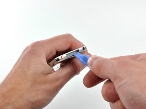

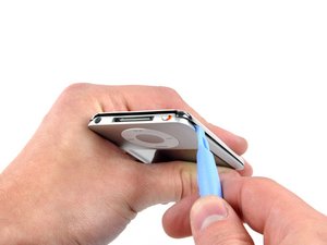

    4. iPod Nano 3rd Generation Logic Board Replacement: step 4, image 1 of 1
      • Insert a small iPod opening tool into the seam on the headphone jack side of the Nano, with the edge of the tool pointing toward the rear panel.
      • Gently enlarge the existing gap by pressing/wiggling the small iPod opening tool into the gap near each of the the two tabs attached to the rear case, pushing the clips toward the center of the Nano until both have been freed.

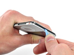

    5. iPod Nano 3rd Generation Logic Board Replacement: step 5, image 1 of 2 iPod Nano 3rd Generation Logic Board Replacement: step 5, image 2 of 2
      • The large iPod opening tool is no longer needed to gain access to the left side of the iPod.
      • Repeat the same procedure listed in the previous step to free the three clips along the hold switch side of the Nano.

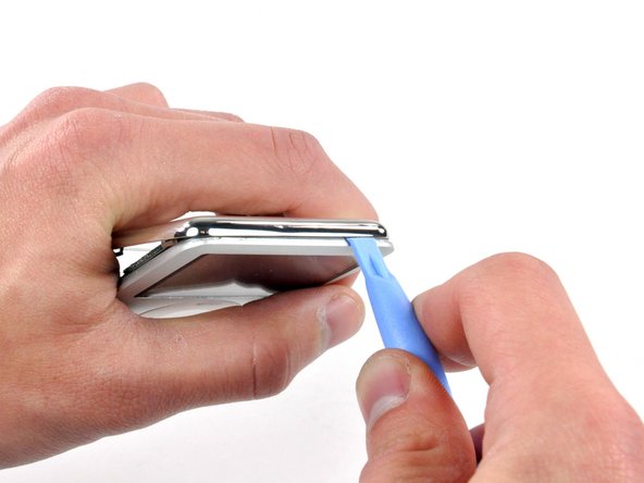

    6. iPod Nano 3rd Generation Logic Board Replacement: step 6, image 1 of 1
      • Insert an iPod opening tool into the gap near the top left corner of the Nano and work to free the three clips along the top edge of the rear panel.
      • After ensuring all tabs are free, separate the two halves of the iPod.
      • The rear panel is now free from the iPod.

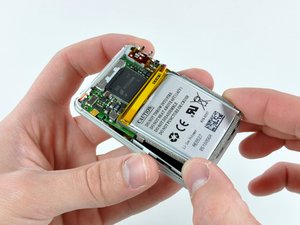

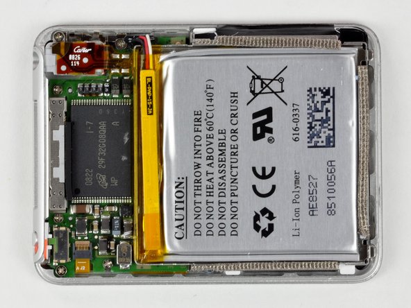

    1. iPod Nano 3rd Generation Logic Board Replacement, Logic Board: step 7, image 1 of 1
      • With the rear case removed, the back side of your Nano should now look like this.

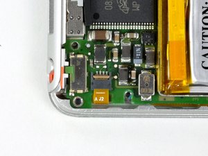

    2. iPod Nano 3rd Generation Logic Board Replacement: step 8, image 1 of 1
      • Remove the following six screws:
      • One 1.8 mm Phillips.
      • Three 1.9 mm Phillips.
      • One 2.4 mm Phillips.
      • One 2.6 mm Phillips.

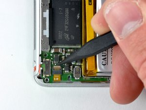

    3. iPod Nano 3rd Generation Logic Board Replacement: step 9, image 1 of 2 iPod Nano 3rd Generation Logic Board Replacement: step 9, image 2 of 2
      • Using a spudger, flip up the brown click wheel ribbon cable retaining clip.
      • The clip is hinged at the end nearest the edge of the case.

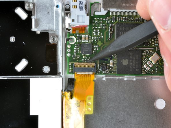

    6. iPod Nano 3rd Generation Logic Board Replacement: step 12, image 1 of 1
      • Use a spudger to flip up the display ribbon cable retaining clip.
      • The retaining clip is hinged about the end nearest the battery.
      Ask FixBot

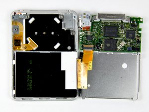

    7. iPod Nano 3rd Generation Logic Board Replacement: step 13, image 1 of 1
      • Slide the display ribbon cable out of its socket.
      • The logic board is now completely disconnected from the front case.
