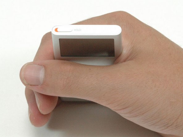

    1. iPod Nano 2nd Generation Battery Replacement, Case Assembly: step 1, image 1 of 1
      • Before opening your iPod, ensure that the hold switch is in the locked position.

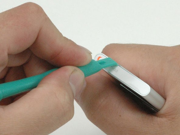

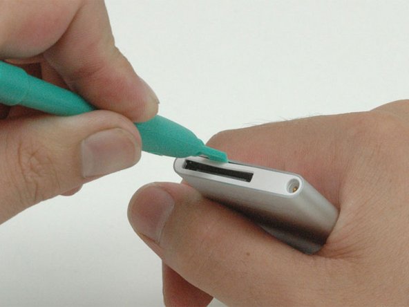

    2. iPod Nano 2nd Generation Battery Replacement: step 2, image 1 of 1
      • Carefully insert an iPod opening tool in the seam between the metal casing and white plastic top.
      • Lift the top bezel off the iPod. It's glued on using a mild adhesive, so some force may be required.

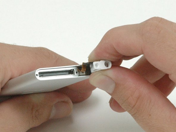

    3. iPod Nano 2nd Generation Battery Replacement: step 3, image 1 of 1
      • When removing the bottom bezel, be sure not to bend the plastic surrounding the dock connector.
      • Carefully insert an iPod opening tool in the seam between the metal casing and white plastic bezel.
      • Lift the bottom bezel off the iPod. It's glued on using a mild adhesive, so some force may be required.

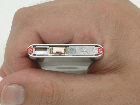

    4. iPod Nano 2nd Generation Battery Replacement: step 4, image 1 of 1
      • Remove the following two screws:
      • One #00 Phillips screw with a large head near the headphone jack.
      • One #000 Phillips screw with a smaller head near the side of the iPod. This screw strips easily, so be sure to press down firmly on the screwdriver.

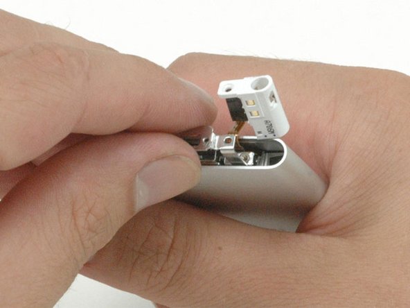

      • Use a metal spudger to carefully pry the headphone jack out of the casing. DO NOT remove the headphone jack from the iPod entirely, as it is connected via a fragile ribbon connector to the click wheel.
      Ask FixBot
    6. iPod Nano 2nd Generation Battery Replacement: step 6, image 1 of 1
      • Slide the headphone jack out until the white plastic housing is no longer held in place by the metal casing.
      Ask FixBot

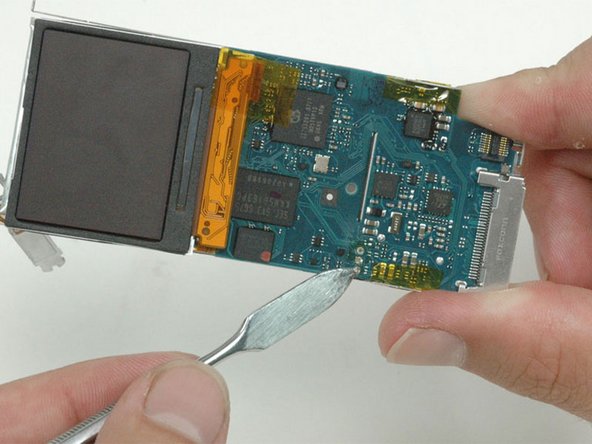

    1. iPod Nano 2nd Generation Battery Replacement, Battery: step 15, image 1 of 1
      • Use a spudger to scrape away the black glue covering the three battery wires.
      Ask FixBot

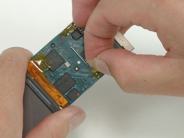

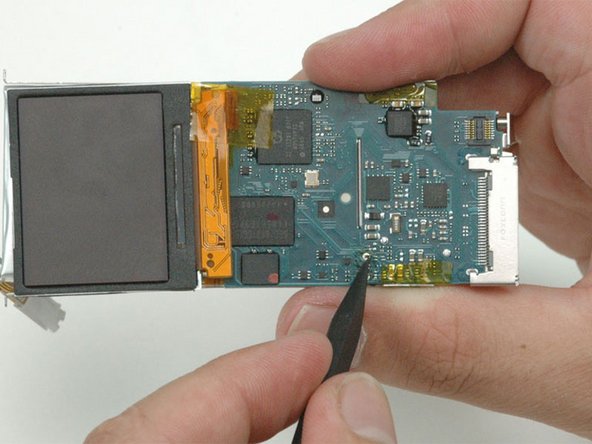

    2. iPod Nano 2nd Generation Battery Replacement: step 16, image 1 of 1
      • Peel up the orange tape covering the three solder points on the other side of the logic board.
      Ask FixBot

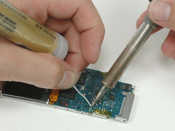

    3. iPod Nano 2nd Generation Battery Replacement: step 17, image 1 of 1
      Tool used on this step:
      FixHub Smart Soldering Iron
      $79.95
      Buy
      • Place the desoldering wick on top of the existing solder ball.
      • Place the soldering iron on top of wick above the existing solder ball.
      • Hold the soldering iron in place until the solder melts into the wick.
      • Repeat the same procedure on the remaining two connectors.

    4. iPod Nano 2nd Generation Battery Replacement: step 18, image 1 of 1
      • Be careful not to scrape the metal rings surrounding the connectors off the logic board. If you accidentally scrape these off, you won't be able to reconnect the replacement battery.
      • Use a metal spudger to carefully straighten the battery wires. Be sure to only touch one contact at a time.
      Ask FixBot

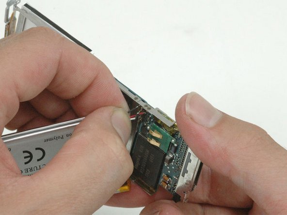

      • Pull the battery wires through the logic board to free the battery. If the wires don't easily come free, make sure the wires are straight and all the solder has been removed.
      • Slide the three wires of the replacement battery through the holes in the logic board. Going from the edge of the iPod, the order of wires is black at the far right (close to the metal frame), red in the middle, and white to the far left.
      Ask FixBot
