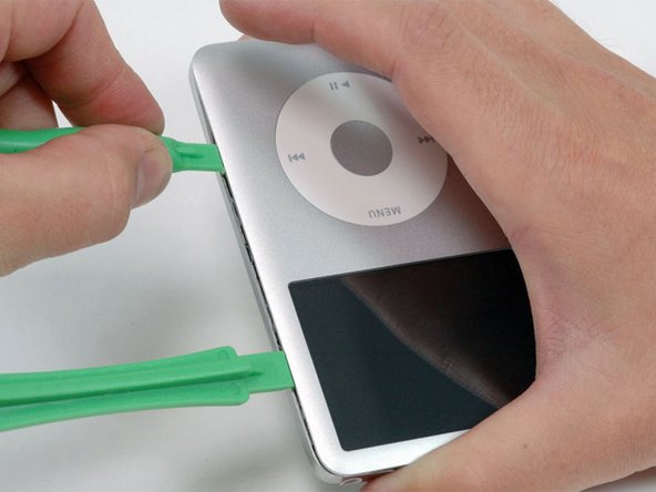

    2. iPod Classic Hard Drive Replacement: step 2, image 1 of 1
      • Opening this iPod is challenging. Don't get discouraged if it takes you a few tries before the iPod is opened. One thing to notice is the angle of the plastic opening tool's tip while inserting it into the iPod. Ideally, the angle should be as vertical as possible while still clearing the edge of the rear panel.
      • Insert a plastic opening tool into the seam between the front and back of the iPod.

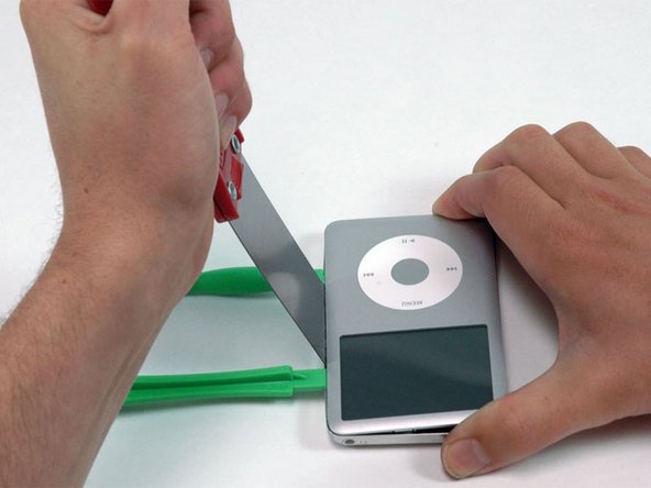

    4. iPod Classic Hard Drive Replacement: step 4, image 1 of 1
      • At an angle, carefully insert a putty knife about 1/8 inch into the seam between the two opening tools.
      • There are thin metal rails running along the inside of the rear panel, so take great care when inserting the putty knife.
      • Once the putty knife has cleared the lip of the rear panel, pivot the putty knife so that it is vertical, and carefully (but firmly) wiggle it straight down into the gap between the opening tools.
      Ask FixBot

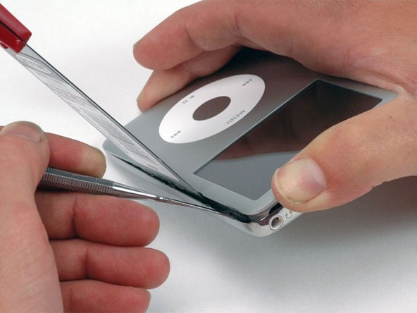

    8. iPod Classic Hard Drive Replacement: step 8, image 1 of 1
      • Near the center of the display, carefully insert a metal spudger into the gap created by the plastic opening tool.
      • It is easy to create a noticeable bump in the rear panel here that is difficult to repair. When prying the tab free, try to have the metal spudger pivot on the edge of the rear panel rather than bending the rear panel outward.
      • Using the metal spudger, disengage the single clip on the top of the iPod.

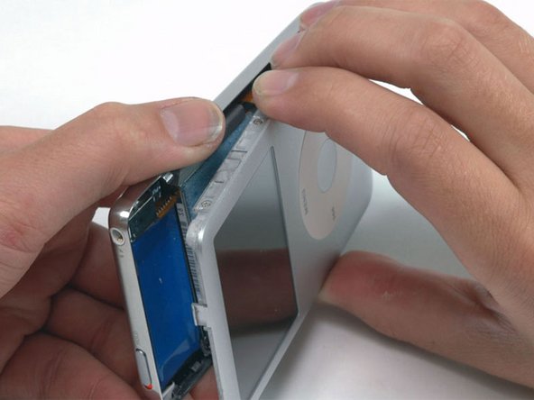

    16. iPod Classic Hard Drive Replacement: step 16, image 1 of 1
      • Continue to push up on the front panel with the metal spudger until the metal clip releases.
      Ask FixBot

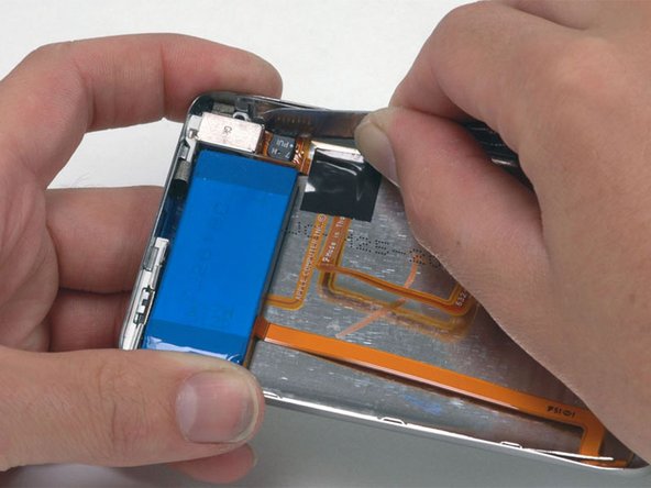

    18. iPod Classic Hard Drive Replacement: step 18, image 1 of 1
      • Use a spudger to slide up the connector holding the orange battery ribbon in place. You only need to lift the locking bar up about 2 mm to free the cable.
      • Slide the orange battery ribbon out of its connector.
      Ask FixBot

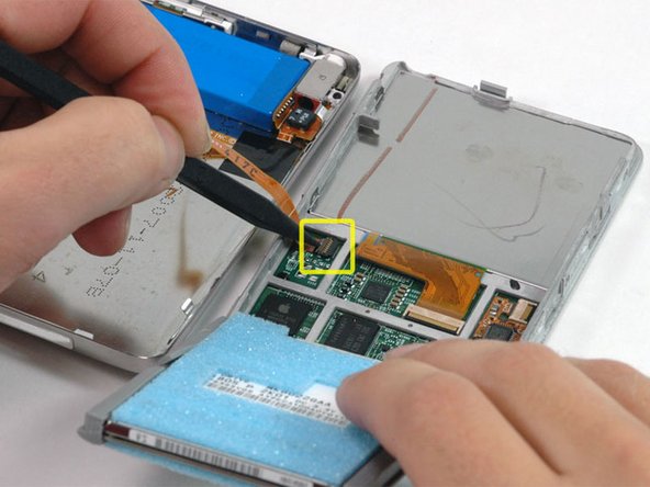

    20. iPod Classic Hard Drive Replacement: step 20, image 1 of 1
      • Lift the hard drive up with one hand so you can access the headphone jack ribbon beneath.
      • Use a spudger to flip up the plastic tab holding the headphone jack ribbon in place. The tab will rotate up 90 degrees, releasing the ribbon cable.
      • Slide the orange headphone jack ribbon out of its connector.
      • The rear panel is now free from the iPod.
      Ask FixBot
