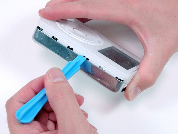

    2. iPod 1st Generation Battery Replacement: step 2, image 1 of 1
      • Opening the iPod can be challenging; don't get discouraged if it takes you a few tries to get the iPod to open.
      • Insert a plastic iPod opening tool in the seam between the white plastic front and metal back of the iPod. It helps to hold the iPod at top and bottom as shown and squeeze to help pop out the edge. Once you've inserted the tool, run it along the seam to free the five tabs holding the iPod together.
      Ask FixBot
    3. iPod 1st Generation Battery Replacement: step 3, image 1 of 1
      • Continue to run the opening tool along the side of the case until all five tabs have been released.
      Ask FixBot
    4. iPod 1st Generation Battery Replacement: step 4, image 1 of 1
      • Work around the corner of the iPod and release the two tabs holding the iPod together near the dock connector.
      Ask FixBot
    5. iPod 1st Generation Battery Replacement: step 5, image 1 of 1
      • Free the five tabs holding the iPod together on the other side. You may be able to free the tabs by gently wiggling the front panel of the iPod.
      • Lift the rear panel away from the iPod.

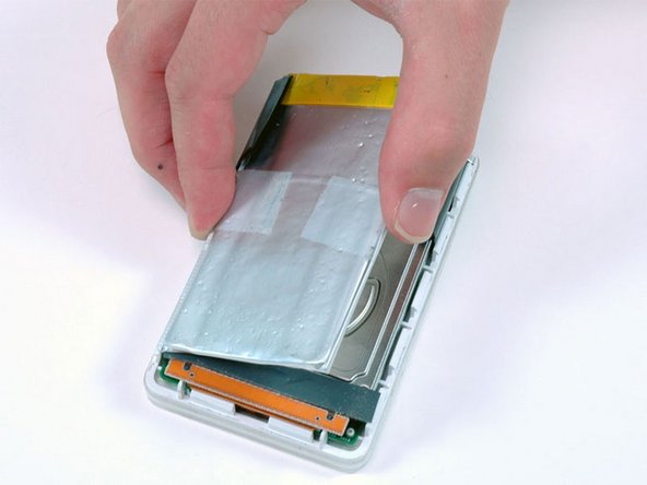

    1. iPod 1st Generation Battery Replacement, Battery: step 6, image 1 of 1
      • Lift the battery up from the adhesive holding it to the iPod.
      • Lay the battery next to the iPod (it is still connected to the logic board).
      Ask FixBot
    2. iPod 1st Generation Battery Replacement: step 7, image 1 of 1
      • Lift up the end of the hard drive near the Firewire port to allow easy access to the battery connector.
      Ask FixBot

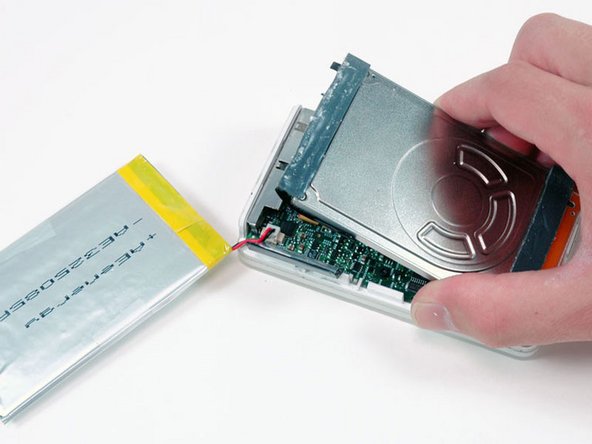

    3. iPod 1st Generation Battery Replacement: step 8, image 1 of 1
      • Carefully disconnect the white battery connector from the logic board. Be sure to pull only on the connector itself and not on the cables.
