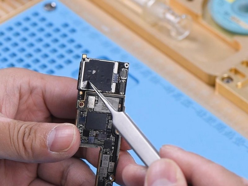

    1. iPhone X SIM Card Reader Replacement, SIM Card Reader: step 1, image 1 of 3 iPhone X SIM Card Reader Replacement, SIM Card Reader: step 1, image 2 of 3 iPhone X SIM Card Reader Replacement, SIM Card Reader: step 1, image 3 of 3
      • The SIM card reader of the iPhone X is soldered with medium-temperature tin, while the middle layer of the motherboard adopts low-temperature tin. Hence we advise you to separate the motherboard before removing the SIM card reader.
      • There are other ICs on the SIM card reader.
      • Besides, a plastic part is also in the middle of the SIM card reader.

    2. iPhone X SIM Card Reader Replacement: step 2, image 1 of 2 iPhone X SIM Card Reader Replacement: step 2, image 2 of 2
      • While disassembling and soldering, we need to heat it with rotational air and control the temperature. Attach the motherboard to the PCB Holder. Heat it with a Hot Air Gun at 240℃ and airflow 7. Tear off the sticker on the back of the motherboard.
      • Put the motherboard on the Heating Platform. We only need to heat the SIM card reader part. Fix the motherboard with high-temperature adhesive. Set the temperature of the Heating Platform to 200℃. Heat the edge of the SIM card reader with Hot Air Gun 280℃ and airflow 7.
