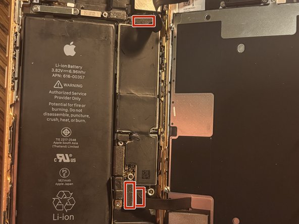

  7. iPhone 8 Speaker Replacement: step 7, image 1 of 2 iPhone 8 Speaker Replacement: step 7, image 2 of 2
    • Disconnect the marked flex cables, then push the sim pin ejector into the frame. Now remove the 3 screws holding the speaker in place. Lift the speaker up and remove it as shown in picture 2.
