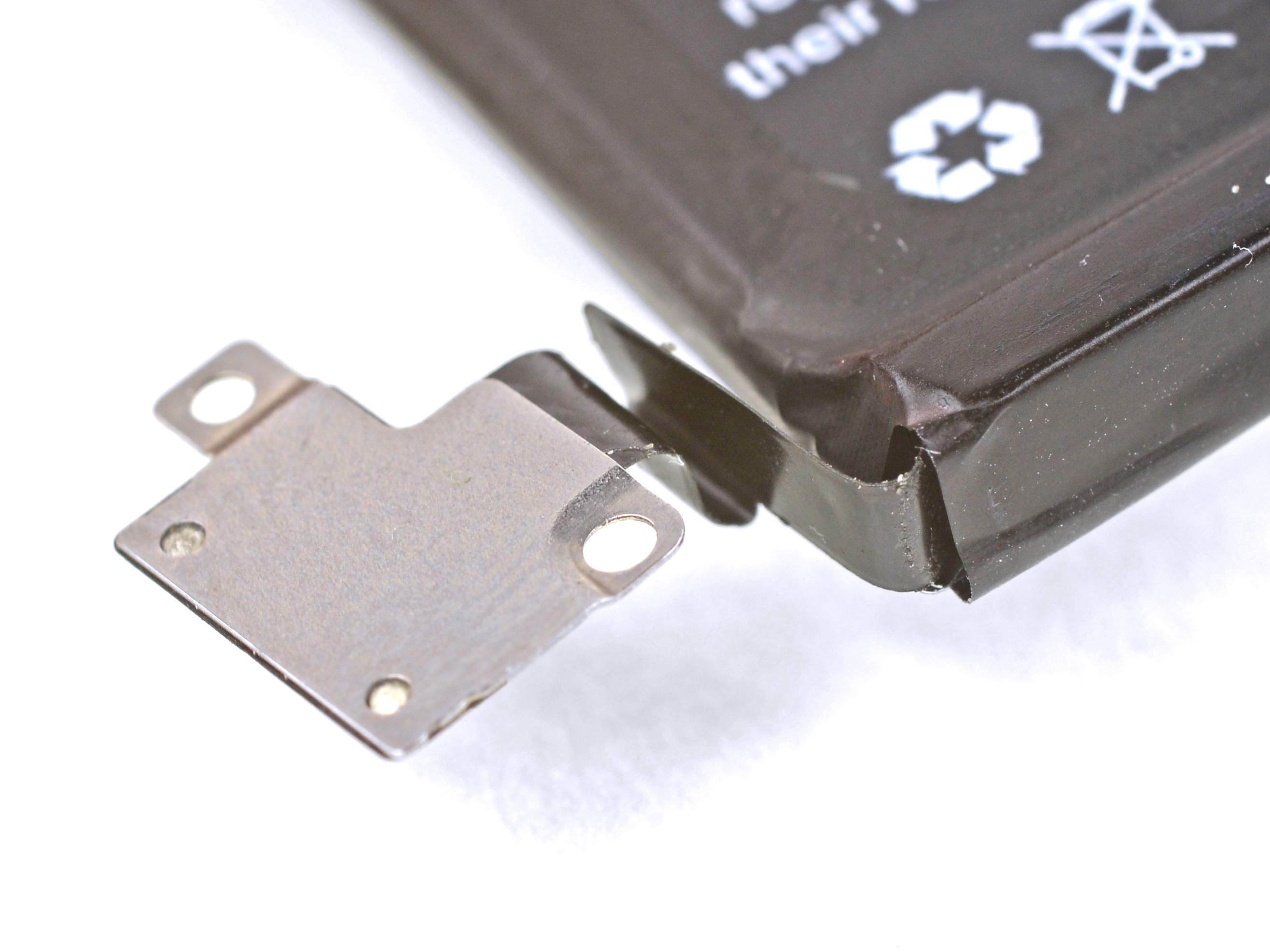

    2. iPhone 4S Power Button Replacement: step 5, image 1 of 3 iPhone 4S Power Button Replacement: step 5, image 2 of 3 iPhone 4S Power Button Replacement: step 5, image 3 of 3
      • Carefully push the pressure contact away from the battery connector until it slides free from its position.
      • Remove the pressure contact.
      Ask FixBot
