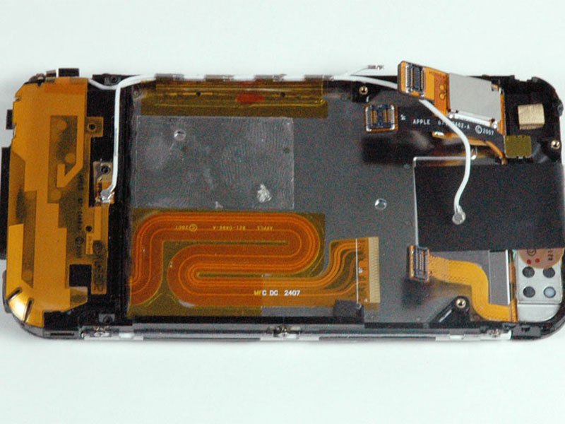

    16. iPhone 1st Generation Display Assembly Replacement: step 30, image 1 of 1
      • Lift the front bezel away from the iPhone.
      Ask FixBot
    17. iPhone 1st Generation Display Assembly Replacement: step 31, image 1 of 1
      • Display assembly remains.
      Ask FixBot
