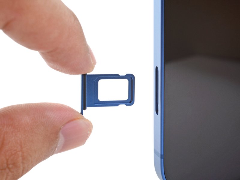

    1. iPhone 13 SIM Card Tray Replacement, Eject the SIM card tray: step 1, image 1 of 2 iPhone 13 SIM Card Tray Replacement, Eject the SIM card tray: step 1, image 2 of 2
      • Insert a SIM card eject tool or a paperclip into the small hole in the SIM card tray, located on the volume button edge of the iPhone.
      • Press firmly to eject the tray.
      Ask FixBot
    2. iPhone 13 SIM Card Tray Replacement, Remove the SIM card tray: step 2, image 1 of 3 iPhone 13 SIM Card Tray Replacement, Remove the SIM card tray: step 2, image 2 of 3 iPhone 13 SIM Card Tray Replacement, Remove the SIM card tray: step 2, image 3 of 3
      • Remove the SIM card tray from the iPhone.
      • The SIM card will fall out of the tray easily.
      • When reinserting the SIM card, make sure it's in the proper orientation inside the tray.
      • A thin rubber gasket around the SIM tray provides water and dust protection. If this gasket is damaged or missing, replace the gasket or the entire SIM tray to protect your iPhone's internal components.
