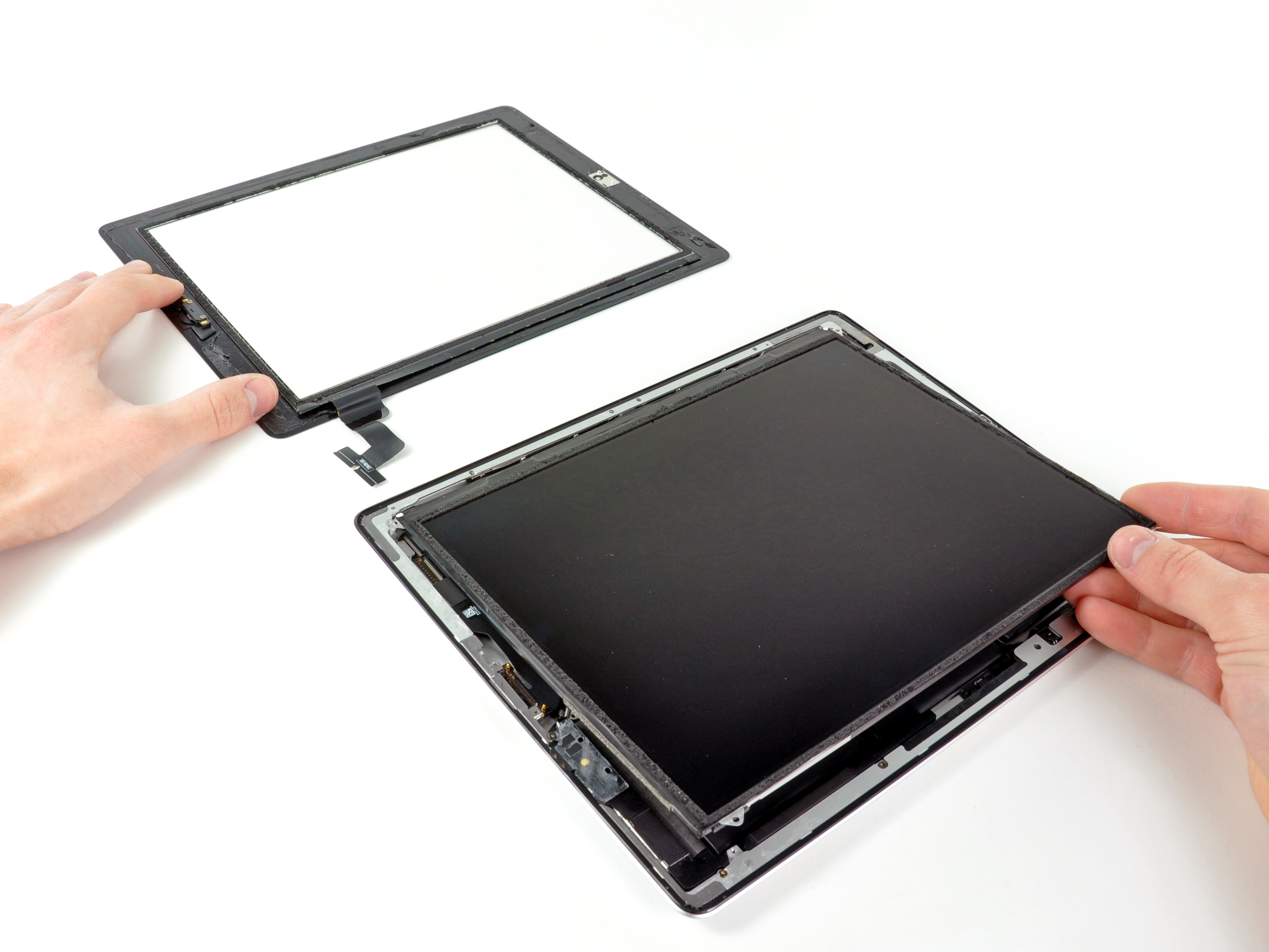

Use the edge of a plastic opening tool to carefully flip up the retaining flaps on the two digitizer ribbon cable ZIF sockets.
Lift the LCD from its long edge farthest from the digitizer cable and gently flip it toward the rear case—like closing a book.
While holding the LCD up, gently slide the front panel away from the iPad. Be careful not to snag the digitizer cable on the rear case or LCD.
Set the LCD back into the body for safekeeping.
To reassemble your device, follow these directions in reverse.
