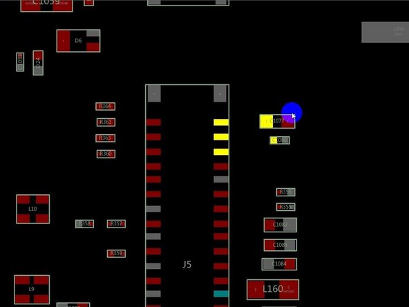

      • Then we measure the resistance values of the touch connector. The resistance values of pin 2, pin 4, and pin 6 are found to be too large. According to the diagram, the normal value should be around 144.
      • Open the circuit diagram. The three pins are connected to the chip through one inductor.
      • Measure the resistance value of circuit connecting the inductor to the chip. The value is normal.

      • Then measure the resistance value of another end connecting the inductor to the touch connector. The value is abnormal.
      • Therefore, it can be judged that the inductor is damaged.
      • A damaged inductor is generally caused by improper operation that involves installing the display while the battery is connected to the motherboard. So we must disconnect the battery firstly when we install the display.
