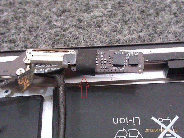

    • Some models have a small GSM flex cable (Shown in the 1st picture, circled in red). There is a piece of tape covering it and will need to be removed. Then underneath the tape, there is a small tab, which is closest to the LCD screen. Lift gently on this tab with a smudger tool. In a later step, the flex cable will be removed from the board.

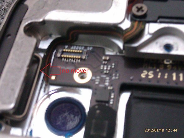

    • Remove the screws from the metal plate on the power button, and gently detach the connector where indicated. During the removal, the metal cover and the rear facing camera may come out together.

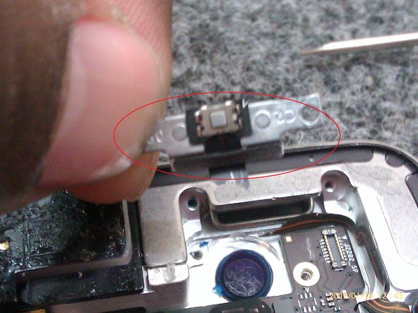

    • You now can access the power button.
    • Remove the 2 screws that secure the metal bracket and then carefully remove the metal bracket with the power button on the ribbon cable.
    • Note: As shown in the 3rd picture, It is important that the clip connected to the external plastic power button does not get removed completely. It is tricky to put this plastic button back into the hole.

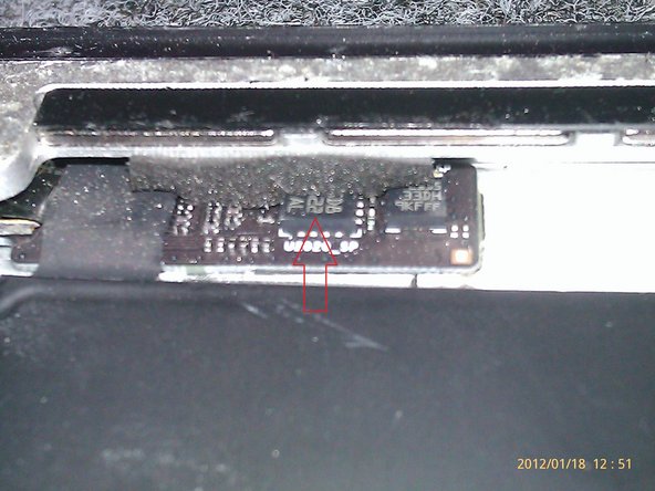

    • Before removing the board, be very careful because the board is glued to the rear chassis. Use a spluger at the points indicated by the arrow to loosen the adhesive connecting the board to the chassis.
    • Once the board is free of the chassis, then carefully remove the tape as pointed to by the arrow. There will be a connector to be removed from the board with a spluger.
