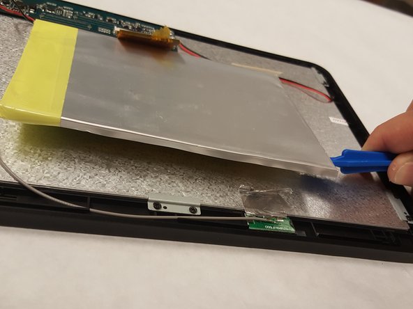

    4. iNet M1001 Battery Replacement: step 6, image 1 of 3 iNet M1001 Battery Replacement: step 6, image 2 of 3 iNet M1001 Battery Replacement: step 6, image 3 of 3
      • Pry off the battery with a plastic opening tool.
