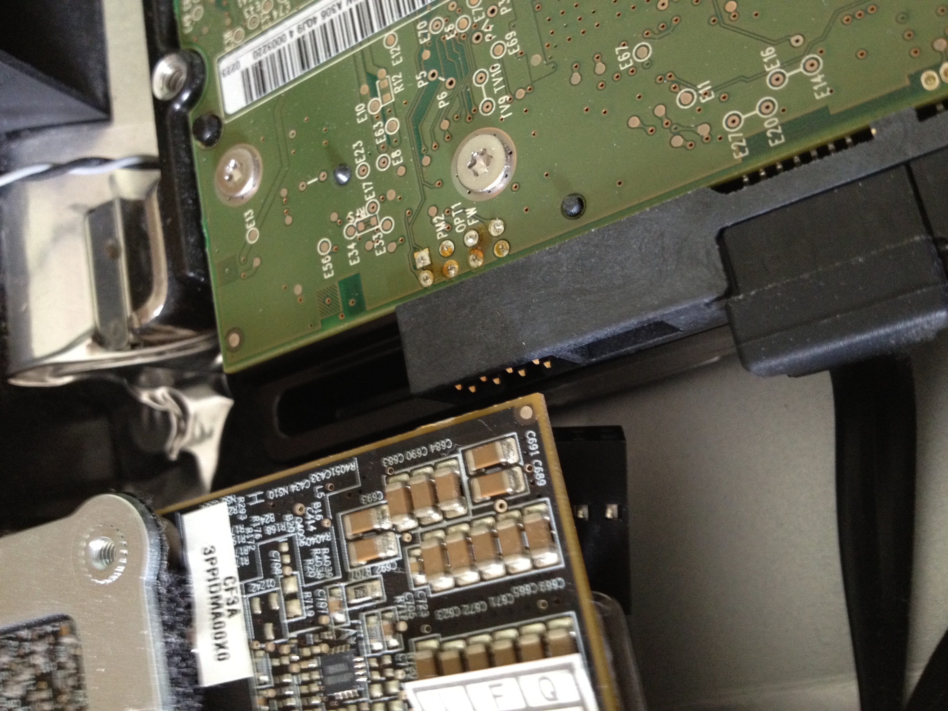

You need to remove the temperature sensor cable from the HDD to remove the card
Remember the position of this cable! ifixit tip: it must later be reinstalled closest to the SATA connector and the black cable need to point up, towards the LCD

Carefully remove the graphics card temperature sensor cable from underneath the motherboard
Remember the position as you need to plugin the new one here as well

Reinsert the temperatur sensor cable. You need fine hands or a good tool to do so. Be patient with this step

The hardest step is reinstalling the temp sensor connection under the main processor board. Almost impossible but got it with extreme patience.
Nick Martello - Reply

Connecting the heat sensor of the video card is a pain. And after the install in iStat the GPU die temp does not show up. however since i am controlling the fans manually I am not to worried (i still have GPU heatsink info and all the other temped indicators)

Had to do this on a 2010 i5, not enough room otherwise!
- removed 2x3mm piece on the left corner of the gap
- made the gap 4-5mm deeper
jes ta - Reply
