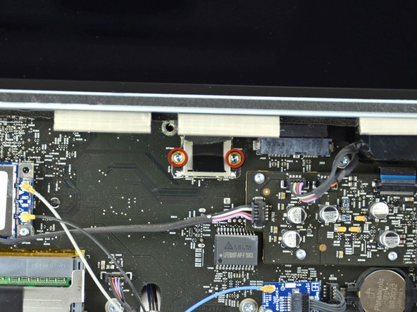

      • Remove the two 5.3 mm T6 torx screws from the LCD connector.
      • Firmly grasp the pull tab on top of the connector and pull it straight up out of its port.
      • Make sure that you are pulling the tab and not the connector cable.

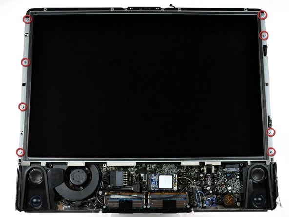

      • Remove the eight T8 Torx screws securing the display panel to the rear case.
      • The iMac shown is a 20" model, but the screw locations should be approximately correct.

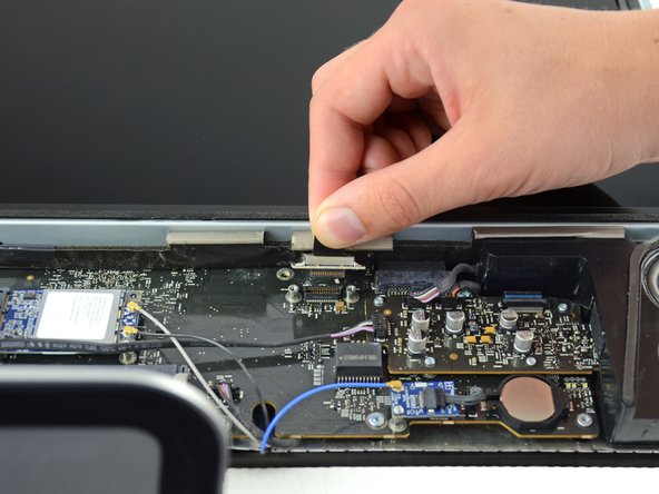

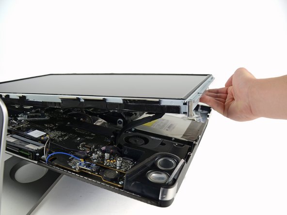

    3. iMac Intel 24" EMC 2267 Hard Drive Replacement: step 9, image 1 of 3 iMac Intel 24" EMC 2267 Hard Drive Replacement: step 9, image 2 of 3 iMac Intel 24" EMC 2267 Hard Drive Replacement: step 9, image 3 of 3

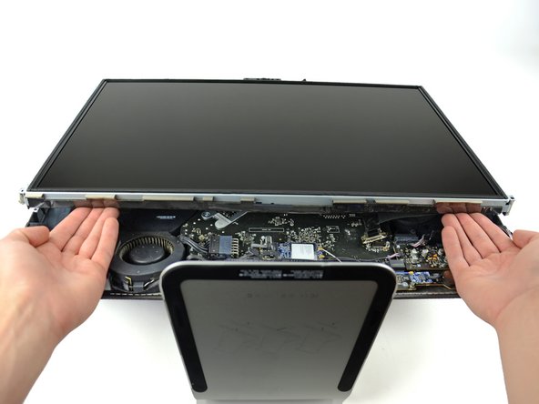

      • Place your hands on either side of the bottom of the display panel, and lift it up enough that you can reach the connectors inside.
      • Do not try to remove the display panel completely as it is still connected to the rest of the device.
      • While holding the display panel up with one hand, locate and remove the display thermal sensor cable from its connector.

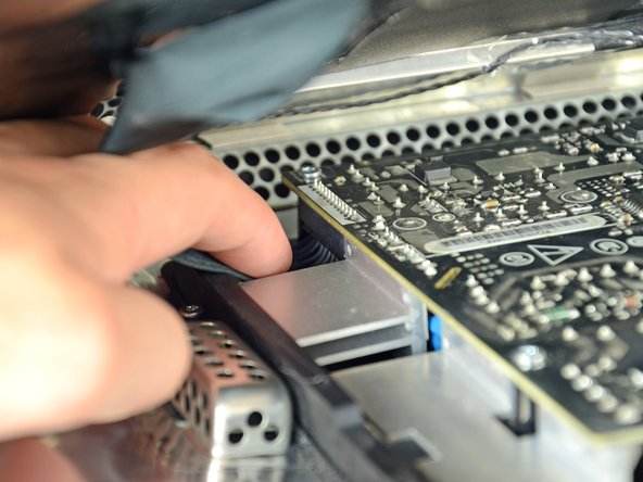

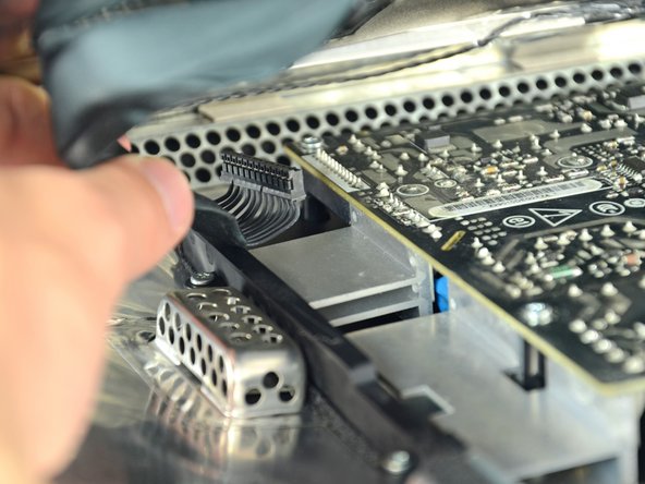

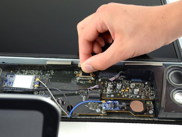

    4. iMac Intel 24" EMC 2267 Hard Drive Replacement: step 10, image 1 of 2 iMac Intel 24" EMC 2267 Hard Drive Replacement: step 10, image 2 of 2
      • While still holding the display panel up, use two fingers to firmly push down on the power supply cable connector from its socket.
      • Be very careful not to touch the exposed face of the power supply to avoid electric shock from the many large capacitors attached to the other side of the board.
      Ask FixBot

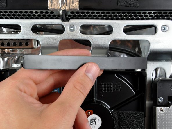

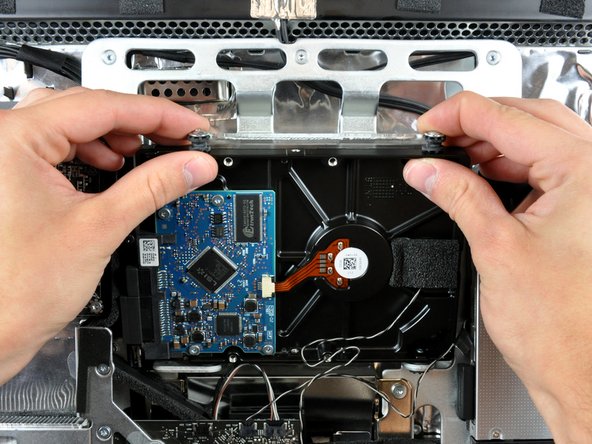

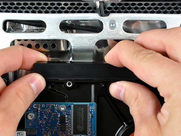

    1. iMac Intel 24" EMC 2267 Hard Drive Replacement, Hard Drive: step 12, image 1 of 3 iMac Intel 24" EMC 2267 Hard Drive Replacement, Hard Drive: step 12, image 2 of 3 iMac Intel 24" EMC 2267 Hard Drive Replacement, Hard Drive: step 12, image 3 of 3
      • To remove the hard drive bracket, squeeze the middle against the side of the hard drive while rotating the top left edge toward yourself.
      • After the left edge has been freed, rotate the bracket toward the right edge of the hard drive.
      • Lift the hard drive bracket straight up off the chassis.

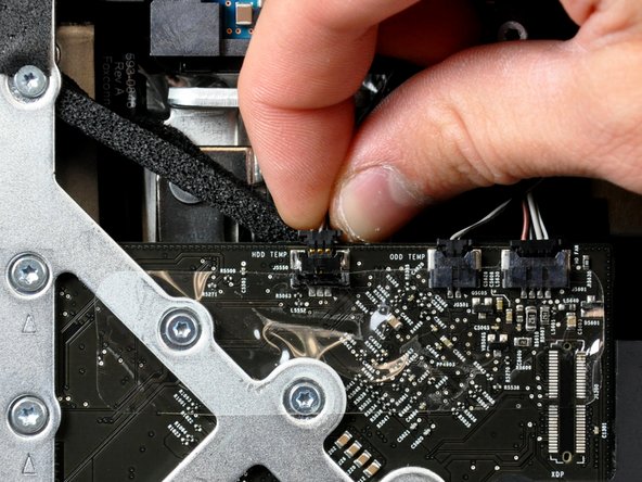

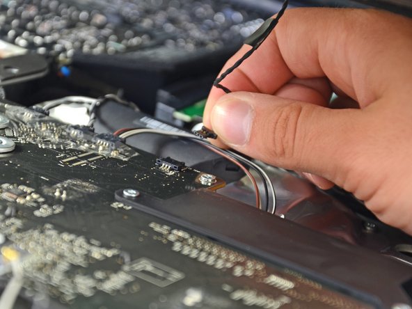

    3. iMac Intel 24" EMC 2267 Hard Drive Replacement: step 14, image 1 of 1

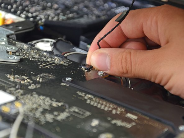

      • Pull the hard drive temperature sensor cable straight away from its socket on the logic board.
      • When removing this connector, it is helpful use your thumbnails to push the ears on either side of the connector toward the top of your iMac.
      Ask FixBot

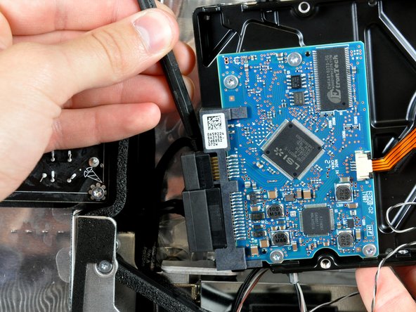

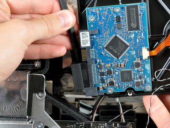

    5. iMac Intel 24" EMC 2267 Hard Drive Replacement: step 16, image 1 of 2 iMac Intel 24" EMC 2267 Hard Drive Replacement: step 16, image 2 of 2
      • Insert the flat end of a spudger between the SATA data cable and the edge of the hard drive.
      • Twist the spudger to separate the SATA data cable from the hard drive.
      • Disconnect the SATA data cable from the hard drive.
      • Repeat this process for the SATA power cable.
      • Lift the hard drive out of your iMac, minding the thermal sensor cable that may get caught.

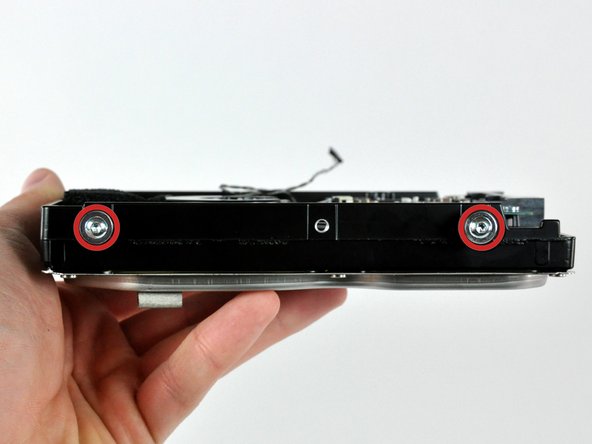

    1. iMac Intel 24" EMC 2267 Hard Drive Replacement, Hard Drive: step 17, image 1 of 1
      • Remove the two T8 Torx screws and their attached rubber grommets from the hard drive.

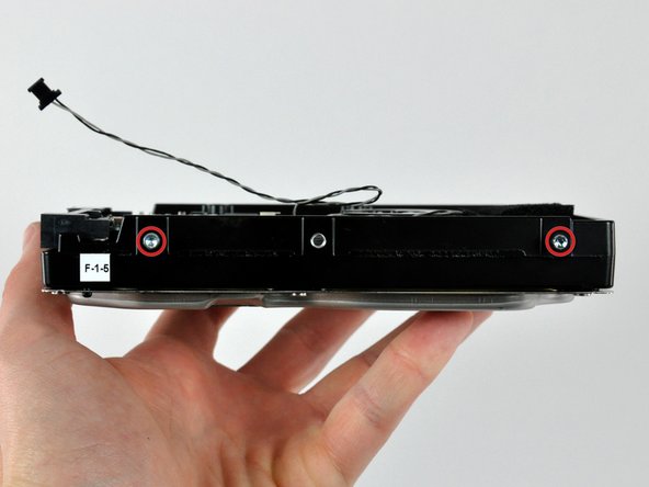

    2. iMac Intel 24" EMC 2267 Hard Drive Replacement: step 18, image 1 of 1
      • Remove the two T8 Torx pins from the side of the hard drive nearest the power and data connectors.
      Ask FixBot

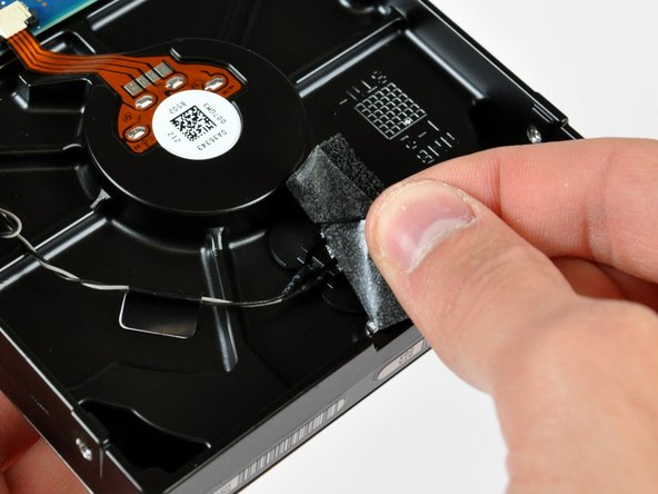

    3. iMac Intel 24" EMC 2267 Hard Drive Replacement: step 19, image 1 of 1

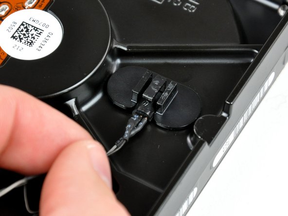

      • Peel off the piece of foam tape covering the hard drive thermal sensor.
      Ask FixBot

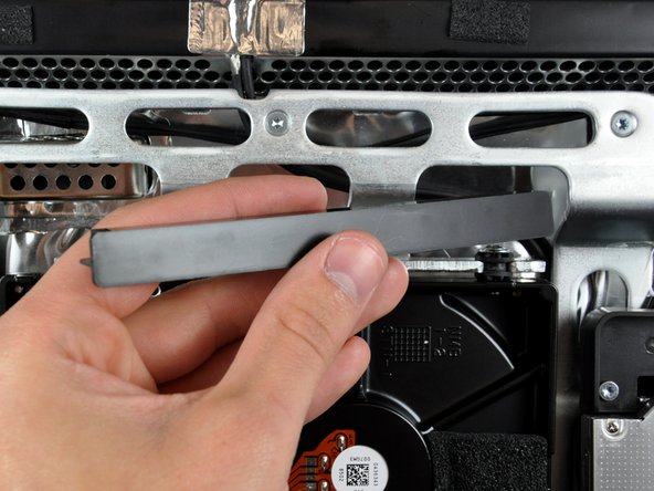

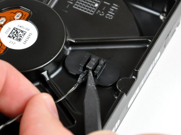

    4. iMac Intel 24" EMC 2267 Hard Drive Replacement: step 20, image 1 of 2 iMac Intel 24" EMC 2267 Hard Drive Replacement: step 20, image 2 of 2
      • To remove the hard drive thermal sensor, use the sharp end of a spudger to lift the center finger of the thermal sensor bracket while applying slight tension to the thermal sensor cable.
      • If the thermal sensor is stuck to the hard drive, skip to the next step.
      Ask FixBot

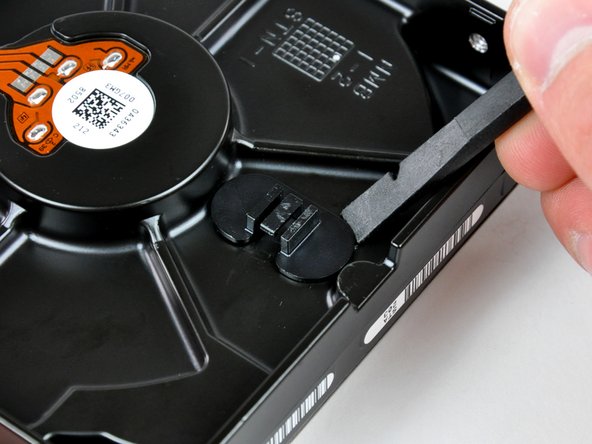

      • Use the flat end of a spudger to pry the hard drive thermal sensor bracket up off the adhesive securing it to the hard drive.
      • If the adhesive gets dirty or will not stick to your new hard drive, place some double-sided tape under the two semicircular ears of the thermal sensor bracket.

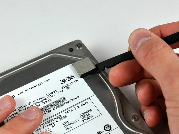

    6. iMac Intel 24" EMC 2267 Hard Drive Replacement: step 22, image 1 of 1
      • Use a spudger to remove the small piece of EMI foam from the top of the hard drive.
      • Don't forget to transfer this to your new hard drive.
