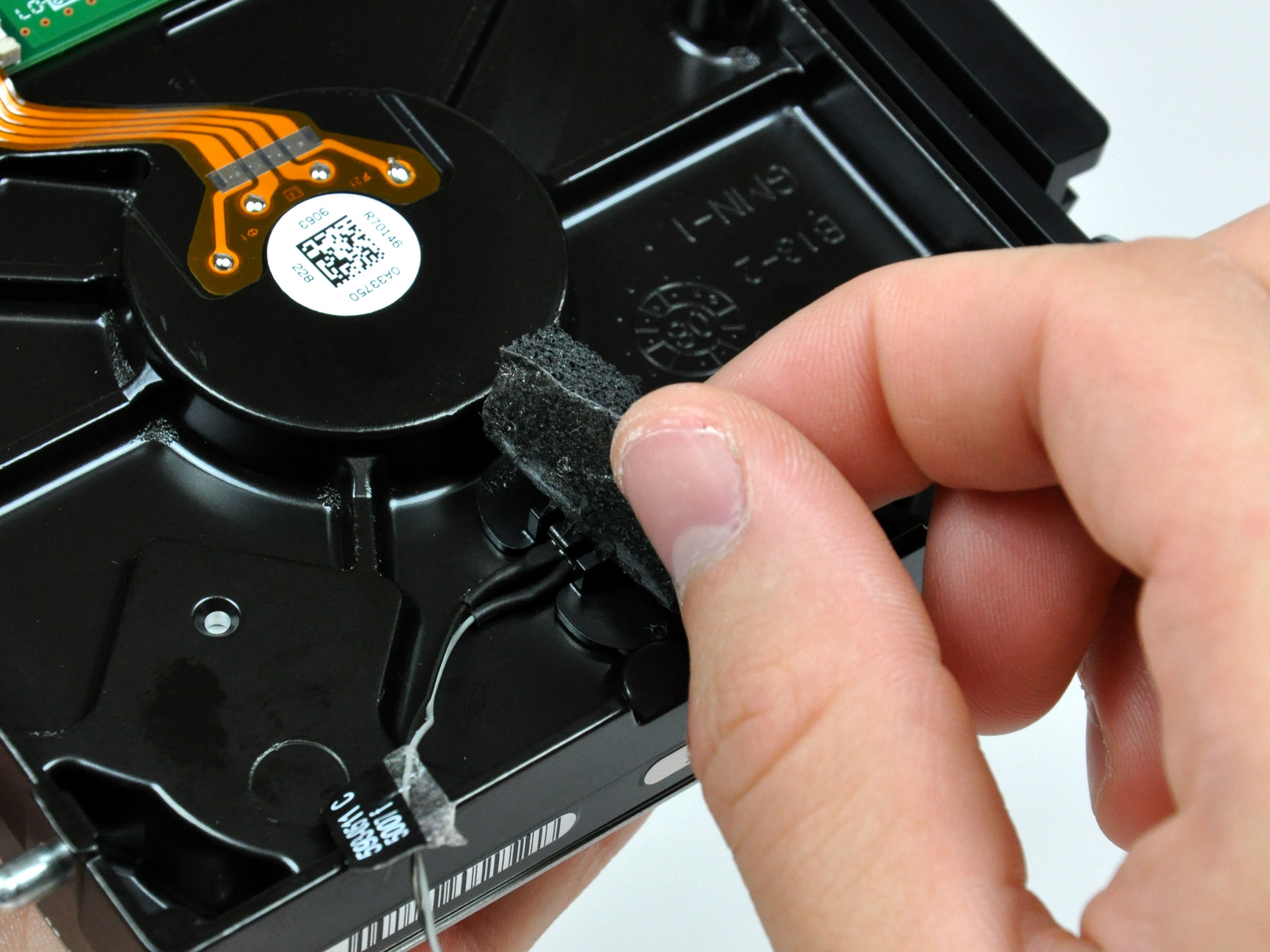

  20. iMac Intel 24" EMC 2134 and 2211 Hard Drive Replacement, Hard Drive: step 20, image 1 of 1
    • Remove the piece of foam tape covering the hard drive thermal sensor.

  25. iMac Intel 24" EMC 2134 and 2211 Hard Drive Replacement: step 25, image 1 of 1
    • Use the flat end of a spudger to remove the piece of EMI foam from the underside of your hard drive.
    • Don't forget to transfer this to your new hard drive.
