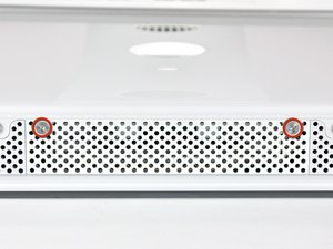

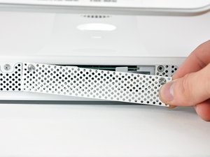

    1. iMac Intel 24" EMC 2111 RAM Replacement, Access Door: step 1, image 1 of 2 iMac Intel 24" EMC 2111 RAM Replacement, Access Door: step 1, image 2 of 2
      • Loosen the two Phillips screws securing the access door to your iMac.
      • Both screws remain captive within the access door.
      • Remove the access door.
