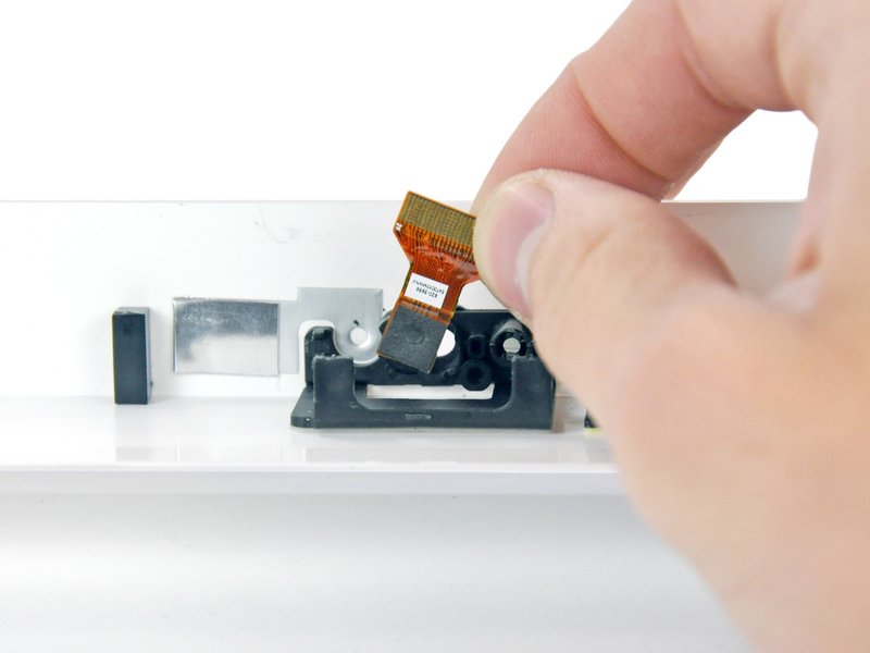

    1. iMac Intel 24" EMC 2111 Camera Replacement, Camera: step 13, image 1 of 2 iMac Intel 24" EMC 2111 Camera Replacement, Camera: step 13, image 2 of 2
      • Remove the two Phillips screws securing the camera to the camera bracket.
      • Remove the small black plastic camera bracket from the front bezel.
      Ask FixBot
    2. iMac Intel 24" EMC 2111 Camera Replacement: step 14, image 1 of 1
      • Pull the camera lens away from the camera bracket and remove it from the front bezel.
      Ask FixBot
