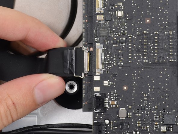

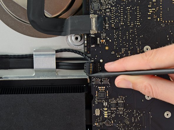

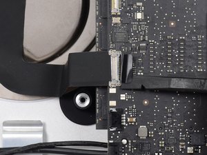

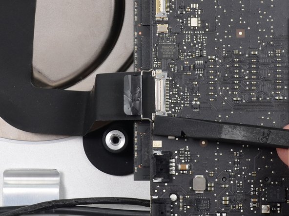

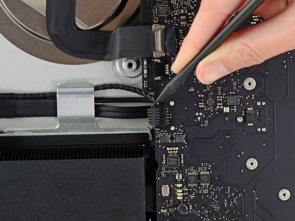

    2. iMac Intel 21.5" EMC 2638 RAM Replacement: step 20, image 1 of 3 iMac Intel 21.5" EMC 2638 RAM Replacement: step 20, image 2 of 3 iMac Intel 21.5" EMC 2638 RAM Replacement: step 20, image 3 of 3
      • Use the tip of a spudger to flip up the metal retaining bracket on the display data cable.
      • Carefully pull the display data cable from its socket on the logic board.
      • Be sure to pull the display data cable connector straight out of its socket.
      Ask FixBot

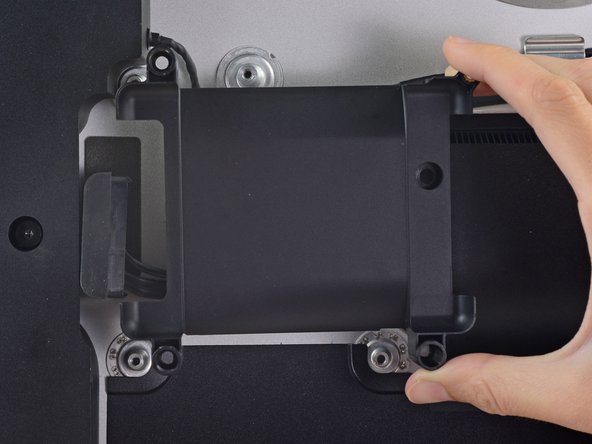

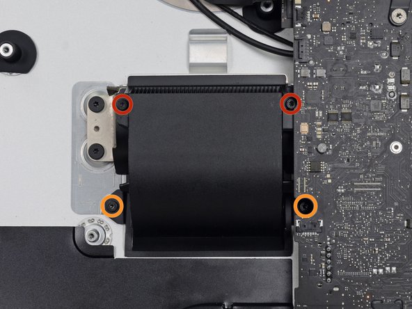

    1. iMac Intel 21.5" EMC 2638 RAM Replacement, Hard Drive Brackets: step 26, image 1 of 1
      • Remove the following screws securing the hard drive bracket to the rear enclosure:
      • Two 21 mm T10 Torx screws from the left-hand hard drive bracket.
      • One 9 mm T10 Torx screw.
      • One 27 mm T10 Torx screw.
      Ask FixBot
    2. iMac Intel 21.5" EMC 2638 RAM Replacement: step 27, image 1 of 2 iMac Intel 21.5" EMC 2638 RAM Replacement: step 27, image 2 of 2
      • Remove the left and right hard drive brackets from the iMac.
      Ask FixBot

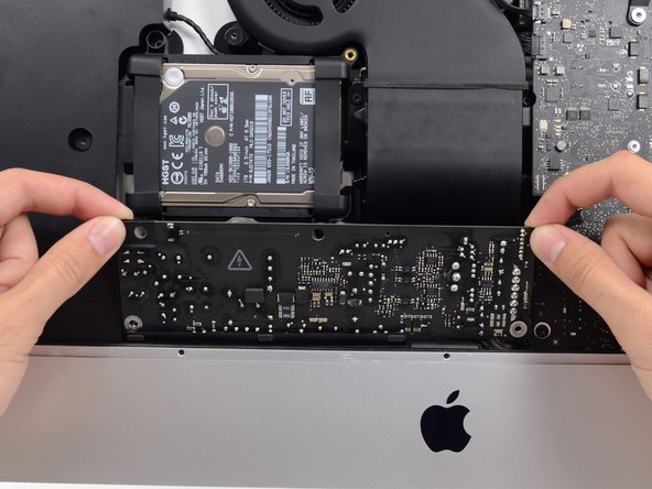

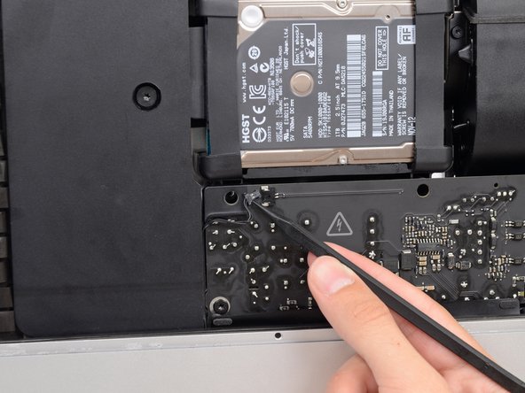

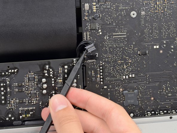

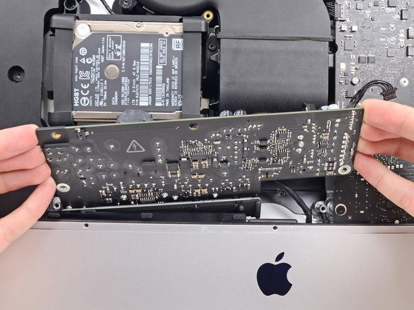

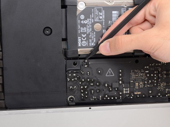

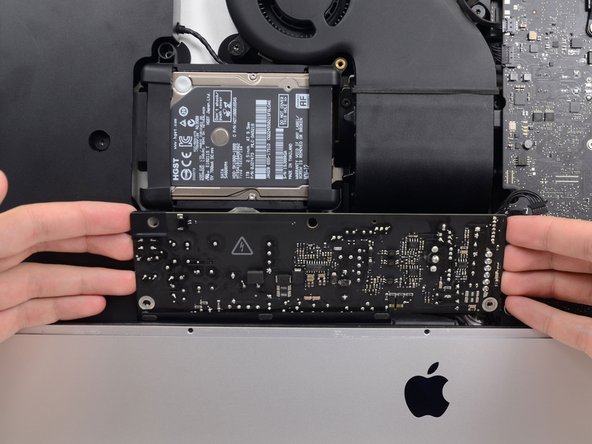

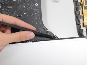

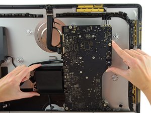

    1. iMac Intel 21.5" EMC 2638 RAM Replacement, Power Supply: step 28, image 1 of 3 iMac Intel 21.5" EMC 2638 RAM Replacement, Power Supply: step 28, image 2 of 3 iMac Intel 21.5" EMC 2638 RAM Replacement, Power Supply: step 28, image 3 of 3
      • The next few steps bring your hands close to the exposed face of the power supply. Do not touch the face of the power supply or any of the exposed solder. Touching it risks a high voltage shock from the many large capacitors attached to the board.
      • Use the tip of a spudger to push each side of the power button cable connector and gently walk it out of its socket.
      Ask FixBot

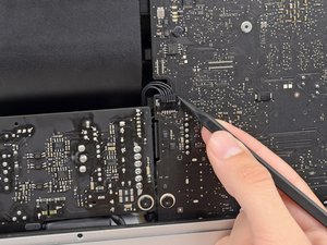

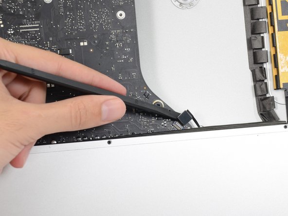

    2. iMac Intel 21.5" EMC 2638 RAM Replacement: step 29, image 1 of 2 iMac Intel 21.5" EMC 2638 RAM Replacement: step 29, image 2 of 2
      • Use the tip of a spudger to push each side of the power supply control cable connector and gently walk it out of its socket.
      Ask FixBot
    3. iMac Intel 21.5" EMC 2638 RAM Replacement: step 30, image 1 of 1
      • Remove the two 7.2 mm T10 Torx screws securing the power supply to the rear enclosure.
      • In newer model iMacs these are 7.2 mm T8 Torx screws.
      • During reassembly, be careful not to trap the power button wire behind the board.
      Ask FixBot

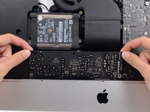

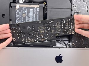

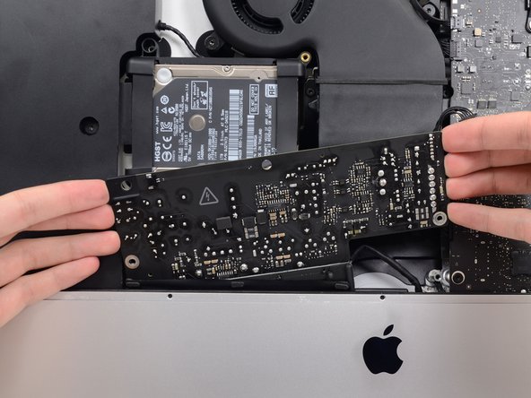

    4. iMac Intel 21.5" EMC 2638 RAM Replacement: step 31, image 1 of 2 iMac Intel 21.5" EMC 2638 RAM Replacement: step 31, image 2 of 2
      • When working on the power supply, be very careful not to touch the capacitor leads or any exposed solder joints on the back of the power supply. Only handle the board by the edges.
      • Tilt the power supply forward.
      Ask FixBot

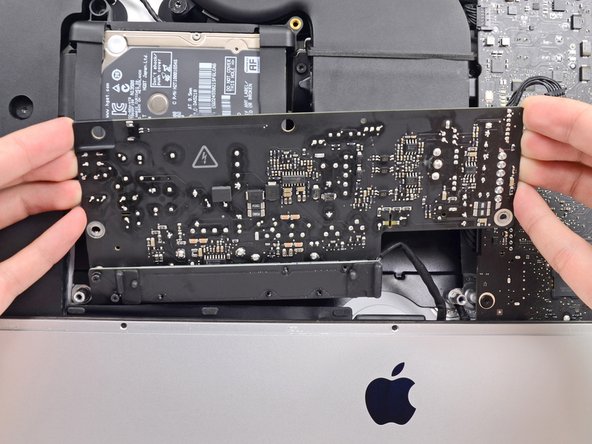

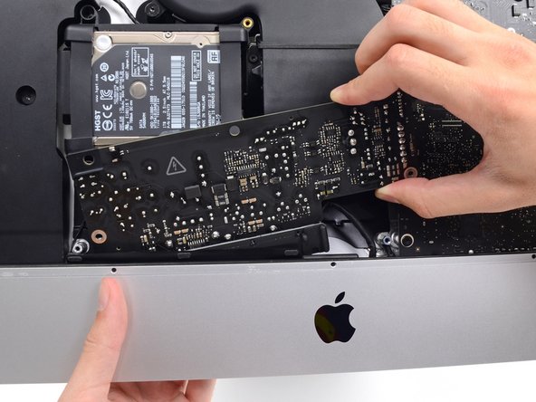

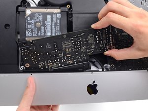

    5. iMac Intel 21.5" EMC 2638 RAM Replacement: step 32, image 1 of 3 iMac Intel 21.5" EMC 2638 RAM Replacement: step 32, image 2 of 3 iMac Intel 21.5" EMC 2638 RAM Replacement: step 32, image 3 of 3
      • Pull the power supply slightly up and out from the rear enclosure.
      • Rotate the power supply counterclockwise, lifting the right side up about an inch higher than the left.
      Ask FixBot

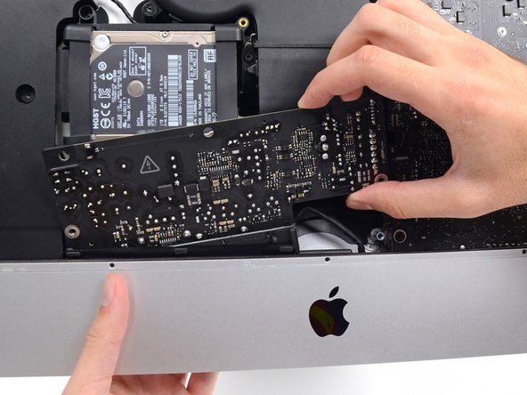

    6. iMac Intel 21.5" EMC 2638 RAM Replacement: step 33, image 1 of 2 iMac Intel 21.5" EMC 2638 RAM Replacement: step 33, image 2 of 2
      • Slide the power supply to the right to clear the screw posts on the rear enclosure.
      Ask FixBot
    7. iMac Intel 21.5" EMC 2638 RAM Replacement: step 34, image 1 of 3 iMac Intel 21.5" EMC 2638 RAM Replacement: step 34, image 2 of 3 iMac Intel 21.5" EMC 2638 RAM Replacement: step 34, image 3 of 3
      • Rock the power supply forward and remove it from its recess in the rear enclosure.
      • Do not try to completely remove the power supply from the iMac yet—it is still connected to the logic board.
      Ask FixBot

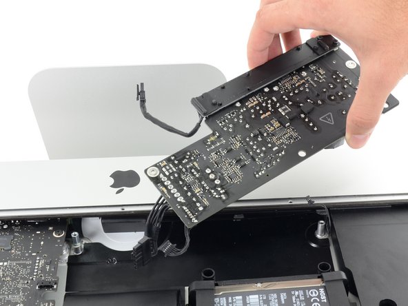

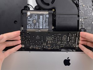

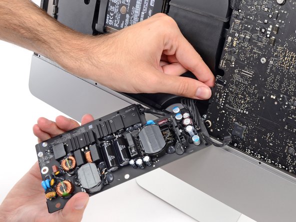

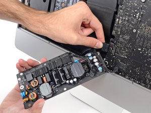

    8. iMac Intel 21.5" EMC 2638 RAM Replacement: step 35, image 1 of 2 iMac Intel 21.5" EMC 2638 RAM Replacement: step 35, image 2 of 2
      • Be very careful not to touch the capacitor leads or any exposed solder joints on the back of the power supply. Only handle the board by the edges.
      • Flip the power supply over to access the DC power cable connection behind the logic board.
      • Squeeze the tab on the back side of the DC power cable connector and pull it straight out of its socket on the back of the logic board.
      Ask FixBot

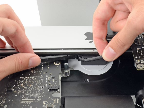

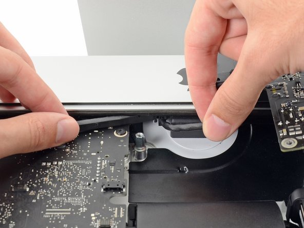

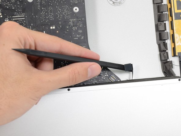

    9. iMac Intel 21.5" EMC 2638 RAM Replacement: step 36, image 1 of 3 iMac Intel 21.5" EMC 2638 RAM Replacement: step 36, image 2 of 3 iMac Intel 21.5" EMC 2638 RAM Replacement: step 36, image 3 of 3
      • You may find it helpful to set the iMac down on its back for the next couple of steps.
      • Use the flat end of a spudger to press the clip on the side of the AC inlet cable connector inward.
      • While pressing on the release clip with the spudger, grasp the AC inlet cable, and pull the connector straight out of its socket.
      Ask FixBot
    10. iMac Intel 21.5" EMC 2638 RAM Replacement: step 37, image 1 of 1
      • Remove the power supply from the iMac.
      Ask FixBot

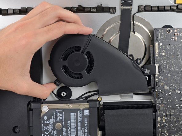

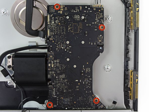

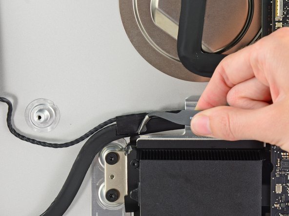

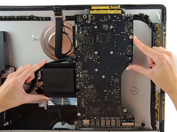

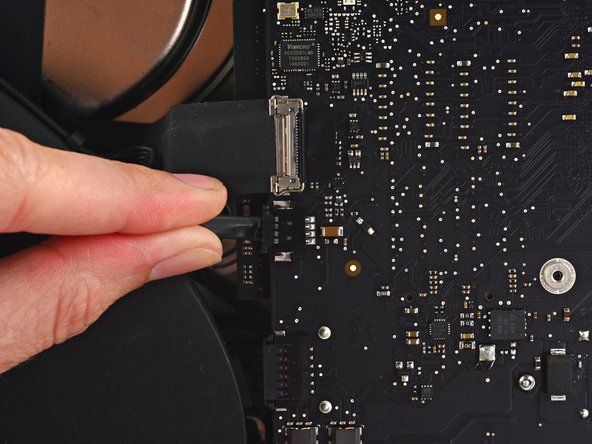

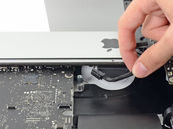

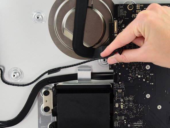

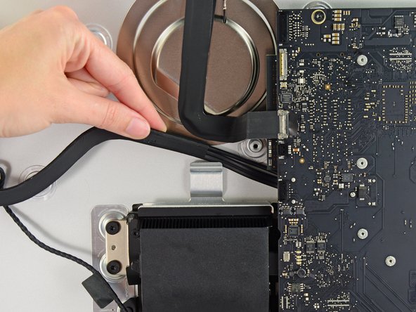

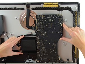

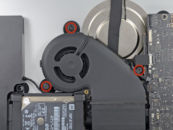

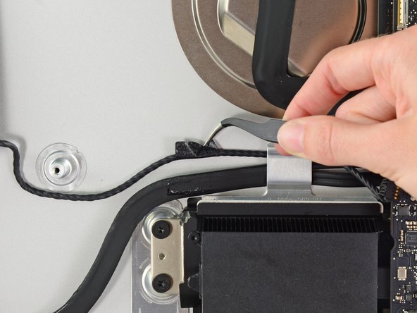

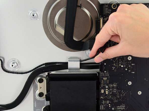

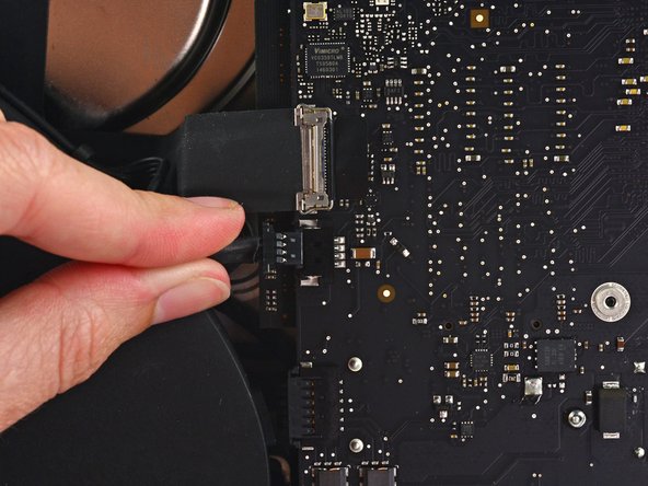

    1. iMac Intel 21.5" EMC 2638 RAM Replacement, Fan: step 38, image 1 of 2 iMac Intel 21.5" EMC 2638 RAM Replacement, Fan: step 38, image 2 of 2
      • Gently pull the fan cable connector straight away from its socket on the logic board.
      Ask FixBot

      • Remove the three 12.3 mm T10 shoulder screws securing the fan to the rear enclosure.
      Ask FixBot

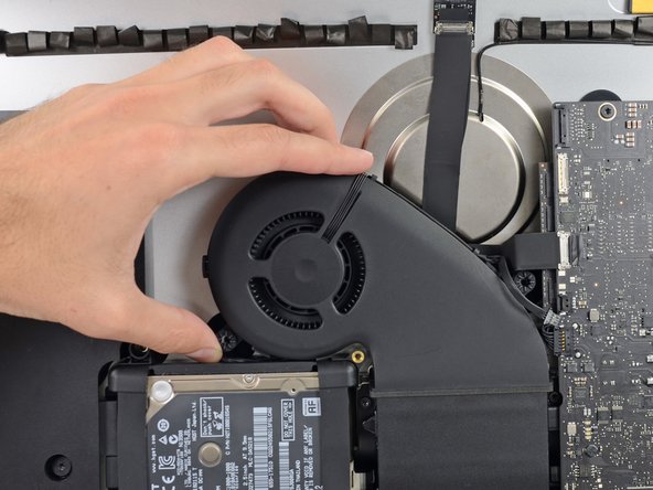

    3. iMac Intel 21.5" EMC 2638 RAM Replacement: step 40, image 1 of 2 iMac Intel 21.5" EMC 2638 RAM Replacement: step 40, image 2 of 2
      • Remove the fan from the iMac.

      • Lift the hard drive from the edge nearest the logic board and pull it slightly out of its recess.
      • The hard drive is attached by a single SATA power/data cable—do not attempt to fully remove it from the iMac yet.
      Ask FixBot
    2. iMac Intel 21.5" EMC 2638 RAM Replacement: step 42, image 1 of 2 iMac Intel 21.5" EMC 2638 RAM Replacement: step 42, image 2 of 2
      • Use a spudger to disconnect the single SATA power and data combo cable by gently prying its large plastic connector away from the hard drive.

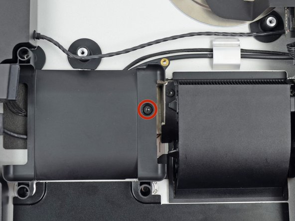

    1. iMac Intel 21.5" EMC 2638 RAM Replacement, Hard Drive Tray: step 44, image 1 of 1
      • Remove the single 7.2 mm T10 screw securing the hard drive tray to the rear enclosure.
      Ask FixBot
    2. iMac Intel 21.5" EMC 2638 RAM Replacement: step 45, image 1 of 1
      • Remove the hard drive tray from the rear enclosure.
      Ask FixBot
    1. iMac Intel 21.5" EMC 2638 RAM Replacement, Logic Board Assembly: step 46, image 1 of 2 iMac Intel 21.5" EMC 2638 RAM Replacement, Logic Board Assembly: step 46, image 2 of 2
      • Push on each side of the left speaker cable connector with the tip of a spudger and gently walk it out of its socket.
      Ask FixBot

      • If necessary, use a pair of tweezers to gently peel the tape securing the left speaker cable to the SATA data/power cable.
      • This tape only needs to be removed if you are removing the left speaker.

      • De-route the left speaker cable by pulling it straight up out of the retaining clip in the back of the rear enclosure.
      • In a similar fashion, lift the combo SATA data/power cable up out of the retaining clip.

    4. iMac Intel 21.5" EMC 2638 RAM Replacement: step 49, image 1 of 3 iMac Intel 21.5" EMC 2638 RAM Replacement: step 49, image 2 of 3 iMac Intel 21.5" EMC 2638 RAM Replacement: step 49, image 3 of 3
      • Use the flat edge of a spudger to flip up the metal retaining bracket on the iSight camera cable connector.
      • Pull the iSight camera cable straight out of its socket on the logic board.
      • Do not use excessive force. This is a delicate connector that can be easily damaged.

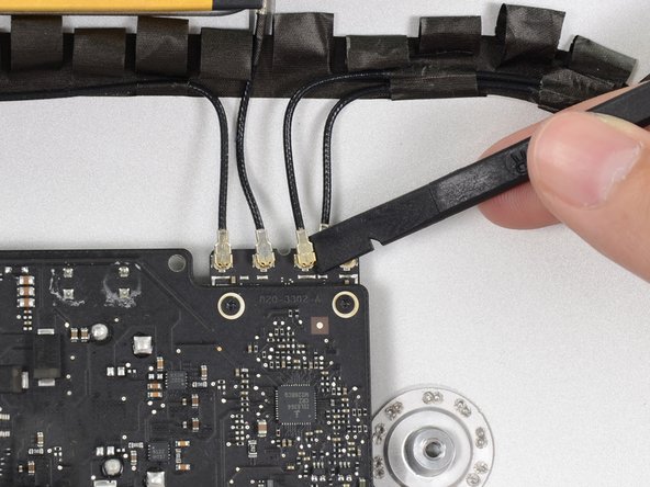

    5. iMac Intel 21.5" EMC 2638 RAM Replacement: step 50, image 1 of 3 iMac Intel 21.5" EMC 2638 RAM Replacement: step 50, image 2 of 3 iMac Intel 21.5" EMC 2638 RAM Replacement: step 50, image 3 of 3

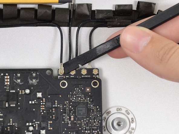

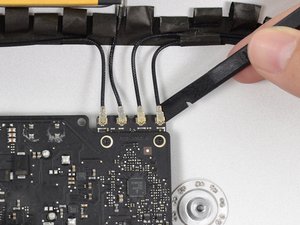

      • Use the flat edge of a spudger to disconnect each of the four antenna connectors from the AirPort/Bluetooth card.
      • Note the original positions for each connector when reconnecting the cables.

      • Use the flat edge of a spudger to pry the headphone jack cable connector from its socket on the logic board.
      • Push the cable slightly to the right to clear it for the removal of the logic board.

    7. iMac Intel 21.5" EMC 2638 RAM Replacement: step 52, image 1 of 1
      • Remove the following screws securing the exhaust duct to the rear enclosure:
      • Two 6.3 mm T8 screws
      • Two 4.7 mm T8 screws

      • Remove the four 7.2 mm T10 screws securing the logic board to the rear enclosure.
      Ask FixBot

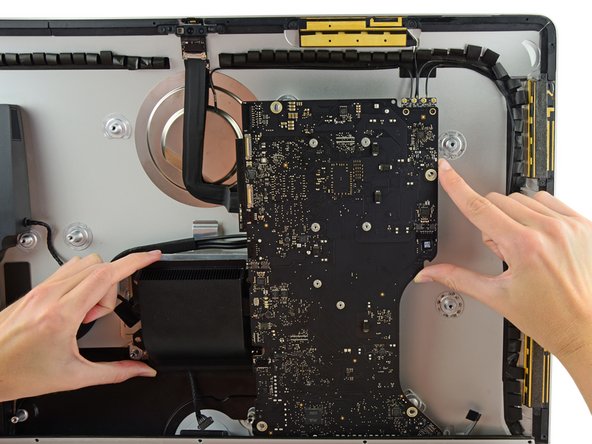

    9. iMac Intel 21.5" EMC 2638 RAM Replacement: step 54, image 1 of 3 iMac Intel 21.5" EMC 2638 RAM Replacement: step 54, image 2 of 3 iMac Intel 21.5" EMC 2638 RAM Replacement: step 54, image 3 of 3
      • Tilt the top of the logic board away from the rear enclosure.
      • Lift the logic board straight up and out of the iMac.
      • Be careful not to snag the board on any of the rear case's screw posts.
      • The I/O boards at the bottom of the logic board will be the greatest challenge. It is recommended to pull gently to avoid any damage.
      Ask FixBot

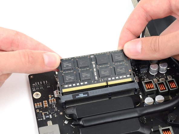

    1. iMac Intel 21.5" EMC 2638 RAM Replacement, RAM: step 56, image 1 of 3 iMac Intel 21.5" EMC 2638 RAM Replacement, RAM: step 56, image 2 of 3 iMac Intel 21.5" EMC 2638 RAM Replacement, RAM: step 56, image 3 of 3
      • Release the tabs on each side of the RAM module by simultaneously pushing each tab away.
      • The RAM module should pop up slightly from its socket.
      • Grab the top left and right corners of the RAM module and carefully pull it straight out of its socket.
      • Repeat the process to remove additional RAM modules as necessary.
