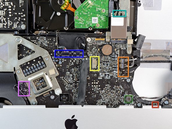

    1. iMac Intel 21.5" EMC 2428 GPU Card Replacement, Logic Board: step 22, image 1 of 1
      • In the proceeding steps, you will disconnect the following cables:
      • SD Board
      • Left/Right Speaker and Microphone
      • Audio Port
      • Wi-Fi Antenna
      • Right Temperature Sensor, Bluetooth/Ambient Light Sensor/Camera/Left Temperature, and Hard Drive Fan
      • CPU Fan/Ambient Temperature and Power Button
      • IR Sensor

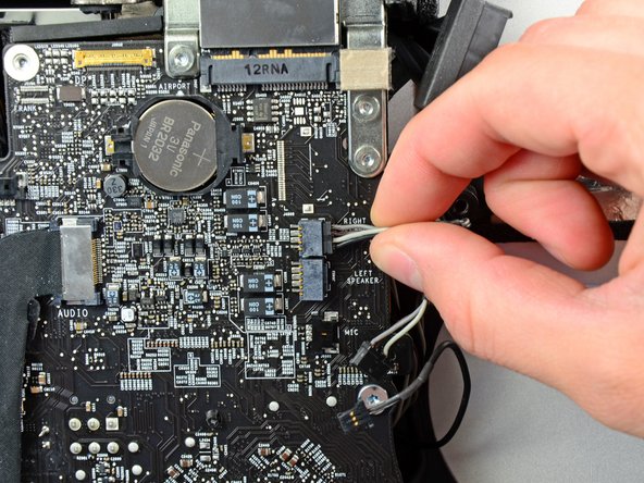

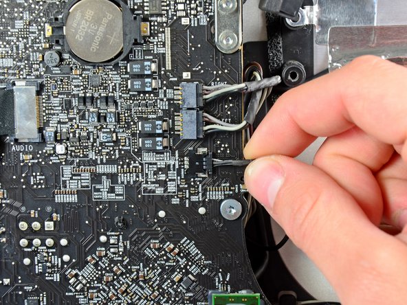

      • Disconnect the microphone, left speaker, and right speaker cables by pulling their connectors toward the right side of the iMac.
      Ask FixBot

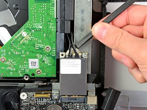

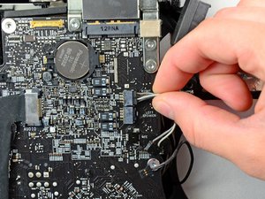

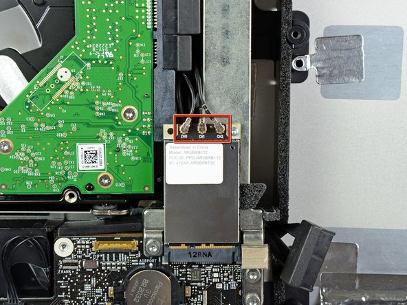

    4. iMac Intel 21.5" EMC 2428 GPU Card Replacement: step 25, image 1 of 2 iMac Intel 21.5" EMC 2428 GPU Card Replacement: step 25, image 2 of 2

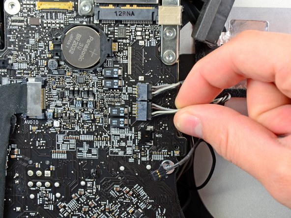

      • Use the flat end of a spudger to pry all three AirPort antenna connectors up from their sockets on the AirPort board.
      • During reinstallation, connect the cable with no stripes to the socket marked CH0, the cable with one stripe to CH1, and the cable with two stripes to CH2.
      Ask FixBot

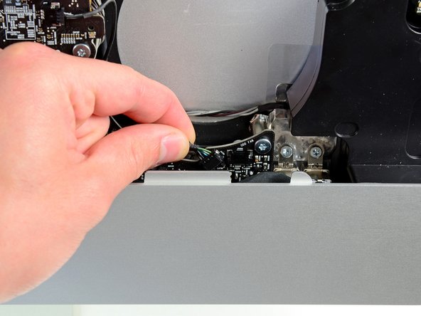

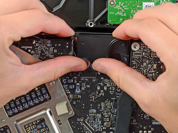

      • Pull the hard drive fan connector toward the top edge of the iMac to disconnect it from its socket on the logic board.
      Ask FixBot

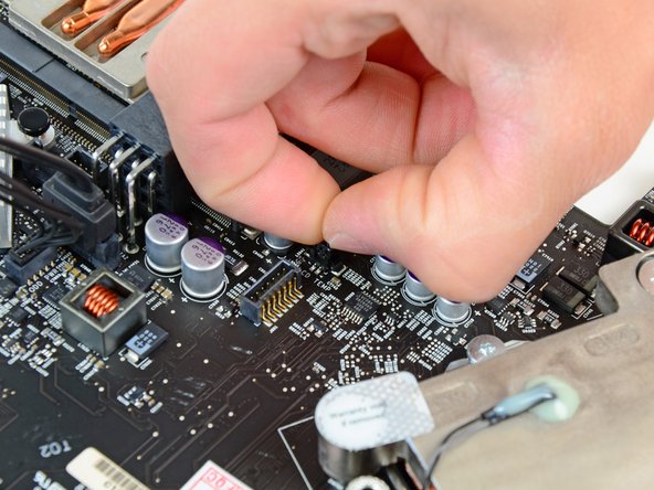

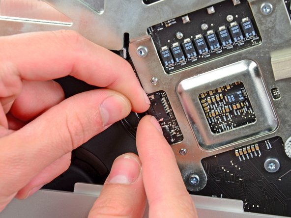

      • Pull the CPU fan/ambient temperature sensor connector toward the bottom left edge of the iMac and out of its socket on the logic board.
      Ask FixBot

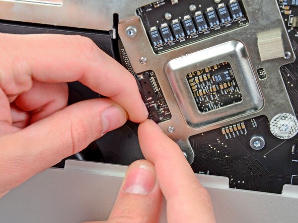

    9. iMac Intel 21.5" EMC 2428 GPU Card Replacement: step 30, image 1 of 1
      • Pull the power button connector toward the bottom left corner of the iMac to disconnect it from its socket on the logic board.
      Ask FixBot

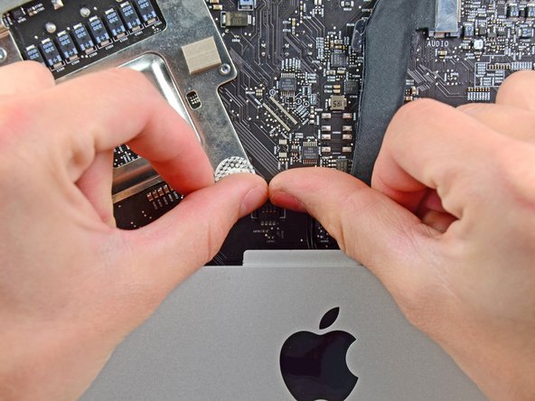

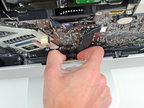

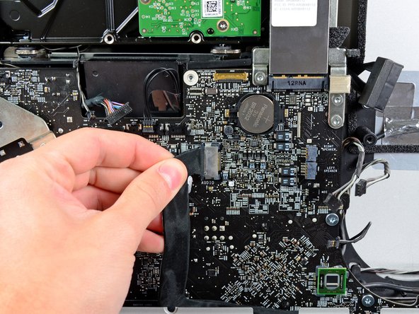

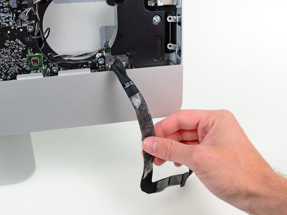

      • Pull the audio port cable connector toward the left side of the iMac to disconnect it from the logic board.
      • Do not pull the cable toward yourself (away from the front face of the logic board) as you disconnect it.
      • Peel the audio port cable off the front face of the logic board and let it hang down as shown in the second picture.

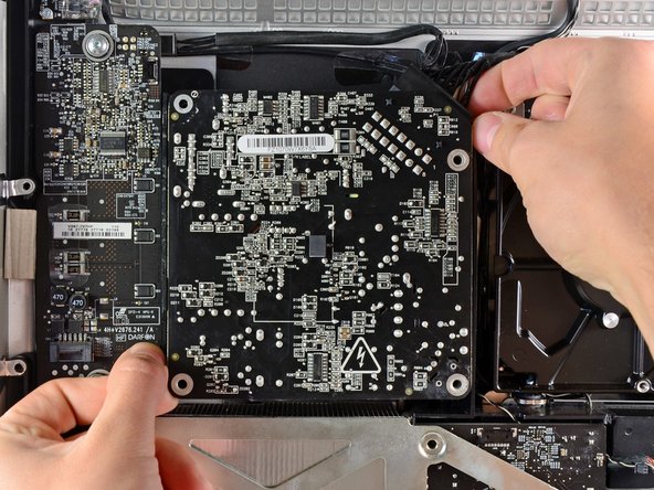

    13. iMac Intel 21.5" EMC 2428 GPU Card Replacement: step 34, image 1 of 2 iMac Intel 21.5" EMC 2428 GPU Card Replacement: step 34, image 2 of 2

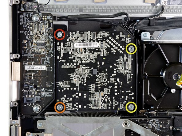

      • Remove the following four screws:
      • One 9.3 mm T10 coarse-threaded screw
      • One 25 mm T10 coarse-threaded screw
      • Two 22 mm fine-threaded screws
      • Pull the upper right and lower left corners of the power supply away from the rear case to dislodge the mounting posts attached to the power supply's corners.
      Ask FixBot

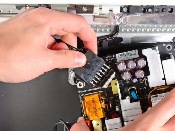

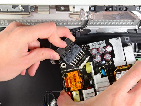

    14. iMac Intel 21.5" EMC 2428 GPU Card Replacement: step 35, image 1 of 2 iMac Intel 21.5" EMC 2428 GPU Card Replacement: step 35, image 2 of 2
      • Carefully lift the power supply out of the outer case and rotate it to expose the cable lock as shown, minding the DC-out and AC-in cables still attaching it to the iMac.
      • Disconnect the DC-out cable by depressing the locking mechanism on the connector while you pull the connector away from its socket on the power supply.
      • Once the locking mechanism has cleared the socket, pull the DC-in connector away from the power supply.
      Ask FixBot

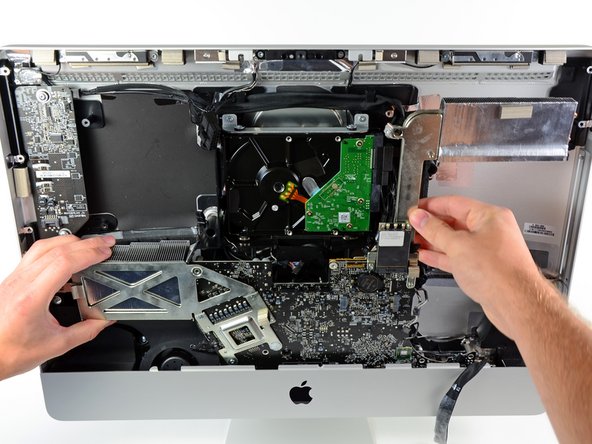

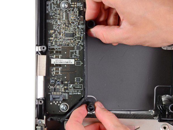

      • Remove the plastic wall that is installed directly to the right of the LED driver board.
      Ask FixBot

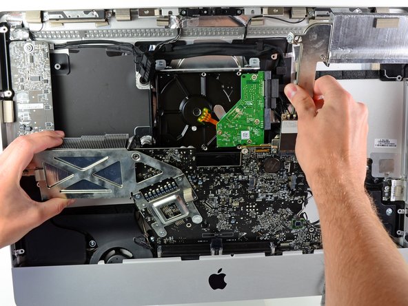

    17. iMac Intel 21.5" EMC 2428 GPU Card Replacement: step 38, image 1 of 2 iMac Intel 21.5" EMC 2428 GPU Card Replacement: step 38, image 2 of 2

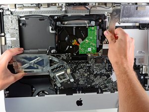

      • Slightly pull the logic board away from the back of the outer case, then lift it upward to clear the lower front face of the outer case.
      Ask FixBot

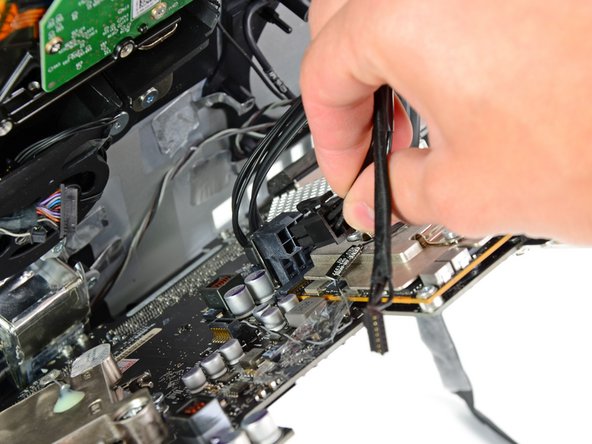

    18. iMac Intel 21.5" EMC 2428 GPU Card Replacement: step 39, image 1 of 1

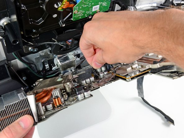

      • Disconnect the LCD temperature cable by pulling its connector up and out of its socket on the logic board.
      Ask FixBot

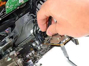

    19. iMac Intel 21.5" EMC 2428 GPU Card Replacement: step 40, image 1 of 2 iMac Intel 21.5" EMC 2428 GPU Card Replacement: step 40, image 2 of 2
      • Depress the locking mechanism and carefully pull the DC-In cable out of its socket on the back of the logic board.
      Ask FixBot

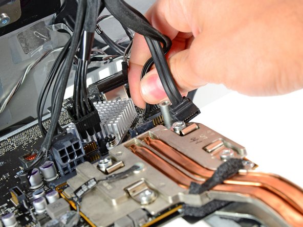

      • Being careful not to damage the socket on the logic board, gently pull the hard drive SATA data cable straight out of its socket on the logic board.
      Ask FixBot
    21. iMac Intel 21.5" EMC 2428 GPU Card Replacement: step 42, image 1 of 1
      • Pull the hard drive power cable connector out of its socket on the logic board.
      Ask FixBot
    22. iMac Intel 21.5" EMC 2428 GPU Card Replacement: step 43, image 1 of 1
      • Remove the logic board from the outer case, minding any cables that may get caught.
      • When reinstalling the logic board, plug in a thunderbolt cable and a USB cable into the USB port closest to the headphone/microphone ports before tightening the logic board screws to ensure proper alignment.

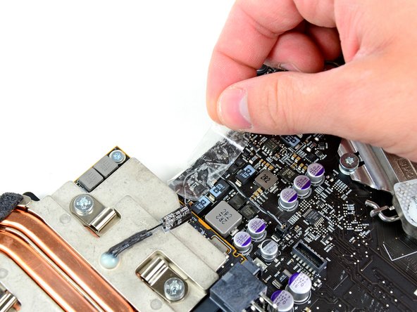

    1. iMac Intel 21.5" EMC 2428 GPU Card Replacement, GPU Assembly: step 44, image 1 of 1
      • Remove the strip of tape securing the GPU thermal sensor cable to the logic board.
      Ask FixBot

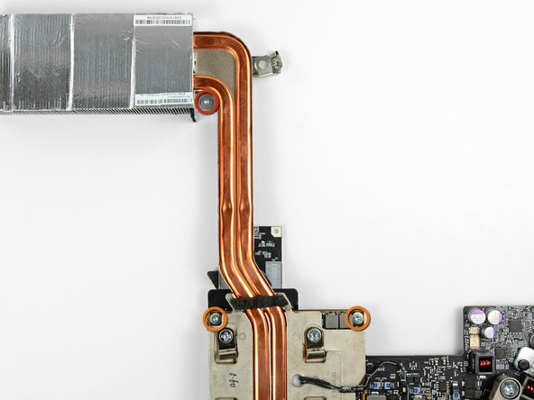

    2. iMac Intel 21.5" EMC 2428 GPU Card Replacement: step 45, image 1 of 1
      • Remove the following three screws:
      • One 4.2 mm T10 Torx screw
      • Two 5 mm T8 Torx screws

    3. iMac Intel 21.5" EMC 2428 GPU Card Replacement: step 46, image 1 of 1
      • Grab the GPU thermal sensor cable connector and pull it straight up and out of its socket on the logic board.
      • Do not pull the connector out by its cables.

    4. iMac Intel 21.5" EMC 2428 GPU Card Replacement: step 47, image 1 of 1
      • Lift the GPU heat sink slightly and pull the GPU board out of its socket on the logic board.

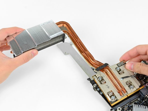

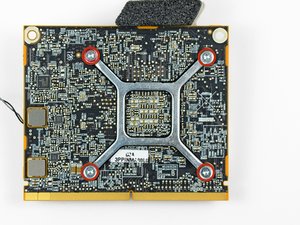

    1. iMac Intel 21.5" EMC 2428 GPU Card Replacement, GPU Card: step 48, image 1 of 2 iMac Intel 21.5" EMC 2428 GPU Card Replacement, GPU Card: step 48, image 2 of 2
      • Remove the four 6.5 mm T8 Torx screws securing the GPU heat sink to the GPU.
      • It may be necessary to use a #1 screwdriver to hold the sockets on the GPU heat sink stationary as you loosen the T8 Torx screws.
      Ask FixBot

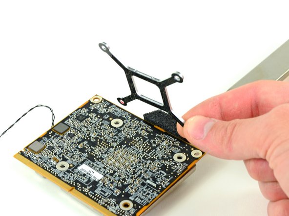

    2. iMac Intel 21.5" EMC 2428 GPU Card Replacement: step 49, image 1 of 1
      • Remove the clamping bracket from the back of the GPU.

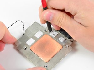

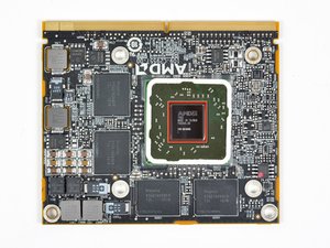

    3. iMac Intel 21.5" EMC 2428 GPU Card Replacement: step 50, image 1 of 3 iMac Intel 21.5" EMC 2428 GPU Card Replacement: step 50, image 2 of 3 iMac Intel 21.5" EMC 2428 GPU Card Replacement: step 50, image 3 of 3

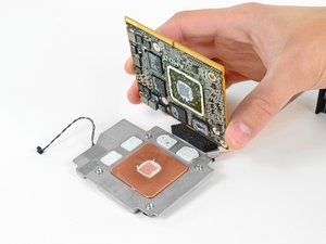

      • Remove the GPU from the GPU heat sink.
      • Make sure to apply a new layer of thermal paste to the face of the GPU (the area boxed in red) before reattaching the heat sink. Our thermal paste guide makes it easy.
      • Before installing new thermal paste and mounting a new GPU to the GPU heat sink, use the flat end of a spudger to push the VRAM thermal goop closer together so it will better contact the VRAM when the GPU is installed.
      • Do not use thermal paste on the VRAM chips (the black boxes around the GPU). The VRAM chips are shorter than the GPU, and therefore need thermal pads to make contact with the cooling element. Replacing the thermal pads with paste will cause the card to overheat and can potentially ruin it.
