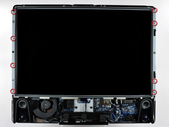

    • After removing the front bezel, you need to remove the 8ea 12mm T8 screws around the perimeter of the LCD

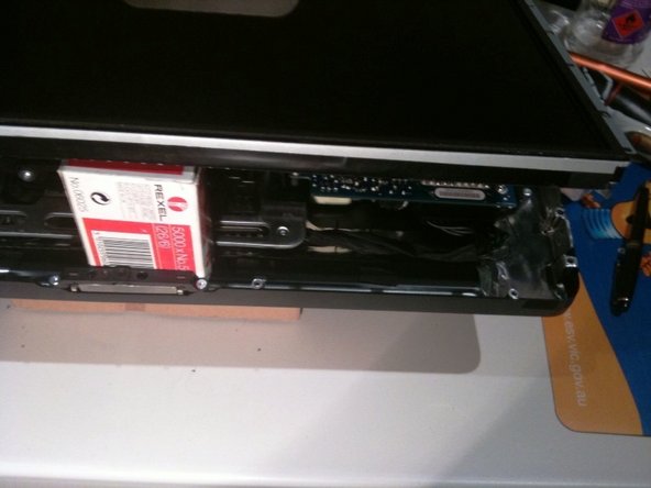

    • Rotate the iMac so the TOP EDGE is facing you and GENTLY lift the LCD up about 75mm (3in) and prop up the LCD with something NON CONDUCTIVE.
    • Lifting the LCD in this way exposes the rear of the PSU to allow access to the PSU connector. When the imac is connected to the mains (even if switched OFF) there is MAINS VOLTAGE on this board

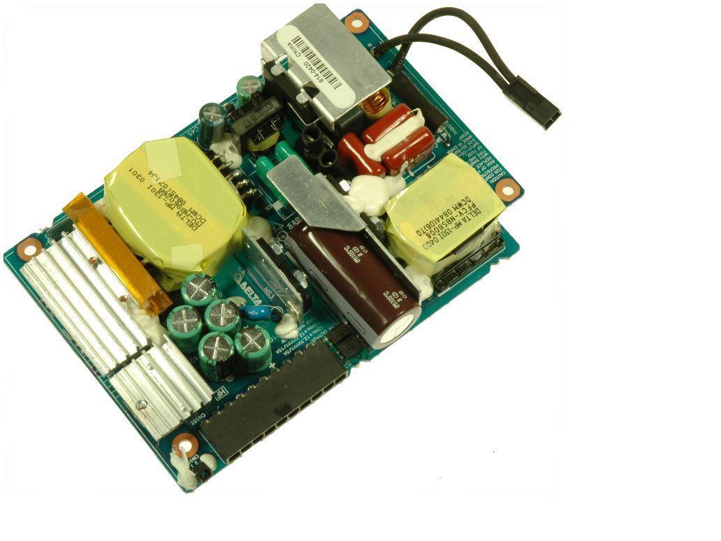

  8. iMac Intel 20" EMC 2210 Power Supply Output Voltage Test: step 8, image 1 of 3 iMac Intel 20" EMC 2210 Power Supply Output Voltage Test: step 8, image 2 of 3 iMac Intel 20" EMC 2210 Power Supply Output Voltage Test: step 8, image 3 of 3
    • REMEMBER - there is MAINS voltage on the PSU so use extreme caution
    • Use the chart provided as a reference and test the various voltages with your meter being sure to restrict the probes to the 10 solder joints on the PSU connector shown within the BLUE rectangle. Shorting any part of the PCB will almost certainly cause damage to the imac
    • All voltage measurements are taken with PIN 1 as reference (Marked with the YELLOW square). Pin 1 is marked on the board by a dot and is the right hand pin when viewed as shown in photos
    • STANDBY means system connected to mains outlet but imac turned off - Diagnostic LED 1 will be illuminated on logic board
    • Pin 5 is the PSU enable line - Logic board pulls this line low (0V) to enable PSU (probably via a resistor)
    • Pin 4 voltage varies according to the PSU temperature and is inversely proportional to PSU temperature. Higher Temp = Lower Voltage. My measurement was taken at around **24 Deg Celsius.

Something I don't get…
I'm investigating on my mid2007 iMac power problems and I don't get the same results of voltage as in this article. In my case, number 9 is at around 12V and number 8 is at 0V.
Is my PSU really faulty or there might be some other PSU models?
Vince1286 - Reply
I've got the same results as you. Wondering if we have the wrong ps model, despite being what iFixit recommends and sells. Very odd.
Matthew Zeller -
i have the same issue. Do we have the wrong power supply or the wrong voltage chart?
Tim Bowman - Reply
Have also the same, maybe the table here is wrong. What kind of problems does your mac have?
Marvin Marik -
Hello, I get 0 volt readings on both pins 4 & 8 on Standby. Does this mean the PSU is bad? If I had a 3rd arm to press the power button I could test other pins. Thank you!
Charles - Reply
