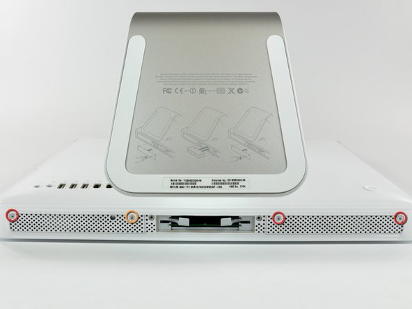

      • Remove the following four screws:
      • Three 6 mm T8 Torx.
      • One 8 mm T8 Torx.
      Ask FixBot

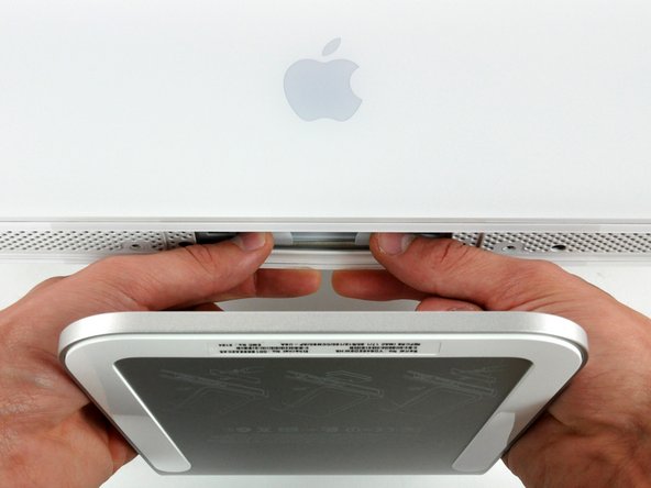

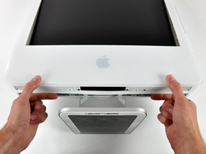

    2. iMac Intel 17" Hard Drive Replacement: step 3, image 1 of 2 iMac Intel 17" Hard Drive Replacement: step 3, image 2 of 2
      • Flip your iMac over and lay it stand-side down on a flat surface.
      • To lift the front bezel off the iMac, simultaneously:
      • Use your thumbs to press in the RAM arms and hold the iMac down.
      • Use your index fingers to pull the small bridge of material on the front bezel toward yourself.
      • Pull the Front bezel up with your index fingers.
      • Once the small bridge of material has cleared the RAM arms, lift the front bezel by its lower edge just enough to clear the bottom edge of the rear case.

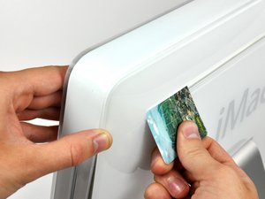

    3. iMac Intel 17" Hard Drive Replacement: step 4, image 1 of 3 iMac Intel 17" Hard Drive Replacement: step 4, image 2 of 3 iMac Intel 17" Hard Drive Replacement: step 4, image 3 of 3
      Tool used on this step:
      Plastic Cards
      $2.99
      Buy

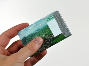

      • Re-orient your iMac so it sits upright on the stand.
      • Insert a plastic card up into the corner of the air vent slot near the top of the rear case.
      • Push the card toward the top of the iMac to release the front bezel latch.
      • Pull the front bezel away from the rear case.
      • Repeat this process for the other side of the front bezel.
      • It may be necessary to apply several layers of duct tape to the top of the access card to aid in releasing the latches.
      • If the bezel refuses to release, try pressing the lower edge back onto the rear case and repeat this opening process.

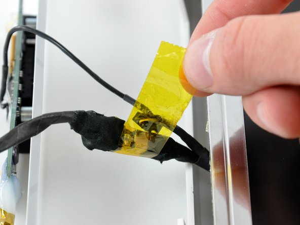

    5. iMac Intel 17" Hard Drive Replacement: step 6, image 1 of 1
      • If necessary, remove the piece of kapton tape(it is ok to toss this) wrapped around the microphone and camera cables.
      Ask FixBot

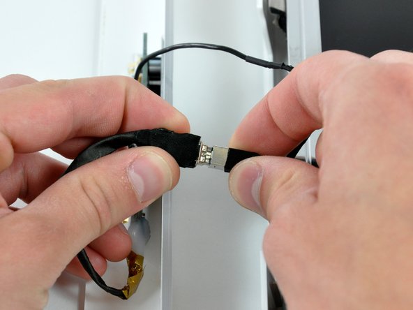

    6. iMac Intel 17" Hard Drive Replacement: step 7, image 1 of 2 iMac Intel 17" Hard Drive Replacement: step 7, image 2 of 2

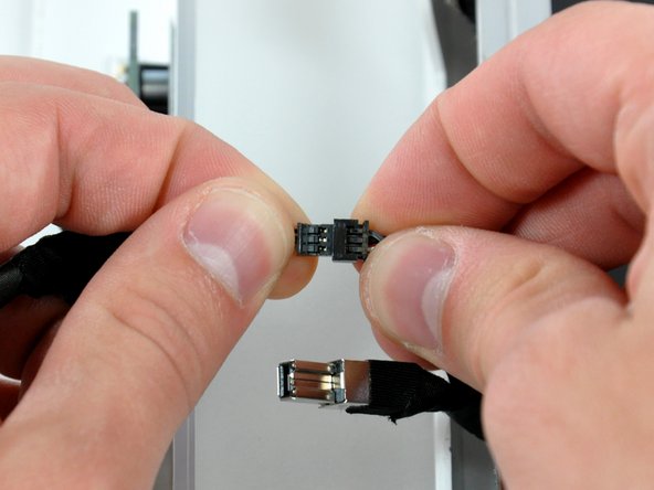

      • Disconnect both the camera and microphone cables.
      Ask FixBot

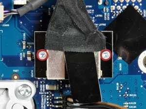

    2. iMac Intel 17" Hard Drive Replacement: step 9, image 1 of 2 iMac Intel 17" Hard Drive Replacement: step 9, image 2 of 2

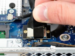

      • Remove the two 4.8 mm T6 Torx screws securing the display data cable to the logic board.
      • Grab the display data cable connector by its black tab and pull it straight up off the logic board.

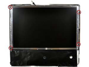

      • Allow the EMI shield to hang down from the display.

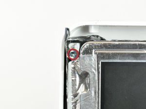

      • Remove the four 8 mm with 2 mm thick head coarse-thread T10 Torx screws securing the display to the rear case.
      • These screws are recessed, so a thin screwdriver such as this is essential for removal. Bit drivers tend to be too short for this application.
      • It is strongly recommended to use a magnetized screwdriver so the screws won't fall into the iMac.
      Ask FixBot

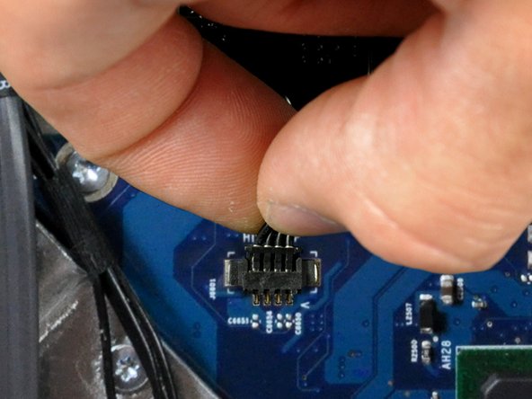

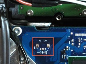

    2. iMac Intel 17" Hard Drive Replacement: step 15, image 1 of 3 iMac Intel 17" Hard Drive Replacement: step 15, image 2 of 3 iMac Intel 17" Hard Drive Replacement: step 15, image 3 of 3

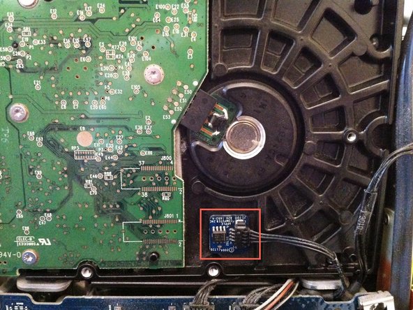

      • A hard drive thermal sensor may be present on some models. If your logic board is missing the hard drive thermal sensor socket highlighted in red in the first picture, skip this step.
      • Pull the hard drive thermal sensor connector away from its socket on the logic board.
      • Pull this connector parallel to the face of the logic board toward the top edge of the iMac.
      • Use a spudger to pry the thermal sensor and adhesive off the hard drive and install it in the same location on the replacement drive.

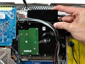

    3. iMac Intel 17" Hard Drive Replacement: step 16, image 1 of 1
      • Press the hard drive bracket down to free it from the rear case, then rotate the top of the drive toward yourself.
      • Pressing the top of the hard drive bracket down to release it from the rear case requires a substantial amount of force, so we recommend laying your iMac stand-side down on a table to avoid knocking it over.
      • If you have trouble releasing the hard drive bracket, it can be removed from the hard drive, by removing the two T8 or T10 Torx screws securing the bracket to the drive.
      Ask FixBot

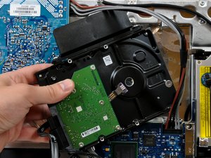

      • Lift the hard drive off its lower pins and pull it out of the rear case, minding the power supply cables that may get caught.
      • When reinstalling your hard drive, be careful not to push the two rubber grommets through their holes in the chassis. Retrieving them would require removing the logic board.

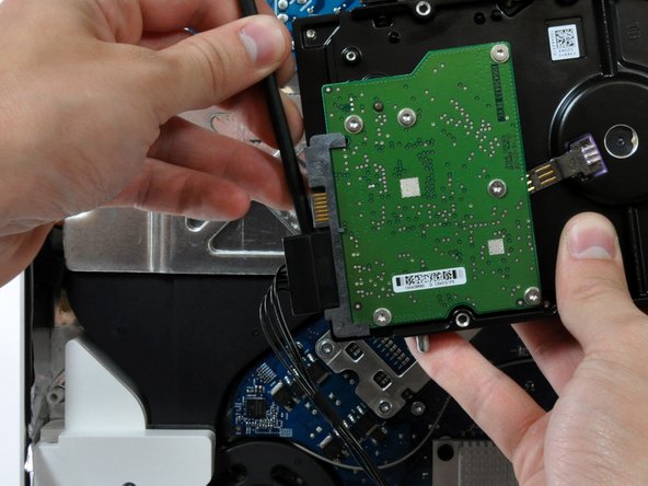

      • Insert a spudger between the SATA connectors and twist it to separate the connector from the hard drive.
      • Disconnect both SATA connectors.

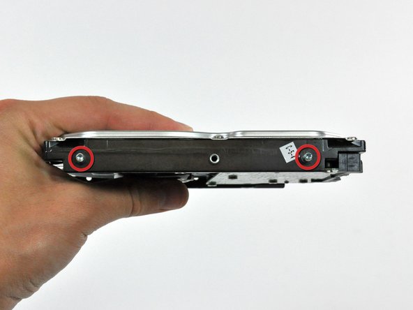

    1. iMac Intel 17" Hard Drive Replacement, Hard Drive: step 19, image 1 of 1
      • Remove the two T8 Torx screws securing the hard drive bracket to the hard drive.
      • Lift the bracket off your old hard drive and transfer to it to your new drive.
      Ask FixBot
