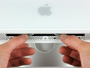

      • Orient the iMac face-up, on its backside.

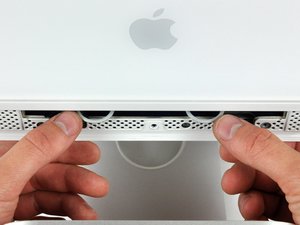

      • Use your thumbs to press both RAM arms in past the front bezel for enough clearance to lift it off the rear case.
      Ask FixBot
    3. iMac G5 17" Model A1144 PRAM Battery Replacement: step 5, image 1 of 1
      • While holding the RAM arms in with your thumbs, lift the lower edge of the front bezel enough to clear the rear case.
      Ask FixBot

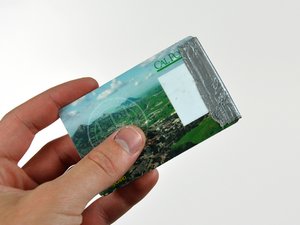

    4. iMac G5 17" Model A1144 PRAM Battery Replacement: step 6, image 1 of 3 iMac G5 17" Model A1144 PRAM Battery Replacement: step 6, image 2 of 3 iMac G5 17" Model A1144 PRAM Battery Replacement: step 6, image 3 of 3
      Tool used on this step:
      Plastic Cards
      $2.99
      Buy

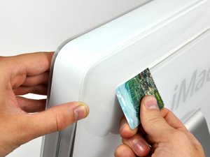

      • Re-orient your iMac so it sits upright on the stand.
      • Insert a plastic card up into the corner of the air vent slot at the top of the rear case.
      • Push the card toward the top of the iMac to release the front bezel latch.
      • Pull the front bezel away from the rear case.
      • Repeat this process for the other side of the front bezel.
      • It may be necessary to apply several layers of duct tape to the top of the access card to aid in releasing the latches.
      • If the bezel refuses to release, try pressing the lower edge back onto the rear case and repeat this opening process.

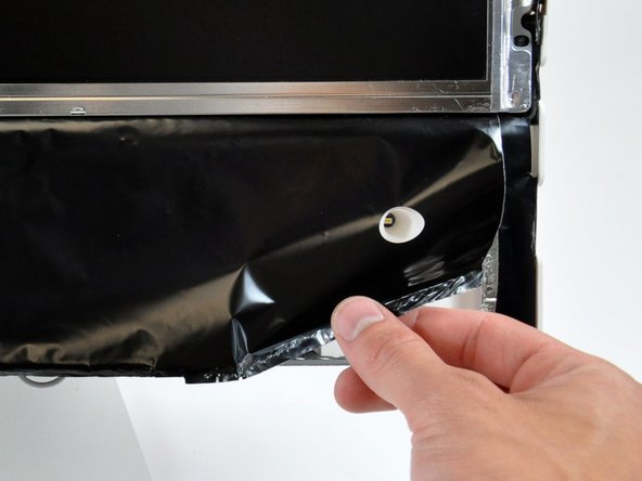

    6. iMac G5 17" Model A1144 PRAM Battery Replacement: step 8, image 1 of 1

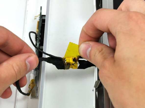

      • If necessary, remove the piece of kapton tape wrapped around the microphone and camera cables.
      Ask FixBot
    7. iMac G5 17" Model A1144 PRAM Battery Replacement: step 9, image 1 of 2 iMac G5 17" Model A1144 PRAM Battery Replacement: step 9, image 2 of 2

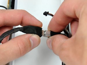

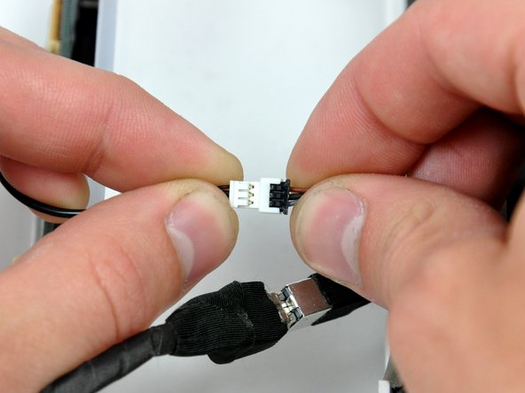

      • Disconnect both the camera and microphone cables.

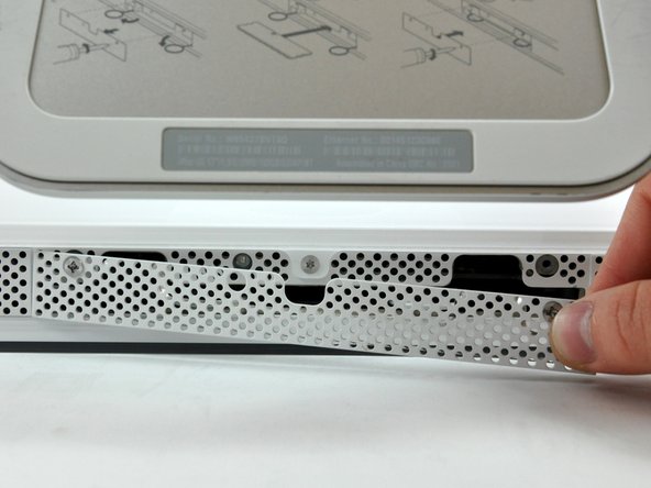

    1. iMac G5 17" Model A1144 PRAM Battery Replacement, Display: step 10, image 1 of 1
      • Peel back the aluminum EMI shield up off the lower three edges of the rear case.
      • It is not necessary to peel the EMI shield off the display.
      • We found it helpful to tape the EMI shield up against the display to keep it out of the way.

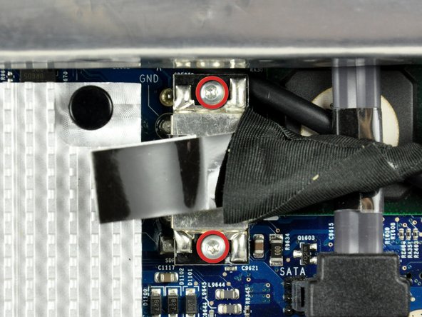

    2. iMac G5 17" Model A1144 PRAM Battery Replacement: step 11, image 1 of 2 iMac G5 17" Model A1144 PRAM Battery Replacement: step 11, image 2 of 2
      • Remove the two 5 mm T6 Torx screws securing the display data cable to the logic board.
      • Using its attached black tab, pull the display data cable connector up off the logic board.
      Ask FixBot

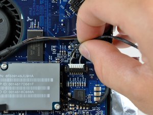

    3. iMac G5 17" Model A1144 PRAM Battery Replacement: step 12, image 1 of 1
      • Pull the inverter cable connector up off its socket on the logic board.
      Ask FixBot

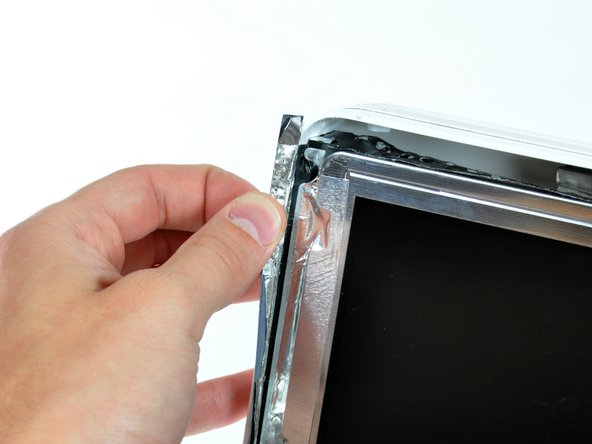

      • Peel back the aluminum EMI tape from the two vertical edges of the display.
      • During reassembly, it is helpful to use several small strips of tape to hold the EMI shielding along the left and right edges of the display footprint out of the way before lowering the display into the rear case of your iMac.

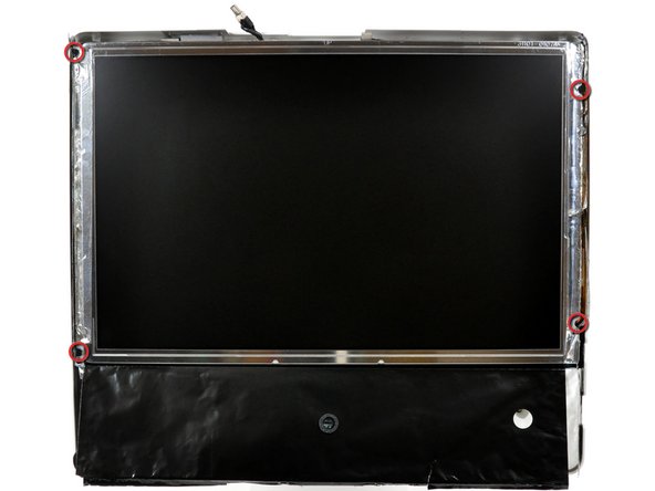

    5. iMac G5 17" Model A1144 PRAM Battery Replacement: step 14, image 1 of 2 iMac G5 17" Model A1144 PRAM Battery Replacement: step 14, image 2 of 2
      • Remove the four recessed coarse-thread 7.5 mm T10 Torx screws securing the display to the rear case.
      • These screws are recessed, so a thin screwdriver such as this is essential for removal. Bit drivers tend to be too short for this application.
      Ask FixBot
    6. iMac G5 17" Model A1144 PRAM Battery Replacement: step 15, image 1 of 1

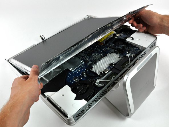

      • Lift the display from its lower edge and pull it toward yourself to peel it off the EMI shield attached to its top edge.
      • Be mindful of any cables that may get caught during removal.

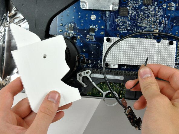

    1. iMac G5 17" Model A1144 PRAM Battery Replacement, Speakers: step 16, image 1 of 2 iMac G5 17" Model A1144 PRAM Battery Replacement, Speakers: step 16, image 2 of 2

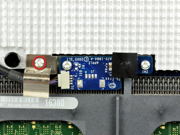

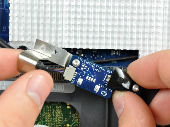

      • Remove the single 5 mm T6 Torx screw securing the IR board bracket to the logic board.
      • The IR board and cable finger are now free from the logic board and may fall.
      • Remove the IR cable finger and move the IR board, with cable still attached, out of the way.
      Ask FixBot

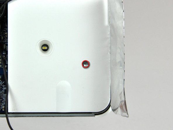

      • Remove the single 30 mm T10 Torx screw securing the left speaker to the rear case.
      • Pull the left speaker out of the rear case.

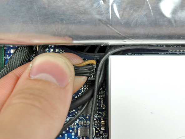

      • Disconnect the CPU fan connector from the logic board by pulling it straight up from its socket.

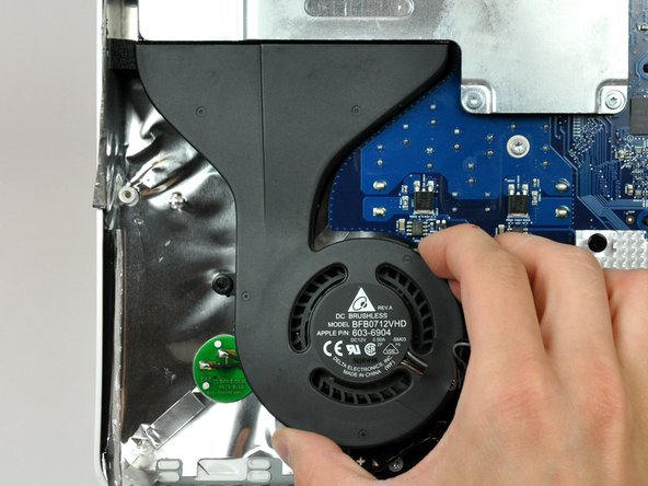

    2. iMac G5 17" Model A1144 PRAM Battery Replacement: step 22, image 1 of 1
      • Gently lift the CPU fan out of the rear case.

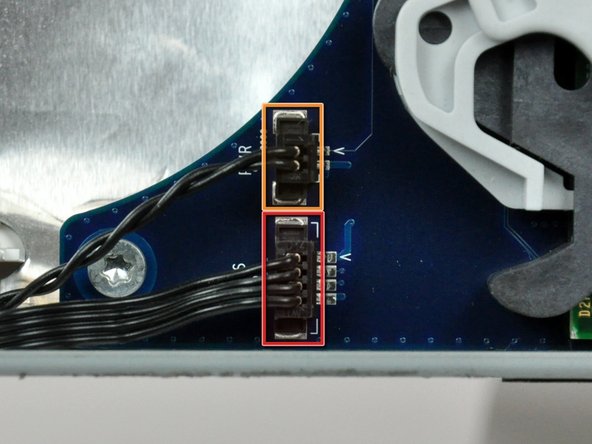

      • Disconnect the following connectors from the logic board by pulling them straight up from their sockets.:
      • Ambient light sensor cable.
      • Power cable.

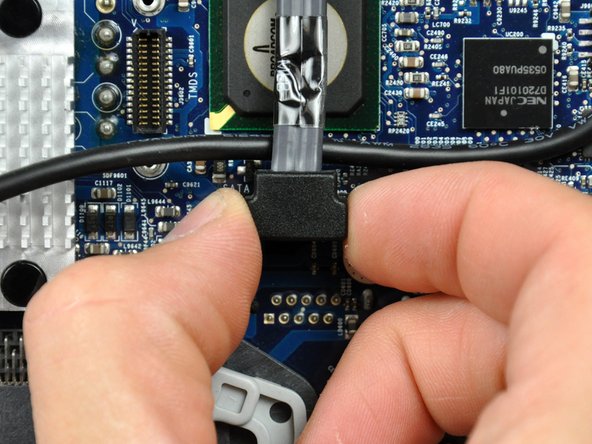

      • Disconnect the hard drive data cable connector from the logic board by pulling it straight up from its socket.
      • The SATA connector on most iMacs tends to stick in its socket on the logic board. If you are having trouble disconnecting the SATA cable, insert a metal spudger or any other thin tool into the gap between the SATA connector and its socket and twist the spudger's shaft to safely separate the two pieces.

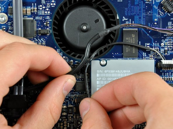

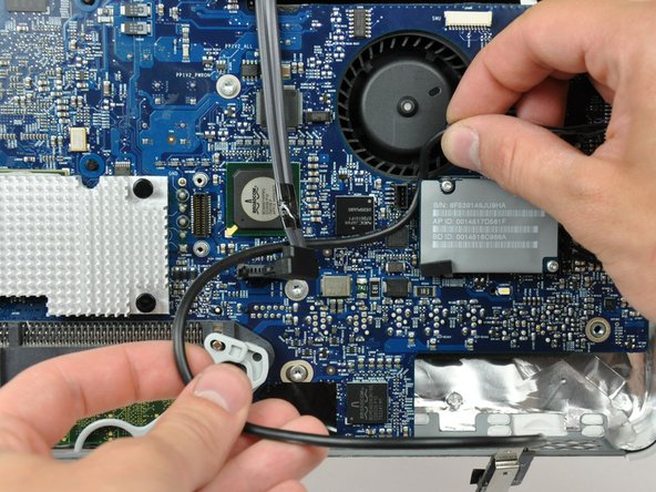

      • De-route the IR sensor cable from behind the AirPort Express card and set it aside.
      Ask FixBot

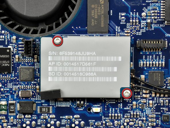

    6. iMac G5 17" Model A1144 PRAM Battery Replacement: step 26, image 1 of 2 iMac G5 17" Model A1144 PRAM Battery Replacement: step 26, image 2 of 2

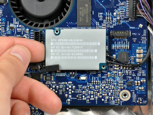

      • Remove two 5 mm T6 Torx screws securing the AirPort/Bluetooth board to the logic board.
      • Lift the AirPort/Bluetooth board up from its left edge to separate it from its socket on the logic board.
      • Lift the AirPort/Bluetooth board from its left edge only. Trying to lift from its right edge may break the connector off the logic board.
      Ask FixBot

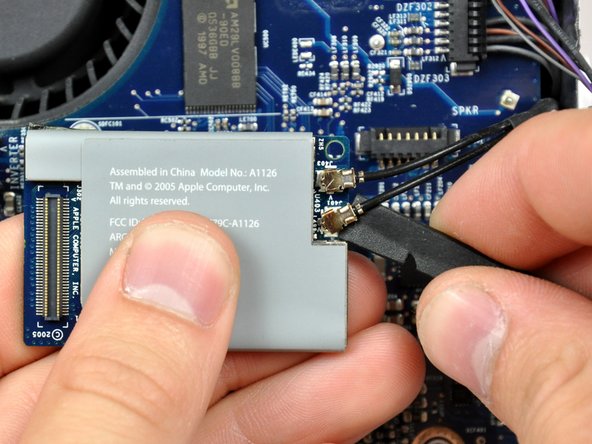

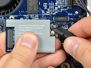

    7. iMac G5 17" Model A1144 PRAM Battery Replacement: step 27, image 1 of 2 iMac G5 17" Model A1144 PRAM Battery Replacement: step 27, image 2 of 2
      • Use the flat end of a spudger to pry both antenna cables up off the AirPort/Bluetooth board.
      • This step need not be done. Simply lay the card over the side.
      Ask FixBot

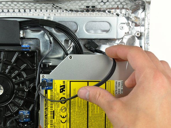

    9. iMac G5 17" Model A1144 PRAM Battery Replacement: step 29, image 1 of 1
      • Disconnect the optical drive fan cable connector from the logic board by pulling it straight away from its socket.
      Ask FixBot

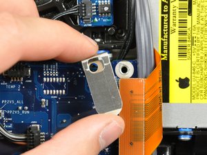

    10. iMac G5 17" Model A1144 PRAM Battery Replacement: step 30, image 1 of 2 iMac G5 17" Model A1144 PRAM Battery Replacement: step 30, image 2 of 2

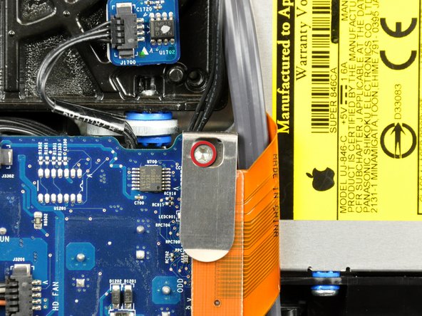

      • Remove the 7 mm T10 Torx screw securing the optical drive flex cable mounting bracket to the logic board.
      • Remove the flex cable mounting bracket.
      Ask FixBot

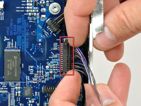

    11. iMac G5 17" Model A1144 PRAM Battery Replacement: step 31, image 1 of 1
      • Disconnect the optical drive flex cable from the logic board by pulling it straight up from its socket.
      Ask FixBot

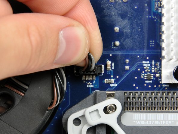

    13. iMac G5 17" Model A1144 PRAM Battery Replacement: step 33, image 1 of 1

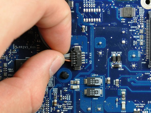

      • Disconnect the hard drive fan connector from the logic board by pulling it straight away from its socket.
      Ask FixBot

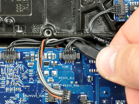

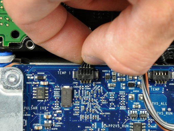

      • Use the tip of a spudger to lift the hard drive and optical drive thermal sensor cables for clearance.
      • Disconnect the optical drive temperature sensor connector from the logic board by pulling it straight away from its socket.
      Ask FixBot

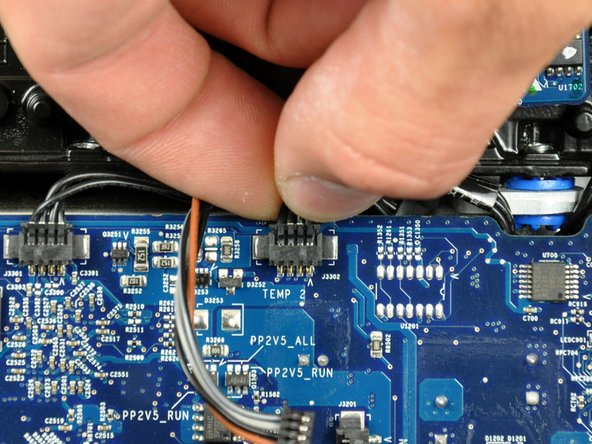

    15. iMac G5 17" Model A1144 PRAM Battery Replacement: step 35, image 1 of 1
      • Disconnect the hard drive temperature sensor connector from the logic board by pulling it straight away from its socket.
      Ask FixBot

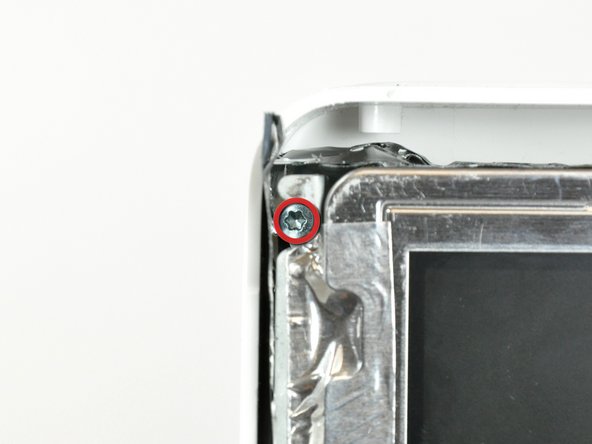

    16. iMac G5 17" Model A1144 PRAM Battery Replacement: step 36, image 1 of 1

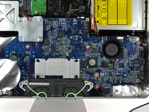

      • Remove the following screws securing the logic board to the rear case:
      • Four fine threaded 7 mm T10 Torx screws.
      • Three coarse threaded 7 mm T10 Torx screws.
      Ask FixBot

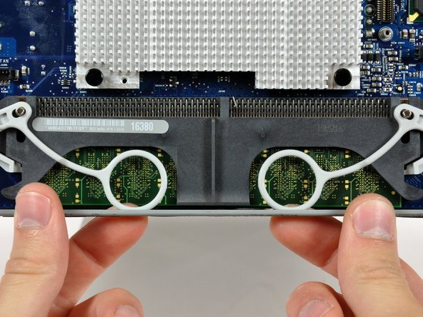

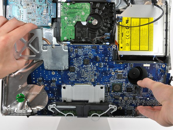

    17. iMac G5 17" Model A1144 PRAM Battery Replacement: step 37, image 1 of 2 iMac G5 17" Model A1144 PRAM Battery Replacement: step 37, image 2 of 2

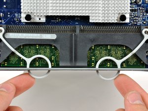

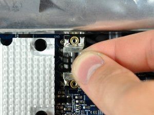

      • Push the two RAM arms protruding from the access door inward and set them on the lower edge of the rear case to prevent them from getting caught when removing the logic board.
      Ask FixBot

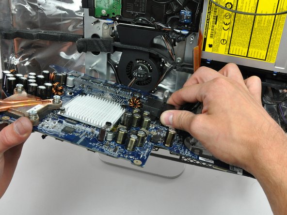

    18. iMac G5 17" Model A1144 PRAM Battery Replacement: step 38, image 1 of 2 iMac G5 17" Model A1144 PRAM Battery Replacement: step 38, image 2 of 2
      • Grab the logic board and pull it toward yourself slightly to separate the jacks from the rear case.
      • Rotate the top of the logic board toward yourself slightly to gain access to the DC power cable connector.
      • Do not completely remove the logic board as the DC power cable connector is still connected to the underside of the board.
      Ask FixBot
    19. iMac G5 17" Model A1144 PRAM Battery Replacement: step 39, image 1 of 1
      • While grasping the logic board with one hand, disconnect the DC power cable connector from the logic board by pulling it straight away from its socket.
      • It may be helpful to wiggle the connector while pulling it.

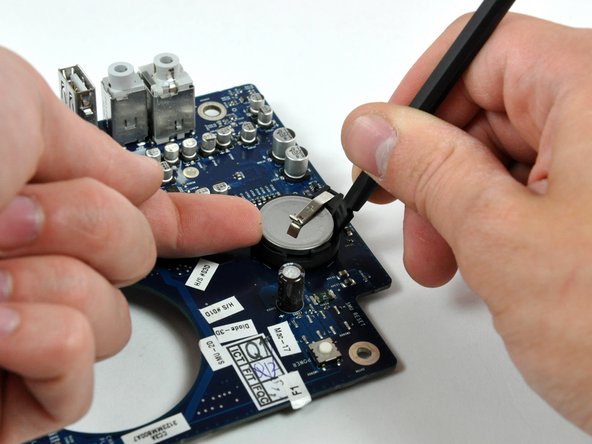

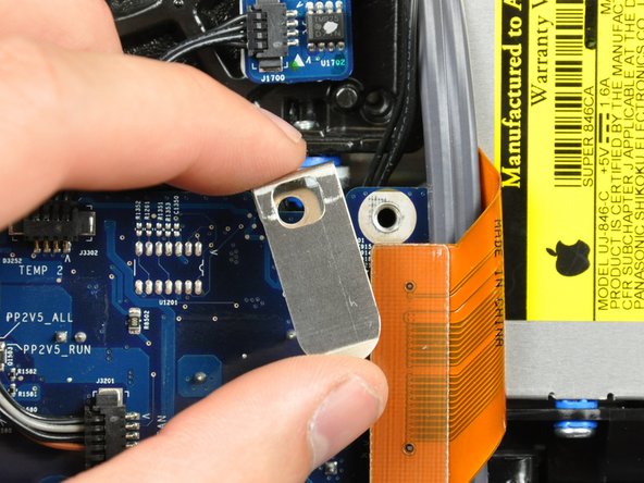

    1. iMac G5 17" Model A1144 PRAM Battery Replacement, PRAM Battery: step 40, image 1 of 1
      • Lift the edge of the PRAM battery slightly with your fingertip and use a spudger to slide the PRAM battery out from under its socket's metal clip.
      • Do not bend the metal clip up, as it is brittle and will break.
      Ask FixBot
