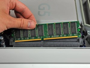

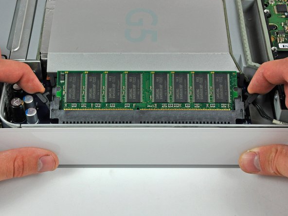

    1. iMac G5 17" Model A1058 RAM Replacement, RAM: step 3, image 1 of 3 iMac G5 17" Model A1058 RAM Replacement, RAM: step 3, image 2 of 3 iMac G5 17" Model A1058 RAM Replacement, RAM: step 3, image 3 of 3
      • Rotate each of the two RAM retaining arms away from the RAM chip.
      • Pull the RAM chip straight away from its socket.
      • Repeat this process for the other RAM chip.
      • Be sure the RAM arms are fully rotated away from the RAM socket before reinstalling any RAM chips.
