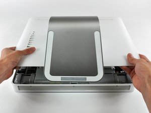

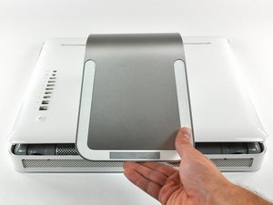

    2. iMac G5 17" Model A1058 PRAM Battery Replacement: step 2, image 1 of 3 iMac G5 17" Model A1058 PRAM Battery Replacement: step 2, image 2 of 3 iMac G5 17" Model A1058 PRAM Battery Replacement: step 2, image 3 of 3
      • Lift the rear panel slightly from the bottom edge of the iMac.
      • Pull the rear panel toward yourself and remove it from the iMac.
      Ask FixBot
