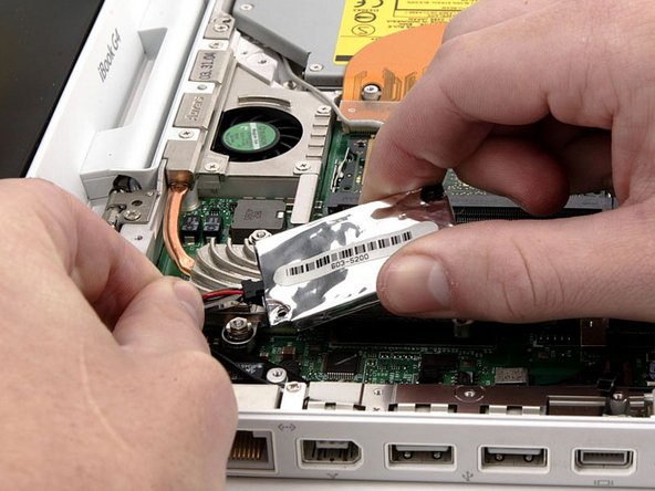

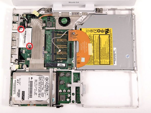

    1. iBook G4 12" 800 MHz-1.2 GHz Display Assembly Replacement, Modem: step 36, image 1 of 1
      • Due to variations between iBook G4 models, your modem may look slightly different from the picture. All of the following steps apply to either model.
      • Remove the two Phillips screws at the corners of the modem.
      Ask FixBot

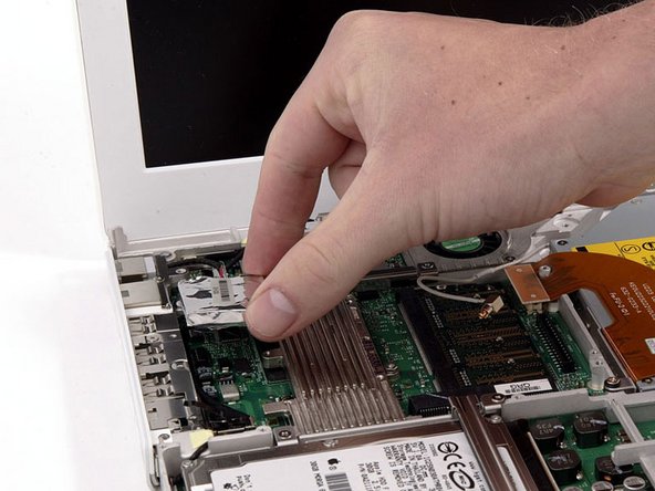

    2. iBook G4 12" 800 MHz-1.2 GHz Display Assembly Replacement: step 37, image 1 of 1
      • Lift the modem and modem shield from the bottom.
      Ask FixBot

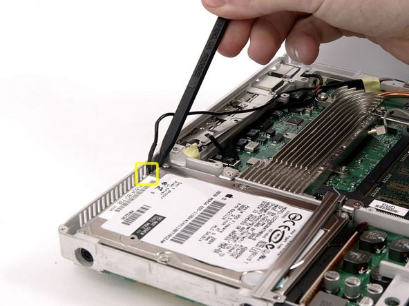

    1. iBook G4 12" 800 MHz-1.2 GHz Display Assembly Replacement, Display Assembly: step 39, image 1 of 1
      • Turn the computer over.
      • Disconnect the inverter cable from the logic board and deroute it from the metal framework, removing tape as necessary.

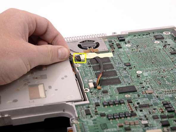

    3. iBook G4 12" 800 MHz-1.2 GHz Display Assembly Replacement: step 41, image 1 of 1
      • Use the black plastic handle to disconnect the display data cable from the logic board.
      Ask FixBot

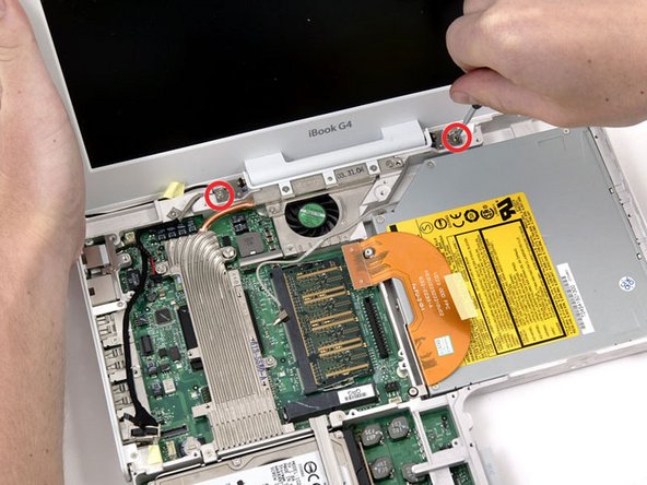

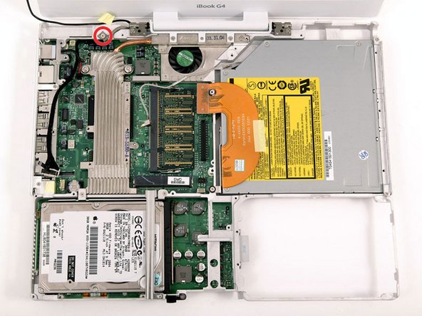

    5. iBook G4 12" 800 MHz-1.2 GHz Display Assembly Replacement: step 43, image 1 of 1
      • Support the display with one hand and remove the single Phillips screw on either side of the hinge (two screws total).
      • The screws go in the outer holes on each side (you can see the threads in the correct hole).
      • It may be necessary to unscrew one side of the optical drive for enough clearance to thread the AirPort antenna through the gap between the body of the optical drive and the iBook's internal frame.
      • When remounting, mind that cables pass under the hinge, not over

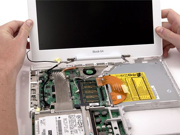

    6. iBook G4 12" 800 MHz-1.2 GHz Display Assembly Replacement: step 44, image 1 of 1
      • Tilt the display back, freeing it from the two metal alignment posts holding the hinges in place, and slide it away from you.
