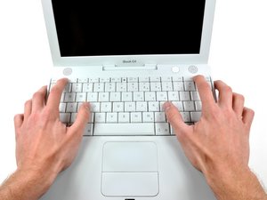

Replacing this keyboard is easy and takes only a few minutes.

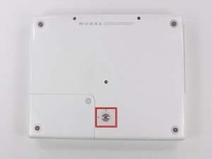

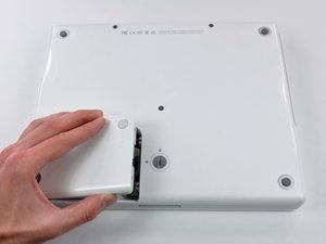

    1. iBook G4 12" 1.33 GHz Keyboard Replacement, Battery: step 1, image 1 of 2 iBook G4 12" 1.33 GHz Keyboard Replacement, Battery: step 1, image 2 of 2
      • Lay your iBook upside down on a flat surface.
      • Use a coin to rotate the battery locking screw 90 degrees clockwise.

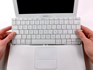

    1. iBook G4 12" 1.33 GHz Keyboard Replacement, Keyboard: step 2, image 1 of 2 iBook G4 12" 1.33 GHz Keyboard Replacement, Keyboard: step 2, image 2 of 2
      • Pull the keyboard release tabs toward you and lift up on the keyboard until it pops free.
      • If the keyboard does not come free, use a small flathead screwdriver to turn the keyboard locking screw 180 degrees in either direction and try again.
      • Flip the keyboard over, away from the screen, and rest it face-down on the trackpad area.

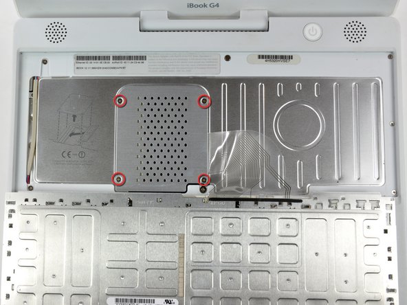

    2. iBook G4 12" 1.33 GHz Keyboard Replacement: step 3, image 1 of 1
      • Remove the four silver Phillips screws that secure the RAM shield.
      Ask FixBot
    3. iBook G4 12" 1.33 GHz Keyboard Replacement: step 4, image 1 of 1
      • Pull the keyboard cable up from the logic board, holding the cable as close to the connector as possible.
      • Make sure that you reconnect the keyboard cable before replacing the RAM shield.
