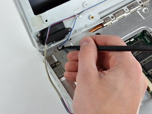

    5. iBook G4 12" 1.33 GHz Hard Drive Replacement: step 26, image 1 of 1
      • The connectors at the ends of the following cables are attached very firmly to the sockets on the logic board. Pulling directly on the cable will either separate the cable from its connector or the socket from the logic board.
      • Use the sharp end of a spudger to disconnect the speaker cable connector.
      Ask FixBot

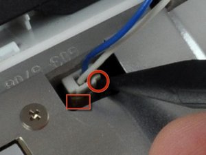

    6. iBook G4 12" 1.33 GHz Hard Drive Replacement: step 27, image 1 of 2 iBook G4 12" 1.33 GHz Hard Drive Replacement: step 27, image 2 of 2
      • Using the sharp end of a spudger, disconnect the connector for the blue and white power cables. Again, be careful to pry up only on the connector.
      • It is very easy to break the connector from the board, so be careful.
      • The key is to apply force in two directions, down to keep the surface board connections intact, up to release the connector.
      • The upper case is now free and can be removed from the computer.

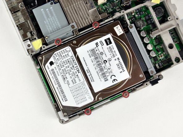

    2. iBook G4 12" 1.33 GHz Hard Drive Replacement: step 31, image 1 of 1
      • Remove the four Phillips screws securing the hard drive to the metal framework.
      Ask FixBot
    3. iBook G4 12" 1.33 GHz Hard Drive Replacement: step 32, image 1 of 1
      • Slightly lift the hard drive from the free end and pull the hard drive straight away from the connector.
      Ask FixBot

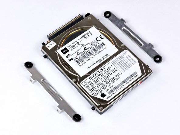

    1. iBook G4 12" 1.33 GHz Hard Drive Replacement, Hard Drive: step 33, image 1 of 1
      • Remove the hard drive brackets from the left and right sides of the hard drive.
      Ask FixBot

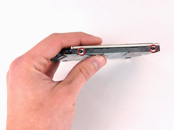

    2. iBook G4 12" 1.33 GHz Hard Drive Replacement: step 34, image 1 of 1
      • Remove the two black T8 Torx screws from either side of the hard drive (four screws total).
      Ask FixBot

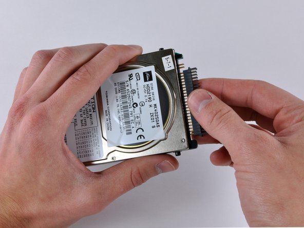

    3. iBook G4 12" 1.33 GHz Hard Drive Replacement: step 35, image 1 of 1
      • Pull the plastic hard drive connector straight away from the hard drive.
      • This is a bit tricky. Try rocking the connector gently while pulling with even pressure. If you bend the pins, do your best to straighten them, using the hard drive connector as a guide.
      • Hard drive remains.
