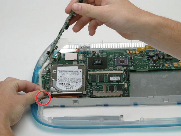

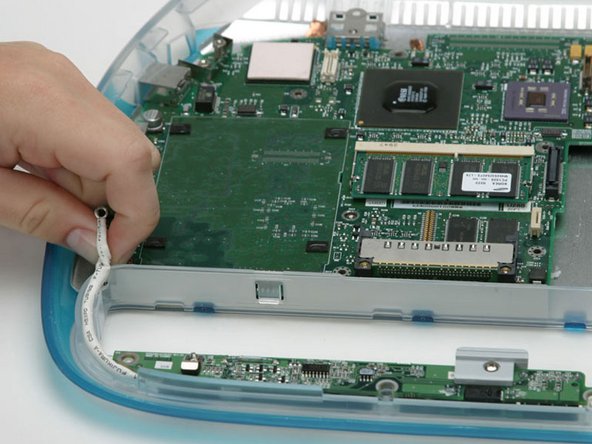

    3. iBook G3 Clamshell Lower Case Replacement: step 31, image 1 of 1
      • Deroute the speaker cable from the metal framework and disconnect it from the logic board.
      Ask FixBot

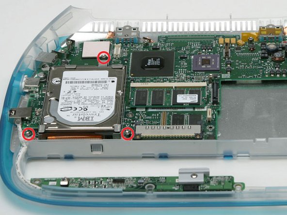

    1. iBook G3 Clamshell Lower Case Replacement, Hard Drive: step 37, image 1 of 1
      • Remove the three 5 mm standoffs securing the hard drive to the logic board.
      Ask FixBot

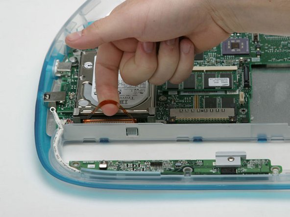

    2. iBook G3 Clamshell Lower Case Replacement: step 38, image 1 of 1
      • Pull the hard drive cable up from the logic board, using the plastic loop.
      • Lift the hard drive, with metal bracket attached, from the logic board.

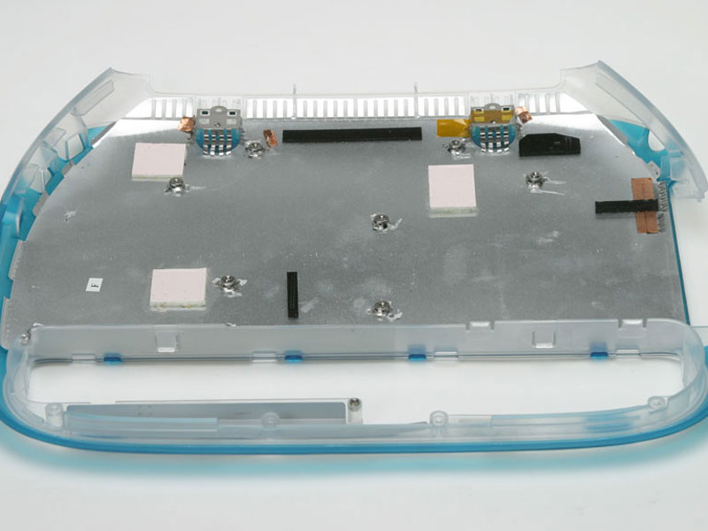

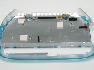

    1. iBook G3 Clamshell Lower Case Replacement, Lower Case: step 42, image 1 of 1
      • Lower case remains.
