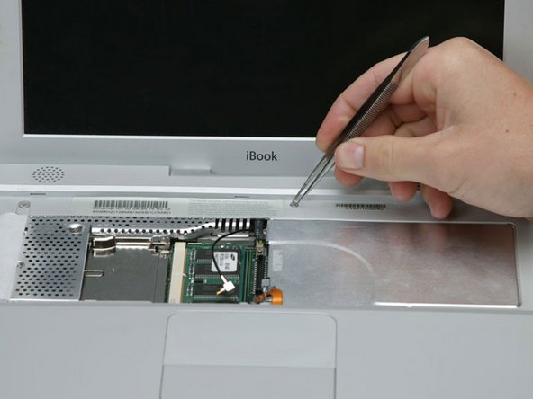

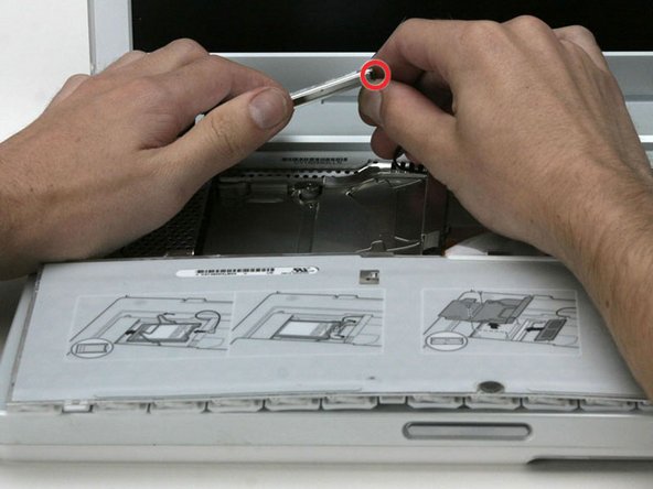

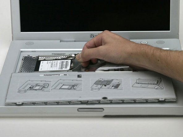

    1. iBook G3 14" DC-In Board Replacement, Keyboard: step 2, image 1 of 1
      • Pull the keyboard release tabs (highlighted in red) toward you and lift up on the keyboard until it pops free.
      • If the keyboard does not come free, use a small flathead screwdriver to turn the keyboard locking screw 180 degrees in either direction and try again.
      • Flip the keyboard over, away from the screen, and rest it face-down on the trackpad area.

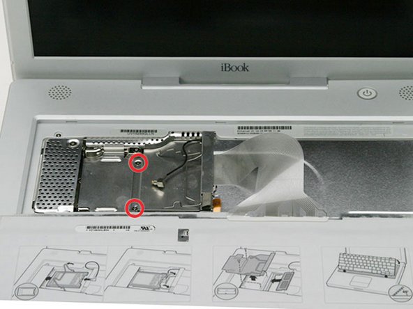

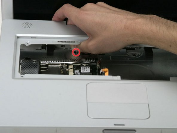

    5. iBook G3 14" DC-In Board Replacement: step 6, image 1 of 1
      • Remove the two Phillips screws that secure the RAM shield.
      Ask FixBot

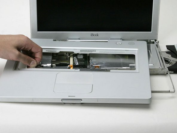

    6. iBook G3 14" DC-In Board Replacement: step 7, image 1 of 1
      • Grasp the metal bracket on top of the RAM shield and pull upward to remove the shield.
      Ask FixBot
    7. iBook G3 14" DC-In Board Replacement: step 8, image 1 of 1

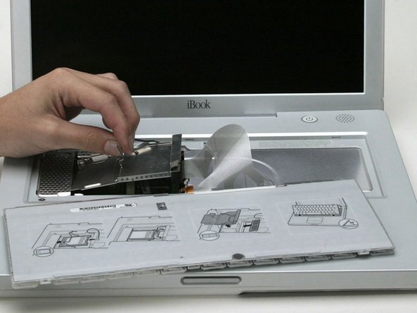

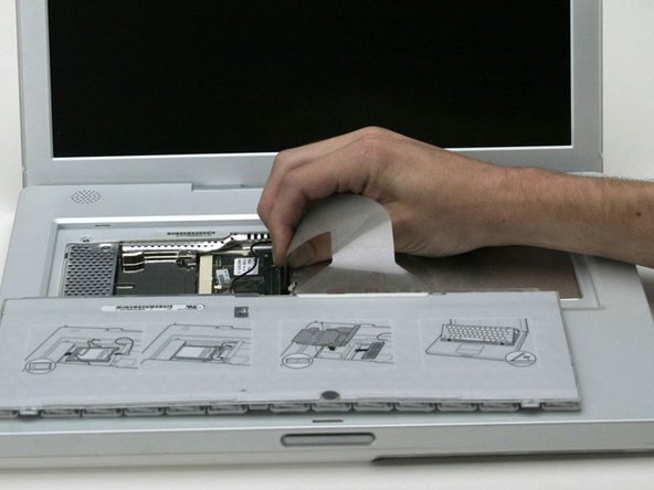

      • Pull the keyboard cable up from the logic board, holding the cable as close to the connector as possible.
      Ask FixBot

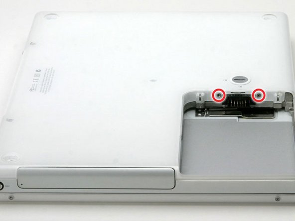

    5. iBook G3 14" DC-In Board Replacement: step 13, image 1 of 1

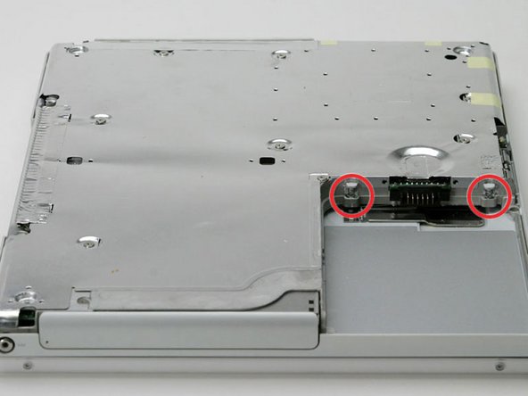

      • Remove the two Phillips screws on either side of the battery contacts.
      Ask FixBot

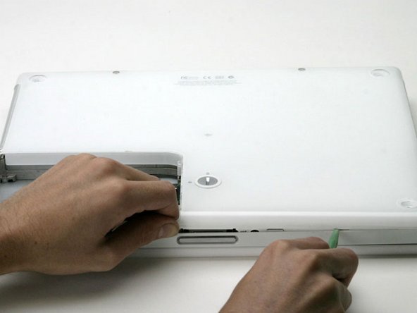

    6. iBook G3 14" DC-In Board Replacement: step 14, image 1 of 1
      • Breathe deeply. Trying times are ahead, but we promise the lower case does come off.
      • Push the thin rims of the lower case surrounding the battery compartment in, bending them past the tabs, and then lift up to free that corner of the lower case.
      Ask FixBot

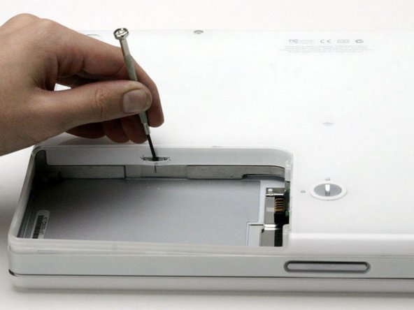

      • There is a slot on the wall of the battery compartment that locks the lower case in place.
      • Use a small flathead screwdriver to pry out the slot's lower rim and pull up on the lower case to free the slot from the tabs holding it.

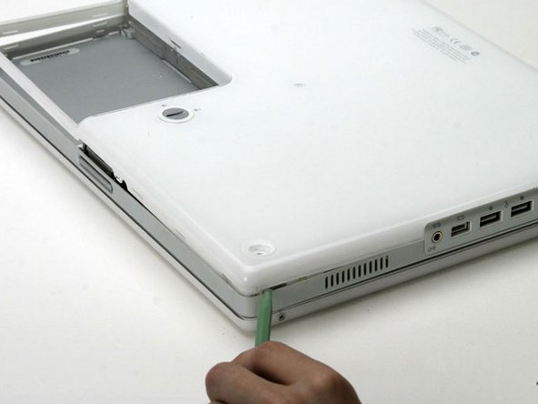

    8. iBook G3 14" DC-In Board Replacement: step 16, image 1 of 1
      • Run a spudger along the seam between the lower case and upper case on the front of the computer to free the tabs locking the lower case.
      • Pull up on the lower case and continue to use the spudger as necessary until you hear three distinct clicks.
      Ask FixBot

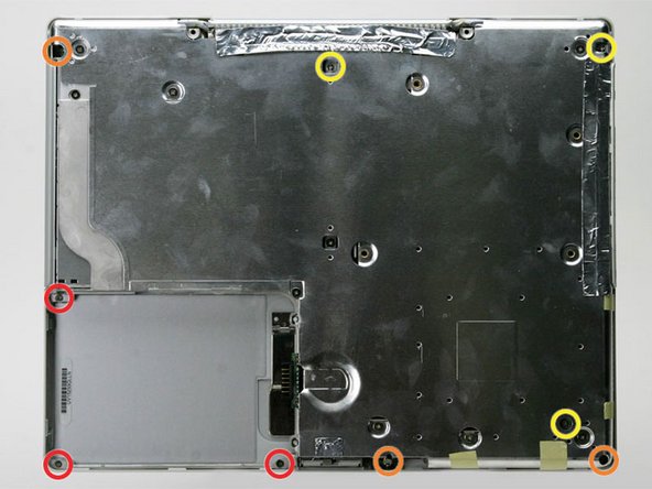

    1. iBook G3 14" DC-In Board Replacement, Upper Case: step 20, image 1 of 1
      • All of the screws in the following step have small heads - the screws with larger heads hold the bottom shield on.
      • Remove the following 9 screws on the bottom of the computer:
      • Three 3 mm Phillips around the battery compartment.
      • Three 5 mm Phillips on the left and bottom edges.
      • Three 14.5 mm Phillips on the top and right edges (you may have to peel back the foil tape to reveal the screw near the security lock slot).
      Ask FixBot

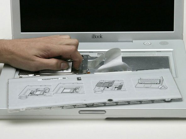

    2. iBook G3 14" DC-In Board Replacement: step 21, image 1 of 1
      • Turn over the computer and open it.

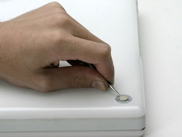

      • Pry up the magnet covering a Phillips screw near the middle of the computer.
      • You may need to peel back the serial number sticker to access the magnet.
      Ask FixBot

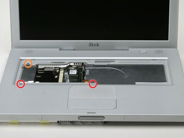

    3. iBook G3 14" DC-In Board Replacement: step 22, image 1 of 1
      • Remove the following 3 screws on the edges of the keyboard area:
      • Two 6 mm Phillips underneath the keyboard area.
      • One 9 mm Phillips above the keyboard area.
      • On some models, there may also be a screw under the magnet you just removed. If so, remove the screw at this point.

      • Use a straightened paperclip to open the optical drive tray, and pull it out about halfway.
      Ask FixBot

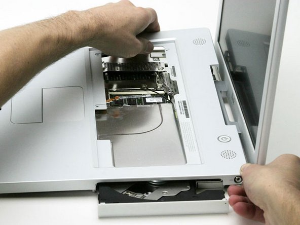

      • Don't lift the upper case off the computer yet as there are still two cables left to disconnect.
      • Lift the upper case from the left side and use your other hand to pull out the right side in order to clear the power receptacle.
      Ask FixBot

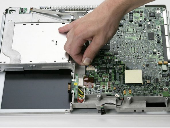

    8. iBook G3 14" DC-In Board Replacement: step 27, image 1 of 1
      • The connectors at the ends of the cables are attached very firmly to the sockets on the logic board. Pulling directly on the cable will either separate the cable from its connector or the socket from the logic board.
      • Lift the upper case enough to disconnect the blue and white power cable from the logic board.
      • Using your fingernails or a dental pick, carefully pry the connector from its socket.
      • Make sure you are pulling only on the connector and not on the socket.
      Ask FixBot

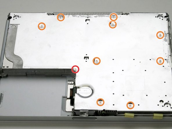

    1. iBook G3 14" DC-In Board Replacement: step 30, image 1 of 1
      • Remove the following 10 screws:
      • One 5 mm Phillips at the upper, right corner of the battery compartment.
      • Nine 6 mm Phillips scattered around the shield.
      • Lift the bottom shield off.
      Ask FixBot
