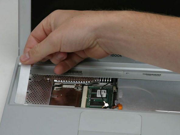

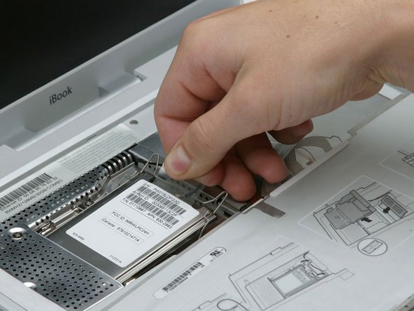

      • If the computer does not have an Airport card installed, skip the next two steps.
      • Push the wire clasp toward the Airport card and pull it up to free it from the RAM shield.
      Ask FixBot

      • Grasp the metal bracket on top of the RAM shield and pull upward to remove the shield.
      Ask FixBot

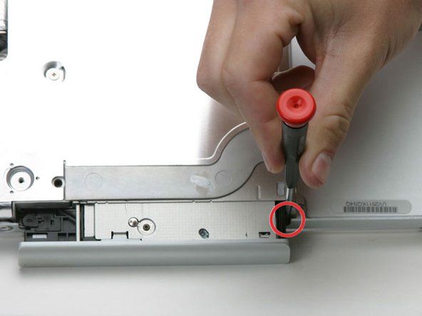

    3. iBook G3 12" Hard Drive Replacement: step 23, image 1 of 1
      • Pull the optical drive out just enough so that you can access and remove a Phillips screw near the battery compartment.
      Ask FixBot
    4. iBook G3 12" Hard Drive Replacement: step 24, image 1 of 1
      • Pull the optical drive a bit more so that you can access and remove a second Phillips screw near the power receptacle.
      Ask FixBot

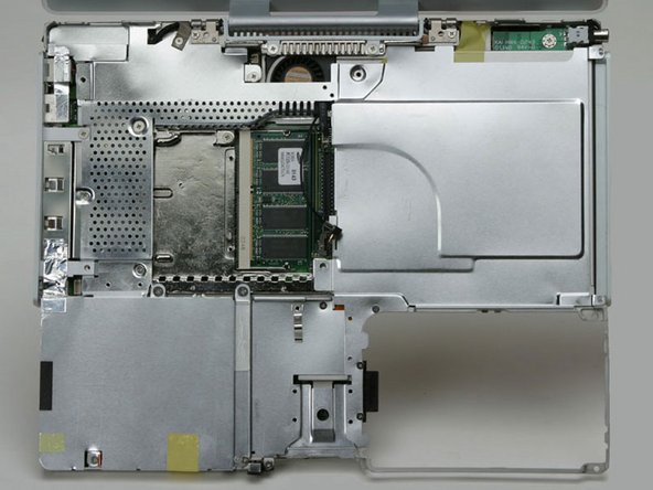

    1. iBook G3 12" Hard Drive Replacement, Top Shield: step 34, image 1 of 1
      • Your laptop should look approximately like this.
      Ask FixBot

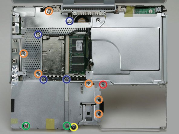

      • Remove the following 14 screws (some models may be missing a couple of screws):
      • One 2.5 mm Phillips.
      • Six 3.5 mm Phillips.
      • One 4.5 mm Phillips near the sleep light with a small shaft.
      • Two 4.5 mm Phillips with larger shafts.
      • Four 5 mm Phillips
      • If a screw is inserted in the left hole, the 14.2 mm screw in step 24 can not be inserted to hold the top case down.
      Ask FixBot

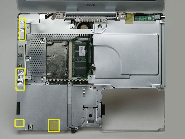

    3. iBook G3 12" Hard Drive Replacement: step 36, image 1 of 1
      • Peel back three strips of yellow tape in the bottom left corner.
      • Peel back one strip of foil tape in the upper left corner and another near where the trackpad connects to the logic board.
      Ask FixBot

      • Lift the top shield up from the right side, minding the upper left corner, which may catch on the metal framework.
      Ask FixBot

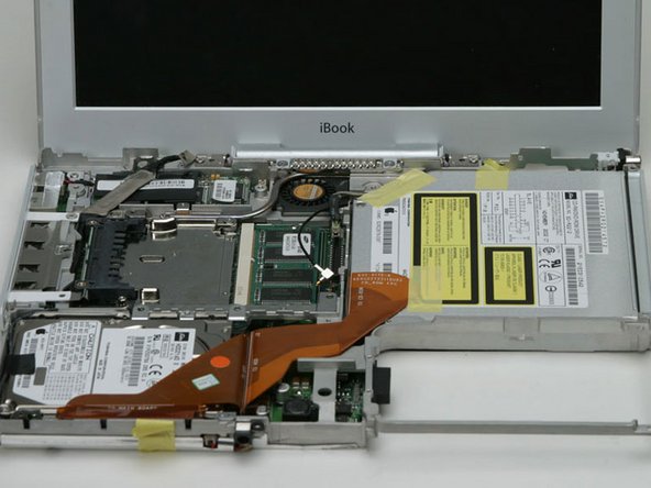

    1. iBook G3 12" Hard Drive Replacement, Hard Drive: step 38, image 1 of 1
      Ask FixBot

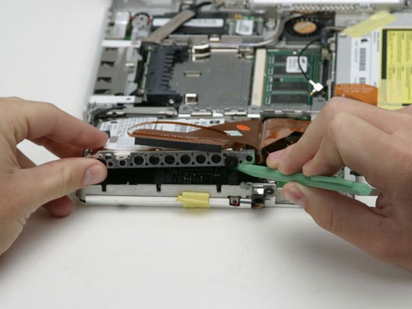

      • Use the transparent orange loop to disconnect the large orange ribbon cable from the logic board.
      Ask FixBot

    4. iBook G3 12" Hard Drive Replacement: step 41, image 1 of 1
      • Use the transparent orange loop to disconnect the hard drive ribbon cable from the hard drive.
      • This is a bit tricky. Try rocking the cable gently from side to side while applying even pressure. If you bend the pins, do your best to straighten them, using the hard drive cable as a guide.
      Ask FixBot
    5. iBook G3 12" Hard Drive Replacement: step 42, image 1 of 1
      Ask FixBot

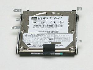

    1. iBook G3 12" Hard Drive Replacement, Hard Drive: step 43, image 1 of 1
      • Your hard drive should look approximately like this.
      Ask FixBot

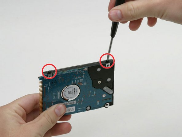

    2. iBook G3 12" Hard Drive Replacement: step 44, image 1 of 1
      • Remove the metal brackets from either side of the hard drive (if they're still there).
      • With the pins facing away from you, and the label facing up, the bracket with a tab in the middle and a metal slot on it goes on the left side of the drive; the other bracket, of course, goes on the right.
      • Remove two T8 Torx screws from either side of the hard drive (four screws total).
      Ask FixBot
