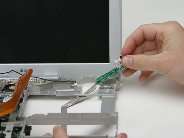

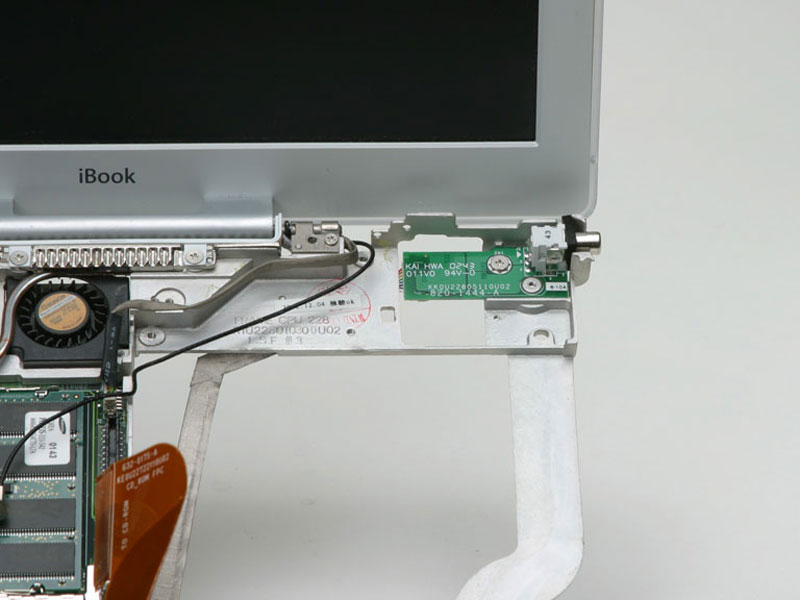

    1. iBook G3 12" DC-In Board Replacement, DC-In Board: step 48, image 1 of 1
      • Your laptop should look approximately like this.
      Ask FixBot
    2. iBook G3 12" DC-In Board Replacement: step 49, image 1 of 1
      • Remove the single 5.5 mm Phillips screw securing the DC-In board to the metal framework.
      Ask FixBot
    3. iBook G3 12" DC-In Board Replacement: step 50, image 1 of 1
      • Peel up the DC-In cable from the bottom of the metal framework and pull it through the conveniently-located nearby hole.
