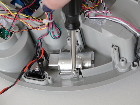

    3. bObi Pet UV Lamp Replacement, Remove the Lamp: step 9, image 1 of 3 bObi Pet UV Lamp Replacement, Remove the Lamp: step 9, image 2 of 3 bObi Pet UV Lamp Replacement, Remove the Lamp: step 9, image 3 of 3
      • Next, remove the 2 screws on the UV lamp.
      • Gently push the UV lamp out of its spot from underneath.
      • Then, lift out the whole lamp, including the cover plate.
      Ask FixBot
