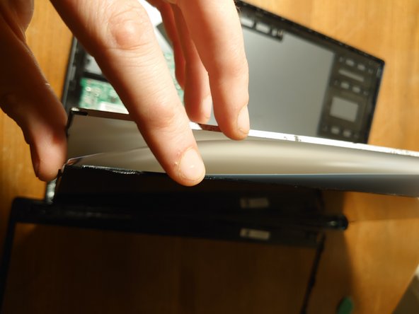

A very amateur and very brief opening up of a zenscreen MB16AC in order to remove some water from the screen. This is the first time I’ve posted up a guide, and am by no means an expert so treat with caution.
Unfortunately I did not take photos until after finishing, but before undertaking this the screen was covered in bright and dark spots and streaks from water trapped inside. After opening up and removing water, the screen does seem much clearer.

    2. Zenscreen MB16AC Disassembly/ Water Damage Guide, Remove bezel: step 2, image 1 of 2 Zenscreen MB16AC Disassembly/ Water Damage Guide, Remove bezel: step 2, image 2 of 2
      • After removing the bezel the screen can be lifted away. It is connected at the bottom of the screen.
      Ask FixBot
    3. Zenscreen MB16AC Disassembly/ Water Damage Guide, Opening the screen (and removing water): step 3, image 1 of 2 Zenscreen MB16AC Disassembly/ Water Damage Guide, Opening the screen (and removing water): step 3, image 2 of 2
      • The screen can be lifted away. It is still connected in these photos.
      • The screen was sealed around the edges with a black tape. In the photos here it has already been mostly peeled away.
      • The screen itself is comprised of several layers of... sheets of plasticy stuff. Anti-glare layer, protective films, lcd sheet, etc. If you have water trapped in there like me, you should be able to get inbetween the various layers and carefully remove. I'm not expert here, so suggest you google the best type of treatment to use.
      Ask FixBot
    4. Zenscreen MB16AC Disassembly/ Water Damage Guide, Closing up: step 4, image 1 of 1
      • Unfortunately I didn't take a 'before' photo, so you will just have to take my word for it that this is significantly improved. It has been surprisingly effective given that I was about to order a replacement screen.
      • However I was not able to reseal the screen properly, if anybody knows what type of tape to use please suggest in comments. Regular electrical tape doesn't seem to be sticky enough to do the trick. The bezel seems to be holding the screen in place for now though.

BE CAREFUL FOR MB16ACV USERS! THERE IS GLUE ON THE BEZEL. Other than that, it is the same. Works the same on the MB16ACV
