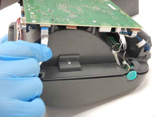

    • Remove the three 12mm screws from the bottom of the printer using a Phillips #1 screwdriver.
    • Using the TR10 Torx screwdriver, remove the four 8mm screws from the bottom of the device.
    Ask FixBot
  2. Zebra ZP 450 Motherboard Replacement: step 2, image 1 of 1
    • Remove the single 7mm screw located underneath the outfeed using the same Phillips #1 screwdriver.
    Ask FixBot
  3. Zebra ZP 450 Motherboard Replacement: step 3, image 1 of 1
    • Using an opening pick, pry the plastic covering from around the power button and accessory ports.
    Ask FixBot
  4. Zebra ZP 450 Motherboard Replacement: step 4, image 1 of 3 Zebra ZP 450 Motherboard Replacement: step 4, image 2 of 3 Zebra ZP 450 Motherboard Replacement: step 4, image 3 of 3
    • After lifting the plastic casing from the device, use the Phillips #1 screwdriver to remove the single 5mm screw securing the motherboard.
    • Remove all connections to the motherboard.
