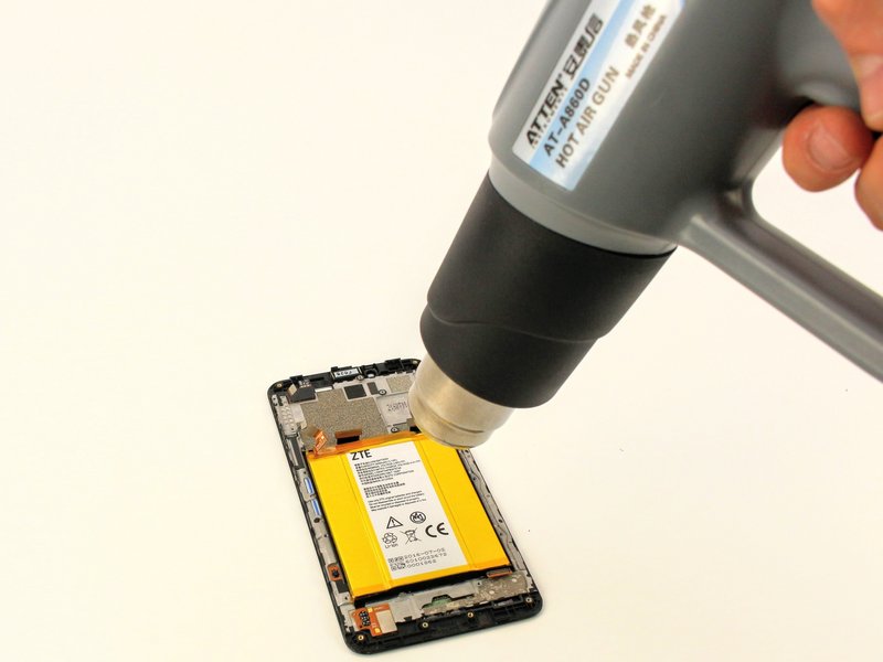

    3. ZTE ZMax Pro Battery Replacement: step 16, image 1 of 1
      • Use a heat gun to heat the adhesive under the battery.
      • Heat the battery for 1 minute then check if it is pliable. If needed, heat in intervals of 10 seconds until the battery can be removed.
      • Over heating the battery can cause the battery to explode. Exercise caution heating the battery.
      Ask FixBot

Also note, I couldn't remove the last screw off the motherboard. It was too tightly inserted and was stripping by attempts. I turned my phone face down with gorilla glass against a heating pad on a low setting for just a few minutes to warm the adhesive on the battery. Keep the top section with the motherboard off the heating pad. This was the easiest thing to remove. Use a plastic spatula not a metallic one.
