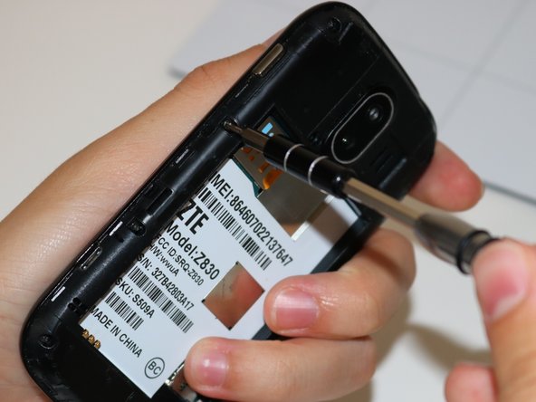

  4. ZTE Compel Speaker Replacement, Speaker: step 4, image 1 of 2 ZTE Compel Speaker Replacement, Speaker: step 4, image 2 of 2
    • Remove the 9 screws that measure 4 mm Phillips. Use your PH000 screwdriver attachment.
    • Use your iFixit Magnetic Project Mat to hold your removed screws while working on your ZTE Compel
