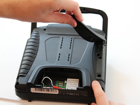

    1. Yuneec ST10 Plus Screen Replacement, Screen: step 4, image 1 of 2 Yuneec ST10 Plus Screen Replacement, Screen: step 4, image 2 of 2
      • Slide the Jimmy underneath the rubber grips and pry upwards.
      • With your free hand grasp the rubber grips and pull upward to remove it.
      Ask FixBot

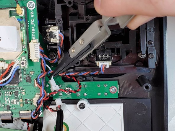

    10. Yuneec ST10 Plus Screen Replacement: step 13, image 1 of 2 Yuneec ST10 Plus Screen Replacement: step 13, image 2 of 2
      Tool used on this step:
      Buy
      • Using the tweezers, disconnect your screen connection wires.
      Ask FixBot

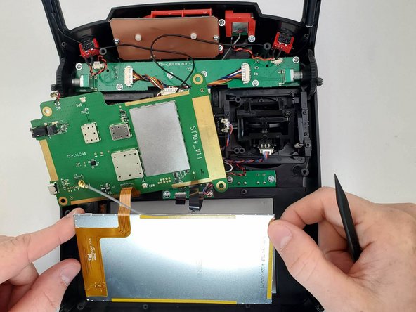

    11. Yuneec ST10 Plus Screen Replacement: step 14, image 1 of 2 Yuneec ST10 Plus Screen Replacement: step 14, image 2 of 2
      • Using too much force will destroy screen plate.
      • There is a location on the upper right hand corner, where you can use the spudger to gently pry the screen up.
      • Remove the screen.
      Ask FixBot
