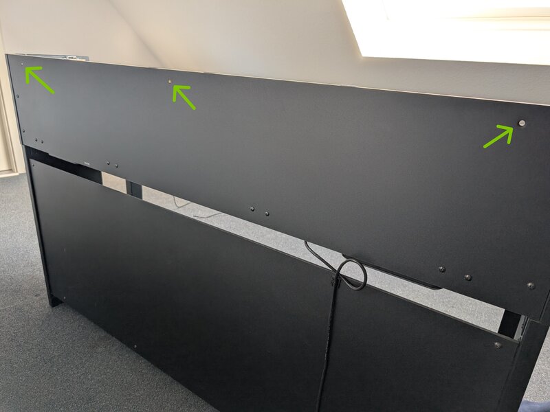

If your Yamaha piano has the apparently common problem that some keys sometimes sound as if they have been pressed with maximal force/speed even though they have been pressed normally, there might be dust particles between the silicone mats and the printed circuit board (PCB) contacts. This can be mitigated by disassembling the piano and cleaning all silicone mats and PCB contacts.
This guide is just an adaptation of the following comprehensive video instruction to the CLP-645: https://www.youtube.com/watch?v=LbRkqGUm...
    1. Yamaha CLP-645 - Cleaning Note Key Contacts, Remove Top Cover: step 1, image 1 of 2 Yamaha CLP-645 - Cleaning Note Key Contacts, Remove Top Cover: step 1, image 2 of 2
      • Remove these three screws at the top of the back side.
      • Push the top cover to the front side. It is locked on the inside with a slide mechanism.
      • There is a cable connected to the top cover. Lift the cover carefully and disconnect the cable.
