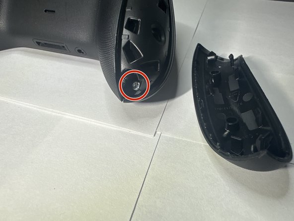

    • After removing the grip plates, remove the 5 screws holding the front plate.
    • Use a T8H sized Torx Safety bit for these screws.
    • The screws are shown in the picture with two in each grip and one in the battery bay.
    • The battery bay screw is underneath the sticker. You can either poke through it with your tool or peel it away.

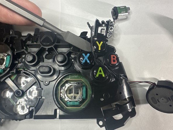

    • Place your spudger as shown and gently peel the sync button plate off using the same method as before.
    • Remove the plate and place it off to the side for later.

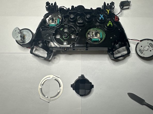

  11. Xbox Series X Wireless Controller (Model 1914) Joystick Replacement: step 11, image 1 of 1
    • Next is the grip rumble weights.
    • Simply using your hands or forceps, remove the weights by sliding them towards you and lifting them out.
    • These weights are also connected by wires, keep this in mind when removing them.
  12. Xbox Series X Wireless Controller (Model 1914) Joystick Replacement: step 12, image 1 of 2 Xbox Series X Wireless Controller (Model 1914) Joystick Replacement: step 12, image 2 of 2
    • With both set of rumble weights out of the way, next is the board screws.
    • Using the T6 bit screwdriver, unscrew the screws located on next to where the grip rumble weights were.
    • Set these screws aside for now.

    • Find the D-pad plate surrounding the outer rim of the D-pad.
    • Using your spudger, slide it underneath the piece and pull it up from the controller.
    • The D-pad plate is attached at the top and bottom parts of the rim. Keep this in mind when applying pressure to remove this piece. Try to keep the pressure around those areas.
    • Remove the plate and set it to the side.
    • Remove the D-pad from the controller and set aside for now.

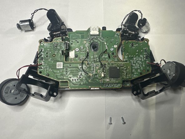

    • This step involves flipping over the controller to continue but the motherboard is no longer connected to the controller frame, so when flipping it over, keep the loose parts together.
    • Isolate the motherboard. It will be attached to the joysticks.
    • Lay the board flat and observe for any debris or clear obstructions.
  16. Xbox Series X Wireless Controller (Model 1914) Joystick Replacement: step 16, image 1 of 2 Xbox Series X Wireless Controller (Model 1914) Joystick Replacement: step 16, image 2 of 2
    • Flip the board over.
    • Locate the joystick solder nubs on the back of the bottom of the board.
    • Using the soldering iron, heat it up to around 350-375 degrees Fahrenheit and lay the tip on the aforementioned nubs.
    • Hold it for around 5-7 seconds or until the solder nub liquefies. Repeat this for the rest of the nubs.
    • Having done this, the joystick should slide out the board. Install the replacement joystick by sliding in the joystick prongs into the slots that the old joystick sat in.
    • If the replacement joystick does not slide in properly, check the prongs to make sure they are aligned with the slots.
    • With the joystick in, solder the prongs until they are secured into place on the boards.

Granted I've only ever soldered and desoldered keyboards before, but I'm relatively sure that this is impossible without a hot air reflow station. Keeping all 10 solder joints hot enough to get the joystick out was impossible in my opinion, I couldn't do it. So much for those hall effect joysticks I bought...
David C - Reply
Get a solder sucker or one of those copper thingys, they cost under 10 bucks and work just fine for stuff like this
ifixit themself made a video guide on this recently
Verhulstak -
Use solder wick (the copper thingy Verhulstak mentions) to get the solder sucked out of there. I think the video posted by ifixit has this process explained more thoroughly, I suggest you follow that.
Lenin Nava -
Just watched the video that they put out and I'm considering trying again - I think my problem was that I was using low quality solder wick.
Not gonna lie, from using solder suckers fairly often I do not think that's the move here, solder wick is what you want to do. Cutting it like the video is also important, I didn't do that and I'm assuming that's why it didn't work for me the first time.
