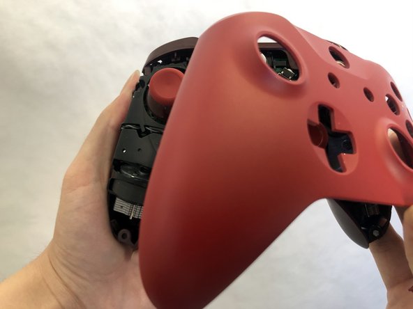

    5. Xbox One Wireless Controller Model 1708 Trigger Caps Replacement: step 5, image 1 of 3 Xbox One Wireless Controller Model 1708 Trigger Caps Replacement: step 5, image 2 of 3 Xbox One Wireless Controller Model 1708 Trigger Caps Replacement: step 5, image 3 of 3

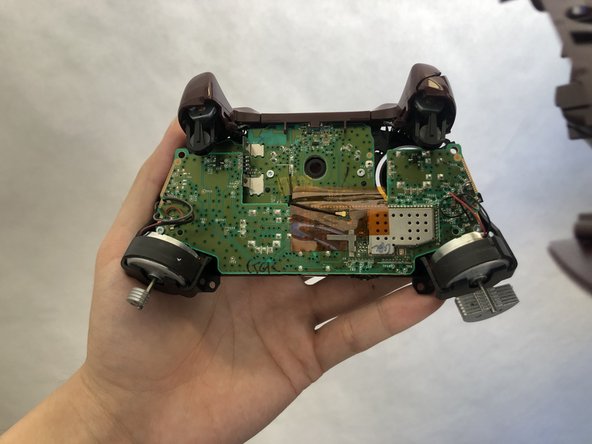

      • Carefully turn over the controller with the front plate facing you.
      • Remove the front plate.
      Ask FixBot

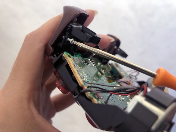

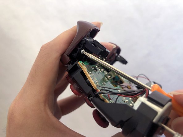

      • Remove the two 1.7mm screws from each of the triggers with a T6 Torx screwdriver.
      • It is best to do one trigger cap replacement at a time.

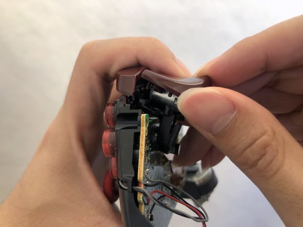

    7. Xbox One Wireless Controller Model 1708 Trigger Caps Replacement: step 7, image 1 of 3 Xbox One Wireless Controller Model 1708 Trigger Caps Replacement: step 7, image 2 of 3 Xbox One Wireless Controller Model 1708 Trigger Caps Replacement: step 7, image 3 of 3

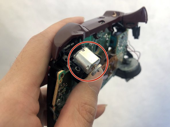

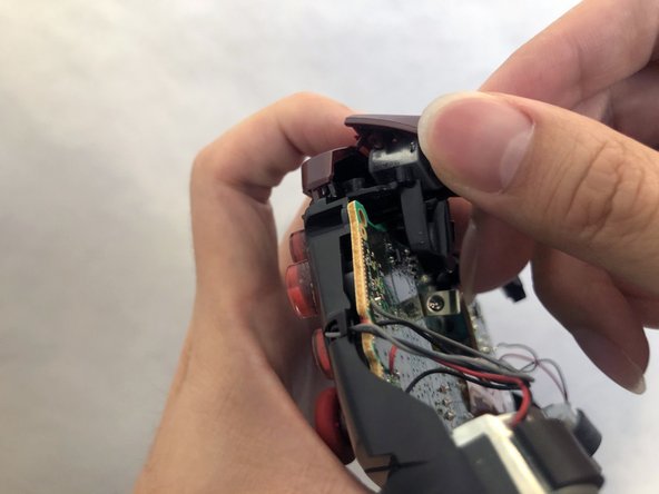

      • Be careful not to let the trigger motor inside come out.
      • Lift the trigger cap off the trigger motor.
      Ask FixBot

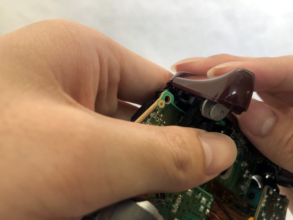

      • Place the new trigger cap on the trigger motor.
      • Push down the inside of the trigger cap until you hear a click.
      • Repeat step six to eight for the other trigger cap.
