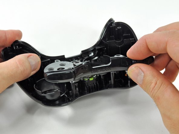

    5. Xbox 360 Wireless Controller Front Case Replacement: step 14, image 1 of 2 Xbox 360 Wireless Controller Front Case Replacement: step 14, image 2 of 2
      • Lift the D-pad backing out of its compartment on the front case.
      • The D-pad remains below the front case.
      • The D-pad will fall once its backing is removed. Be sure to support it as you remove the backing.
      • The backing is slotted to its compartment to ensure that it will always be aligned properly.
      Ask FixBot

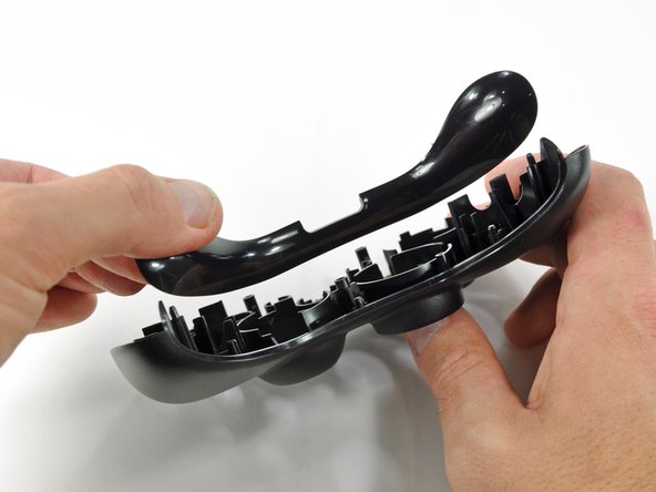

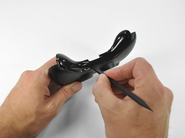

    9. Xbox 360 Wireless Controller Front Case Replacement: step 18, image 1 of 3 Xbox 360 Wireless Controller Front Case Replacement: step 18, image 2 of 3 Xbox 360 Wireless Controller Front Case Replacement: step 18, image 3 of 3
      • Insert a spudger between the lower panel and front case.
      • Slide the spudger along the gap between the two case components.
      • Lift the lower panel off of the front case.
      Ask FixBot
