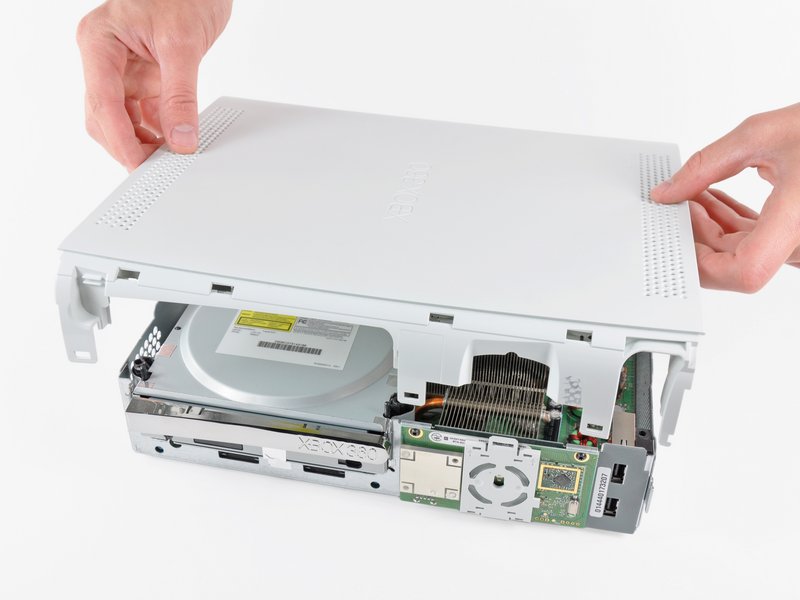

    1. Xbox 360 Upper Case Replacement, Upper Case: step 27, image 1 of 1
      • Remove the six silver 64 mm T10 Torx screws securing the upper case to the metal casing.
      Ask FixBot
    2. Xbox 360 Upper Case Replacement: step 28, image 1 of 1
      • Orient the console so that the upper case is facing upwards.
      • Lift the upper case straight up and remove it from the console.
      Ask FixBot
