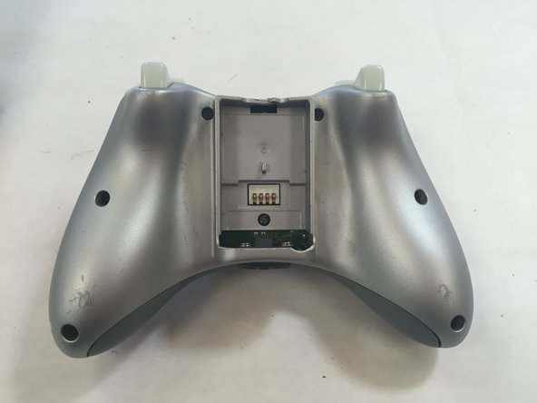

    3. Xbox 360 Controller Shell & Thumbstick Replacement, Replacing the Shell: step 3, image 1 of 2 Xbox 360 Controller Shell & Thumbstick Replacement, Replacing the Shell: step 3, image 2 of 2
      • Remove barcode sticker from back wall of battery port.
      • Remove hidden screw from location of sticker with the same TP Torx T8 Screwdriver.

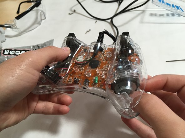

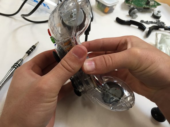

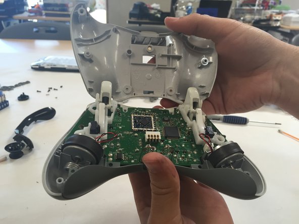

    4. Xbox 360 Controller Shell & Thumbstick Replacement, Replacing the Shell: step 4, image 1 of 2 Xbox 360 Controller Shell & Thumbstick Replacement, Replacing the Shell: step 4, image 2 of 2
      • Pry open the controller. Optionally, gently push in the thumbstick to eject the back half. (Some buttons may fall out.)
      • This will leave you with 2 separate pieces. Disconnect rumble motors, using fingers on sides of connectors.

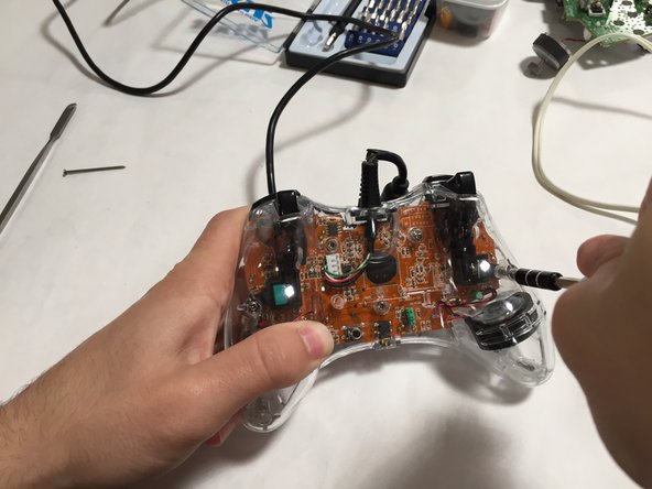

    6. Xbox 360 Controller Shell & Thumbstick Replacement, Replacing the Shell: step 6, image 1 of 2 Xbox 360 Controller Shell & Thumbstick Replacement, Replacing the Shell: step 6, image 2 of 2
      • Remove all mesh and buttons from controller, as well as the motherboard.
      • Remember to keep small parts in a safe place to prevent the loss of a part.
      • Later photo will clarify which button goes in which hole.

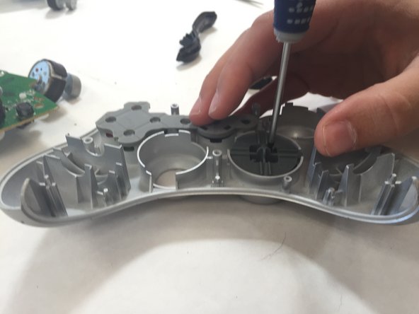

    7. Xbox 360 Controller Shell & Thumbstick Replacement, Replacing the Shell: step 7, image 1 of 2 Xbox 360 Controller Shell & Thumbstick Replacement, Replacing the Shell: step 7, image 2 of 2
      • To remove arrow keys, locate the screws hidden within the key.
      • Using 1.5 crosshead screwdriver, remove these screws and "store them in a safe place."

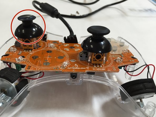

    13. Xbox 360 Controller Shell & Thumbstick Replacement, Replacing Thumbstick: step 13, image 1 of 3 Xbox 360 Controller Shell & Thumbstick Replacement, Replacing Thumbstick: step 13, image 2 of 3 Xbox 360 Controller Shell & Thumbstick Replacement, Replacing Thumbstick: step 13, image 3 of 3
      • Complete steps 1-4 on the controller with the faulty thumbstick.
      Ask FixBot
    14. Xbox 360 Controller Shell & Thumbstick Replacement, Replacing Thumbstick: step 14, image 1 of 3 Xbox 360 Controller Shell & Thumbstick Replacement, Replacing Thumbstick: step 14, image 2 of 3 Xbox 360 Controller Shell & Thumbstick Replacement, Replacing Thumbstick: step 14, image 3 of 3
      • To remove thumbstick, pull the thumbstick vertically off of its base.
      • Place the new thumbstick onto its base, pushing it down as far as possible without breaking the base.
      • If you have purchased the wrong style of thumbstick, superglue, hot glue, or any other adhesive should work fine. Simply use a needle to put some adhesive and/or glue into the hole.
