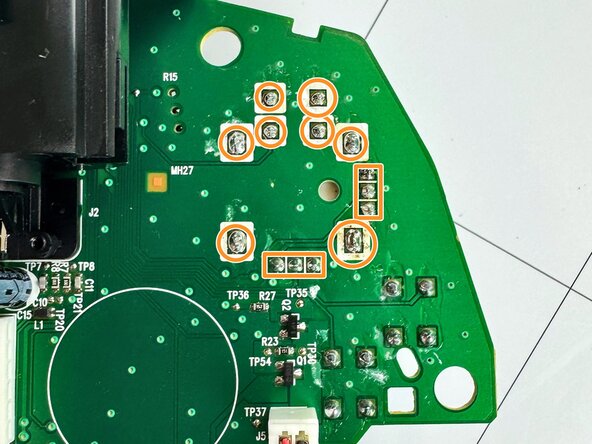

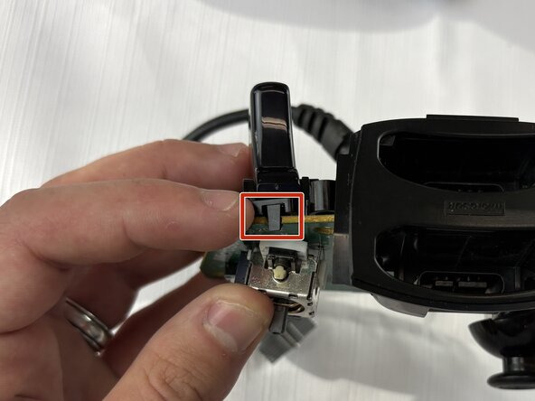

    1. XBOX Controller S Joystick Replacement, Joystick: step 3, image 1 of 3 XBOX Controller S Joystick Replacement, Joystick: step 3, image 2 of 3 XBOX Controller S Joystick Replacement, Joystick: step 3, image 3 of 3
      • Remove the motherboard from the back shell.
      • You will need to remove the trigger when replacing the left joystick.
      • Desolder the three points to the right of the joystick on the top of the motherboard.
      • Pry the trigger clip away from the top, then lever it downward to remove the trigger.
      • Replacing the right joystick will not require removing the trigger assembly.
      Ask FixBot
    2. XBOX Controller S Joystick Replacement: step 4, image 1 of 1
      • Desolder the 14 solder pads to remove the joystick completely.
      • Take your time and remove the solder pads one at a time.
      • If one of the pads is difficult to desolder, move on to the next one and come back when you're done—this gives it time to cool and prevents damage to the board.

    5. XBOX Controller S Joystick Replacement: step 7, image 1 of 2 XBOX Controller S Joystick Replacement: step 7, image 2 of 2
      • Reinstall the trigger assembly by snapping it back into place.
      • Then fill in the three solder pads.
      Ask FixBot
