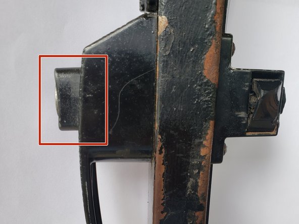

    • First, open and then position the door to a desired width.
    • Secure the door by using the sliding latch of the cylinder or door prop.
    • This will enable the door to stay open while replacing the handle.
    • Use a screwdriver to begin removing the screws from the handle.
    • The type of screwdriver to use will depend on the type of screws. A Philip screwdriver is being used to remove the screws from the security door.
