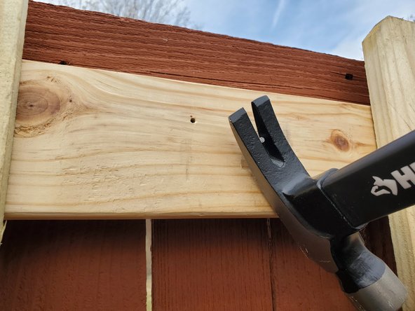

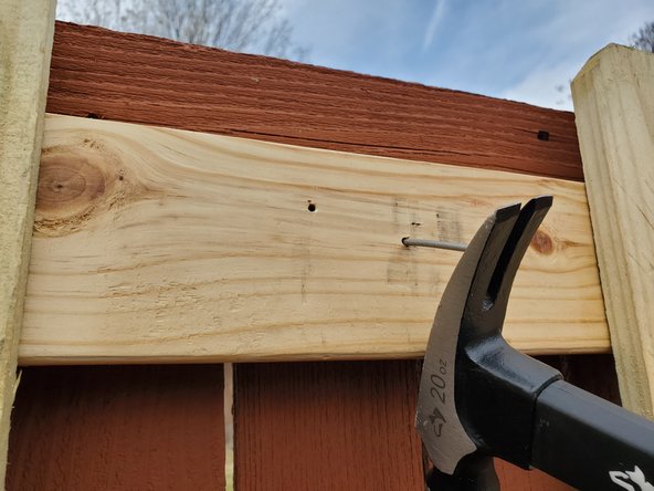

  3. Wooden Fence Picket Replacement: step 3, image 1 of 3 Wooden Fence Picket Replacement: step 3, image 2 of 3 Wooden Fence Picket Replacement: step 3, image 3 of 3
    • Only complete this step if there are still nails in the wood after you have removed the picket. If all nails are removed, continue to Step 4.
    • Slide the claw of the hammer underneath the nail.
    • The claw is the forked area of the hammer. This is commonly used to aid in the removal of nails.
    • While holding the handle, pull on the hammer to remove the nail.

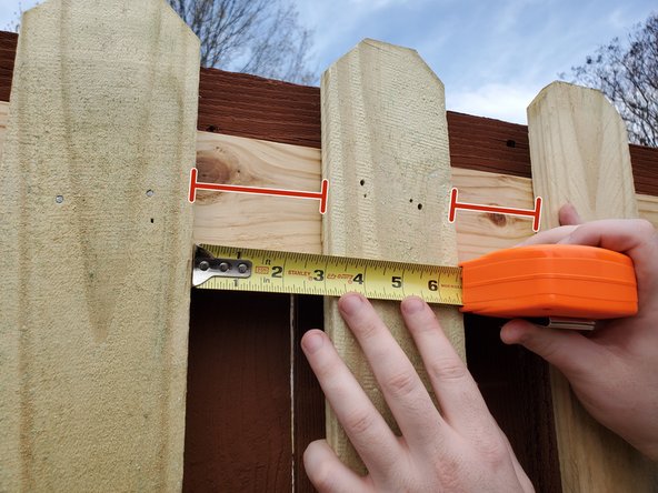

  4. Wooden Fence Picket Replacement: step 4, image 1 of 3 Wooden Fence Picket Replacement: step 4, image 2 of 3 Wooden Fence Picket Replacement: step 4, image 3 of 3
    • Before installing the new picket, clear the area of any debris.
    • Obstructions may cause the picket to be crooked when installing, or make a gap too large for the nails to work properly.
    • Use the tape measure to measure the gaps between the left and right side of the picket.
    • Doing this allows the replacement picket to be centered directly between the other pickets.

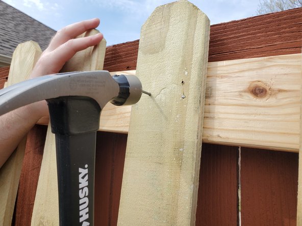

  5. Wooden Fence Picket Replacement: step 5, image 1 of 3 Wooden Fence Picket Replacement: step 5, image 2 of 3 Wooden Fence Picket Replacement: step 5, image 3 of 3
    • Caution: This step involves hitting nails with a hammer in close proximity to your fingers. Work gloves are recommended if you are unfamiliar with using a hammer.
    • Hold a wood nail approximately 1 inch from the side of the picket.
    • You may place the first nail 1 inch away from either the left or right side of the picket. Each section uses 2 nails so it does not matter which side you choose to work on first.
    • Lightly tap on the wood nail with the hammer to begin pushing the nail into the picket. Continue until the nail is fully in the picket.
    • Repeat until there are 2 nails inserted in the picket at every cross section.
